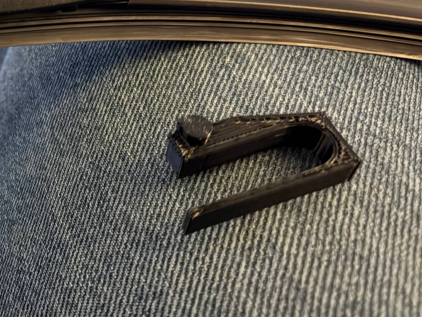

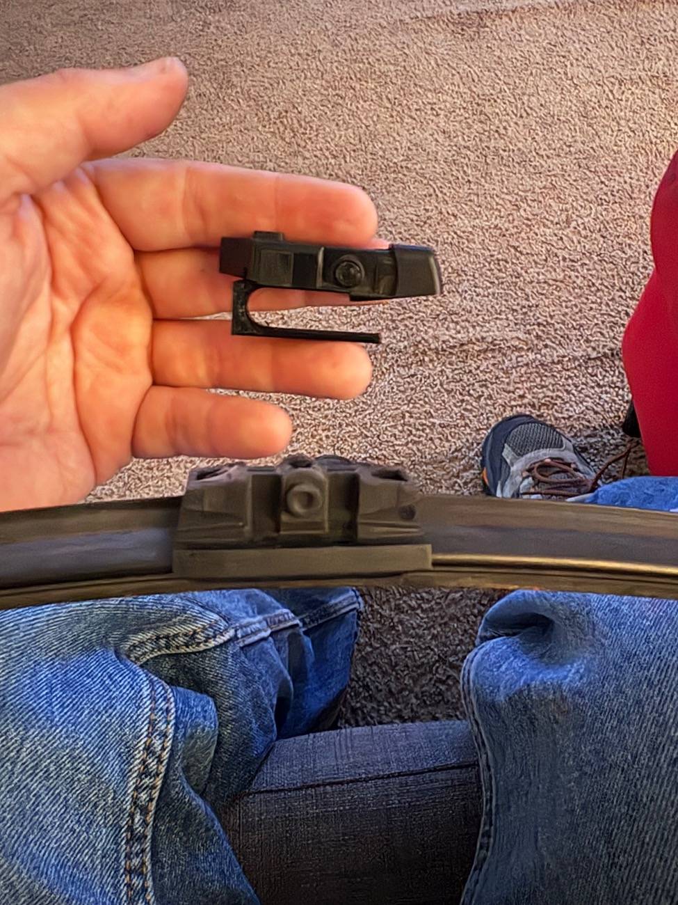

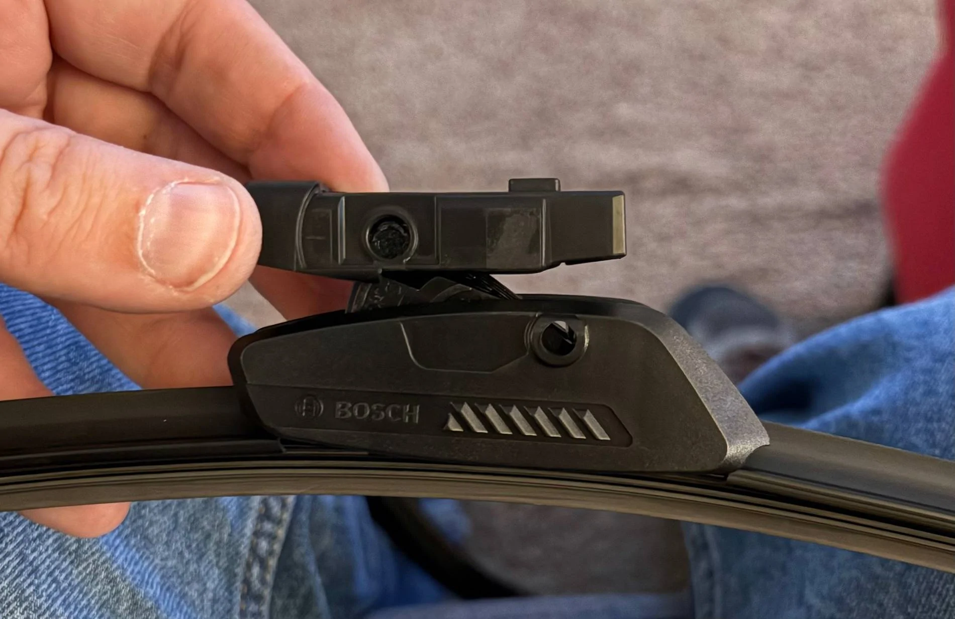

I came here last night looking to see what the solution to this was after buying my go-to wiper blade replacements and discovering that the Maverick didn't use the J Hook. At that point was after hours at the store I bought them from, and I didn't want to wait on shipping for other blades, so I took a couple hours and designed an adapter that uses the pinch tab connector on the stock blades and converts it to the J Hook connector. Spent an hour today with my wipers running on high to test the durability, and am happy with how it was working. This is printed in PETG, and should hold up to both the heat and cold pretty well. I'd be happy to provide a link to the file and my Etsy shop where I sell little things like this that I design for myself and others might find useful too.
Ford Maverick Wiper Blade Specs IMG_0055
Ford Maverick Wiper Blade Specs IMG_0056
Ford Maverick Wiper Blade Specs IMG_0057
