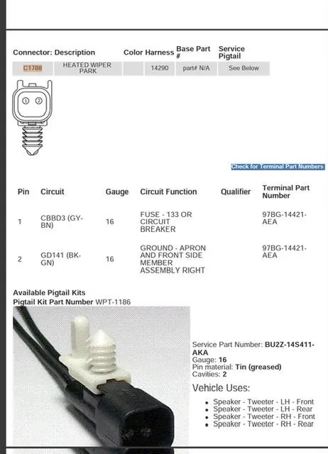

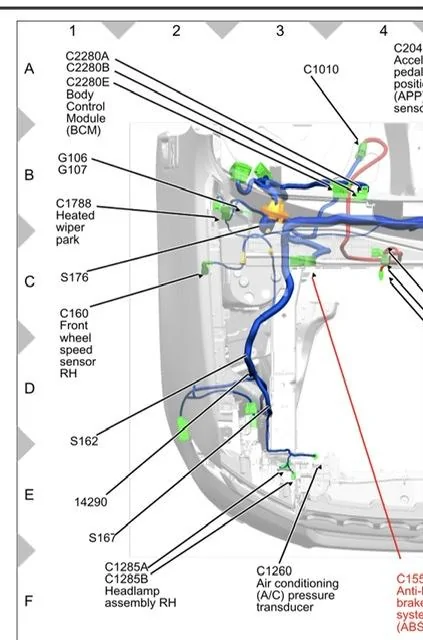

Heated Wiper Park
Fuse 133. 15A
Connector: C1788
Appears to be on passenger side.

Heated Wiper Park
Fuse 133. 15A
Connector: C1788
Great- Info- Thanks ! Sending over to Dealer -

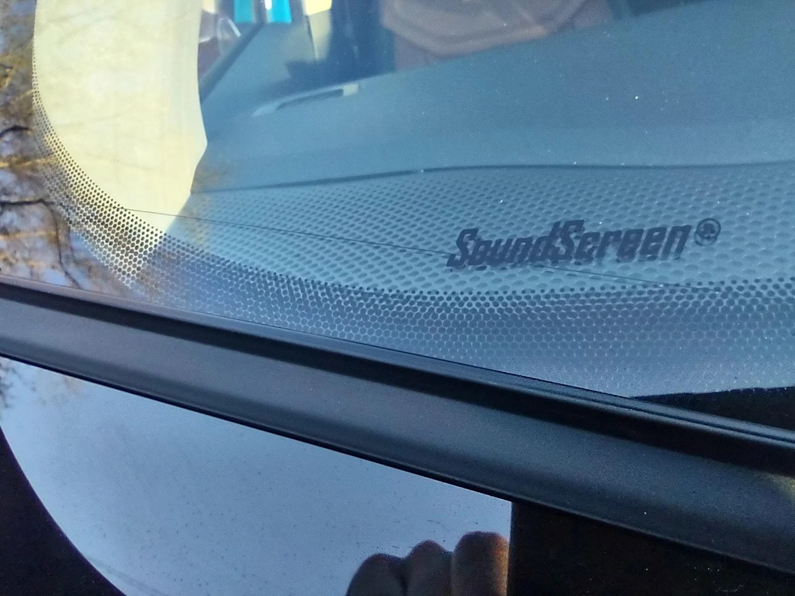

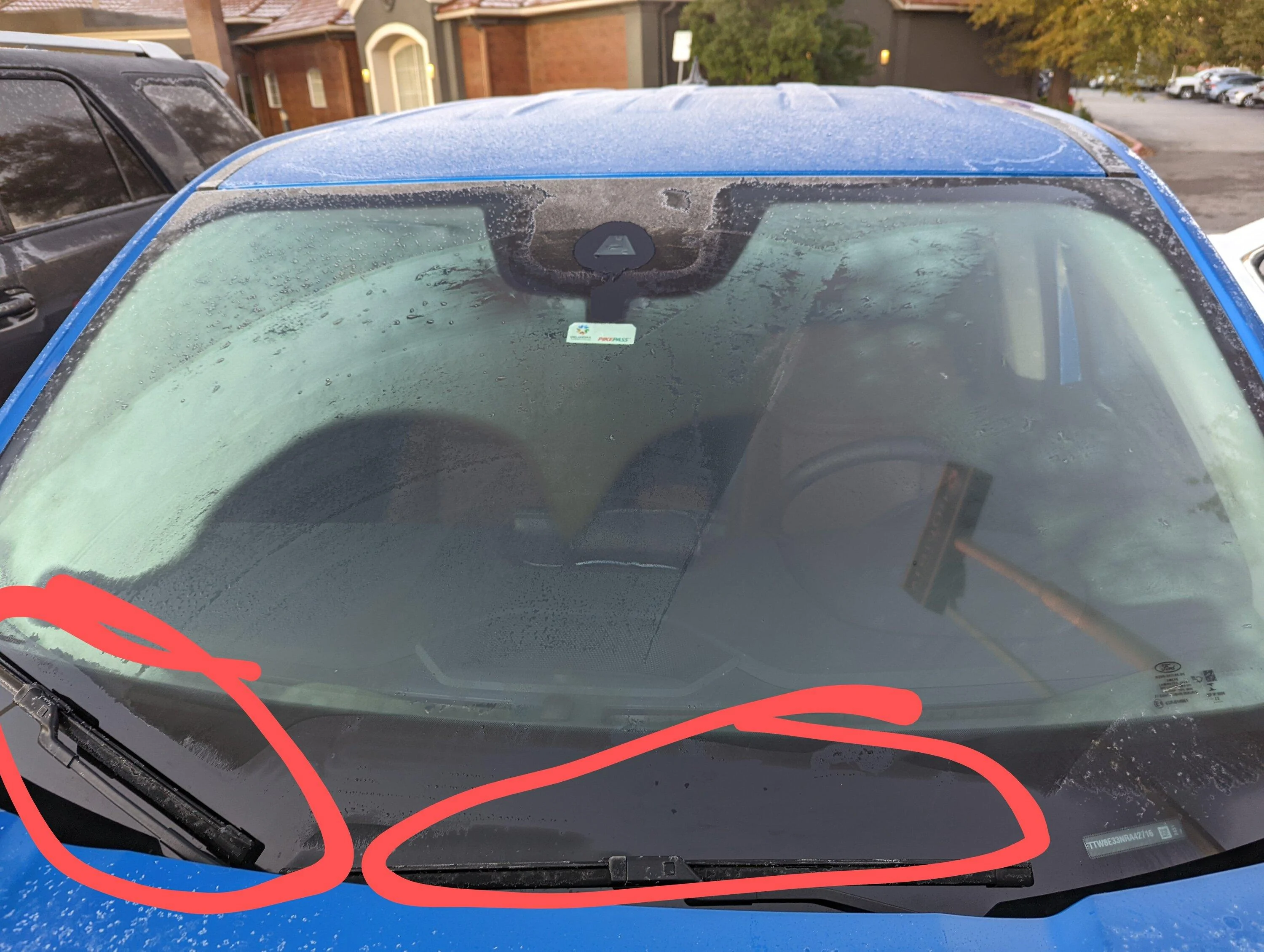

There is a single defrost line that runs across each side of the acoustic windshield where the wipers park. I didn't think mine was working after Safelite replaced my windshield(rock crack) as I could feel no heat there and the temperature gun didn't sense anything either.
But once winter came and my windshield actually froze up a bit I could see that it worked.
I see that thin line but hard to believe that can replace what used to be a robust grid of built in heating elements that most folks are used to.
