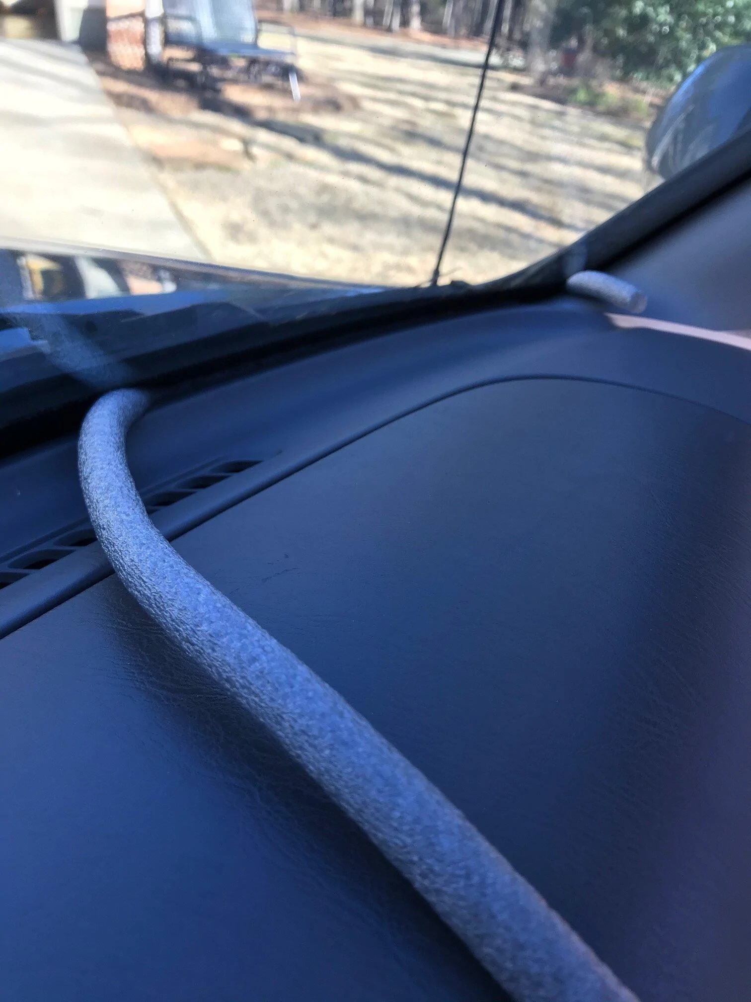

abcinv
Tommy
Aug 17, 2021
256
272
NW Georgia
'22 Maverick Hybrid XLT / '06 Tundra dbl cab 4x4 Limited
This was a fix for my 1st Gen Tundra (and a lot of other folks too). It was a dash rattle where the windshield and the dash meet. Backer Rod from HD or Lowes; $4 for 20ft. Just tucked it in and the rattle was 99% gone.
Ford Maverick Windshield Squeak Fix? Dash rattle 1
I don't have the rattle at the moment in my Maverick and haven't looked at the dash / windshield area but thought I would throw this out there, it may be helpful.
