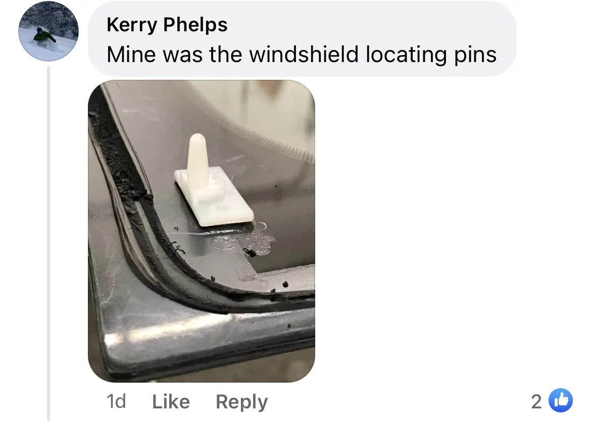

Has anyone pulled the wiper cowl to inspect? I had this same issue on my 4th gen Ram. Turns out there's plastic clips below the bottom of the windshield that are glued in place from the factory. These were initially used to help hold the windshield in place. They are not needed afterwards. Once I removed these on my Ram, the cold creaks were gone. I'm speculating the Maverick also has them, as it sounds identical. I don't think it will be easy to get these? I also hate removing panels on a new vehicle -- as they sometimes do not go back on perfectly, and one could cause more rattles or leaks. I've had this issue since new (truck is < 2 months old).

Took a little bit to find on Facebook, but someone did find location pins stuck on the windshield of their maverick and their noise was fixed after removing them

^ Thanks! I'll have to check that out. Crap -- looks like you'd have to pull the windshield to remove them?
