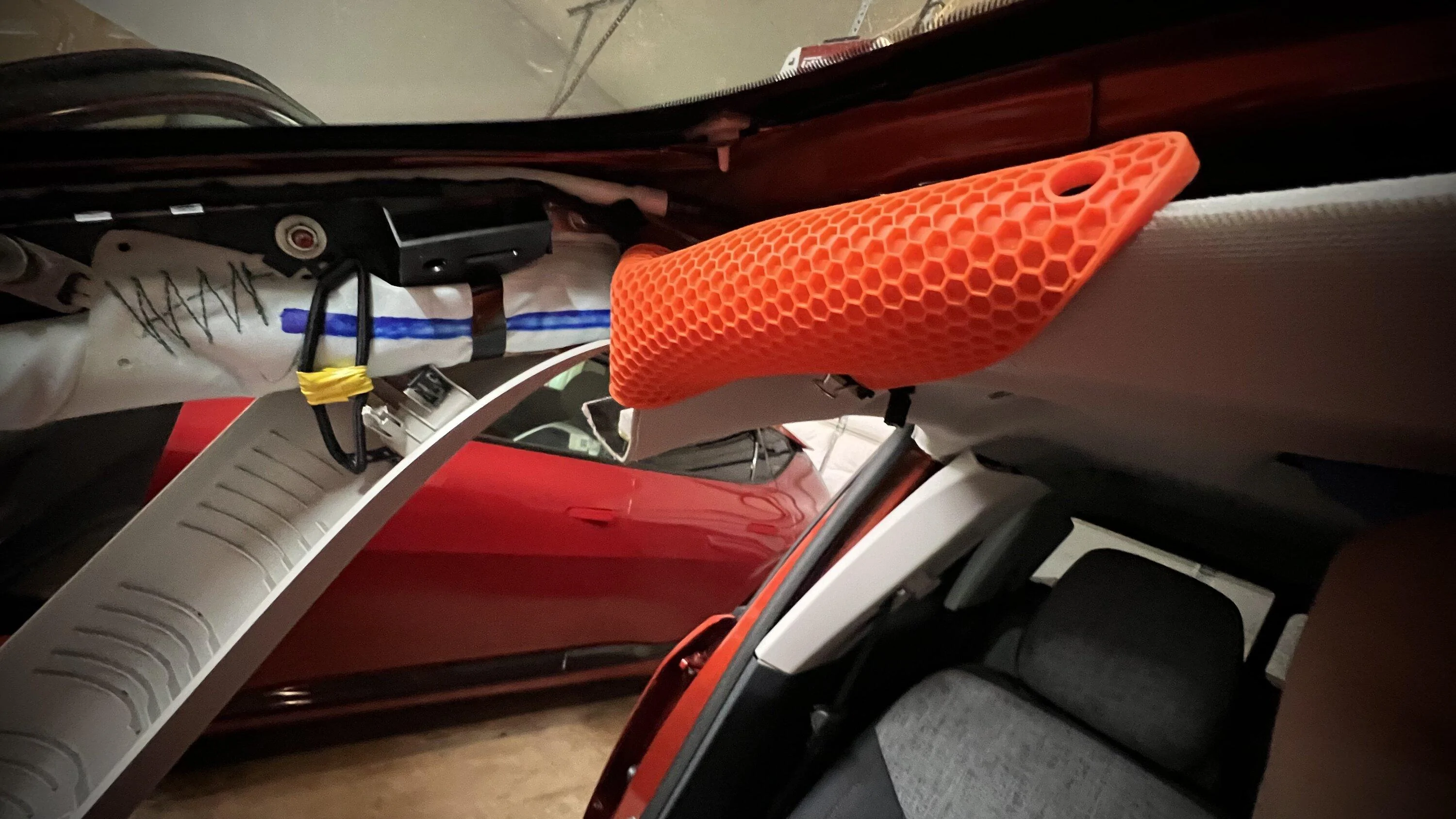

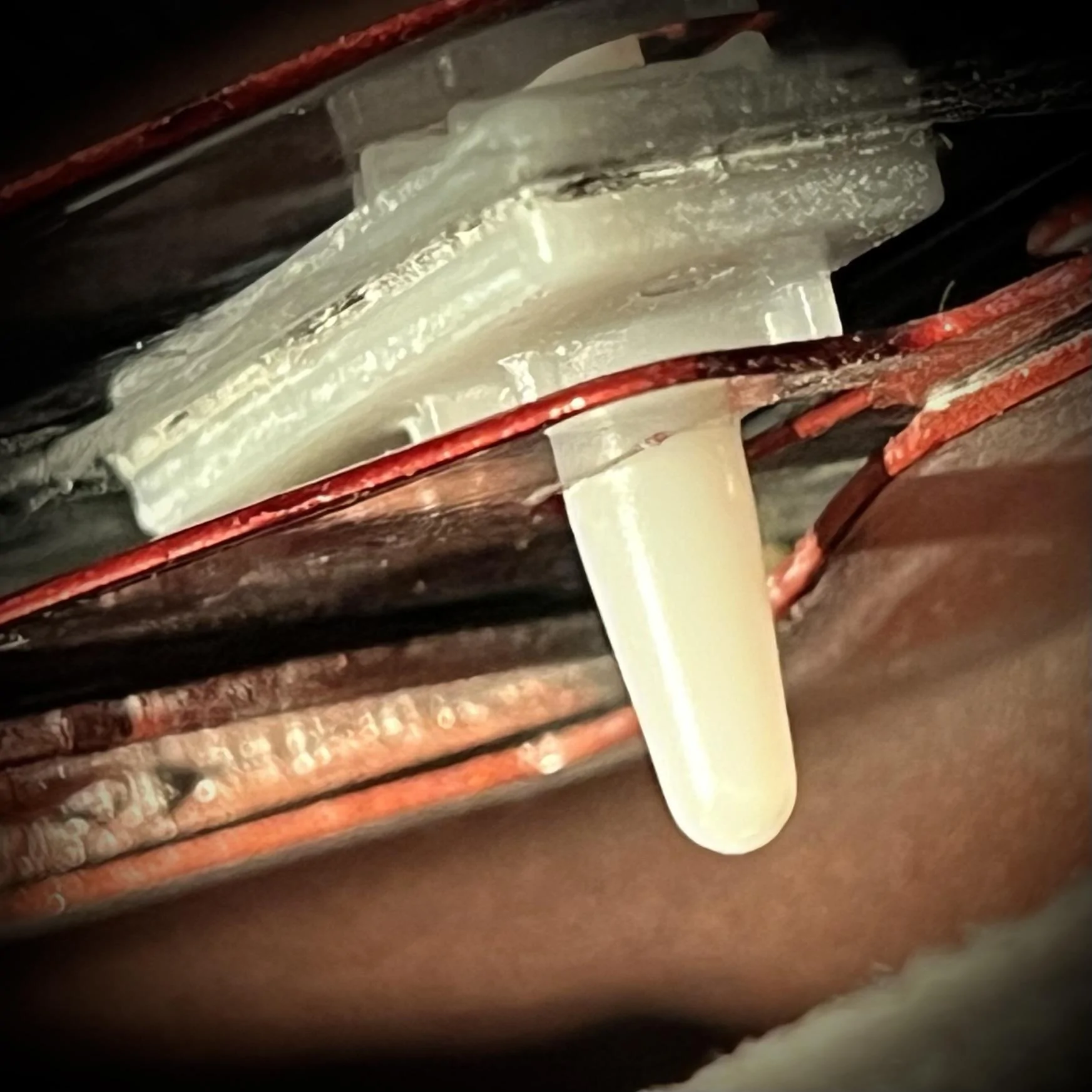

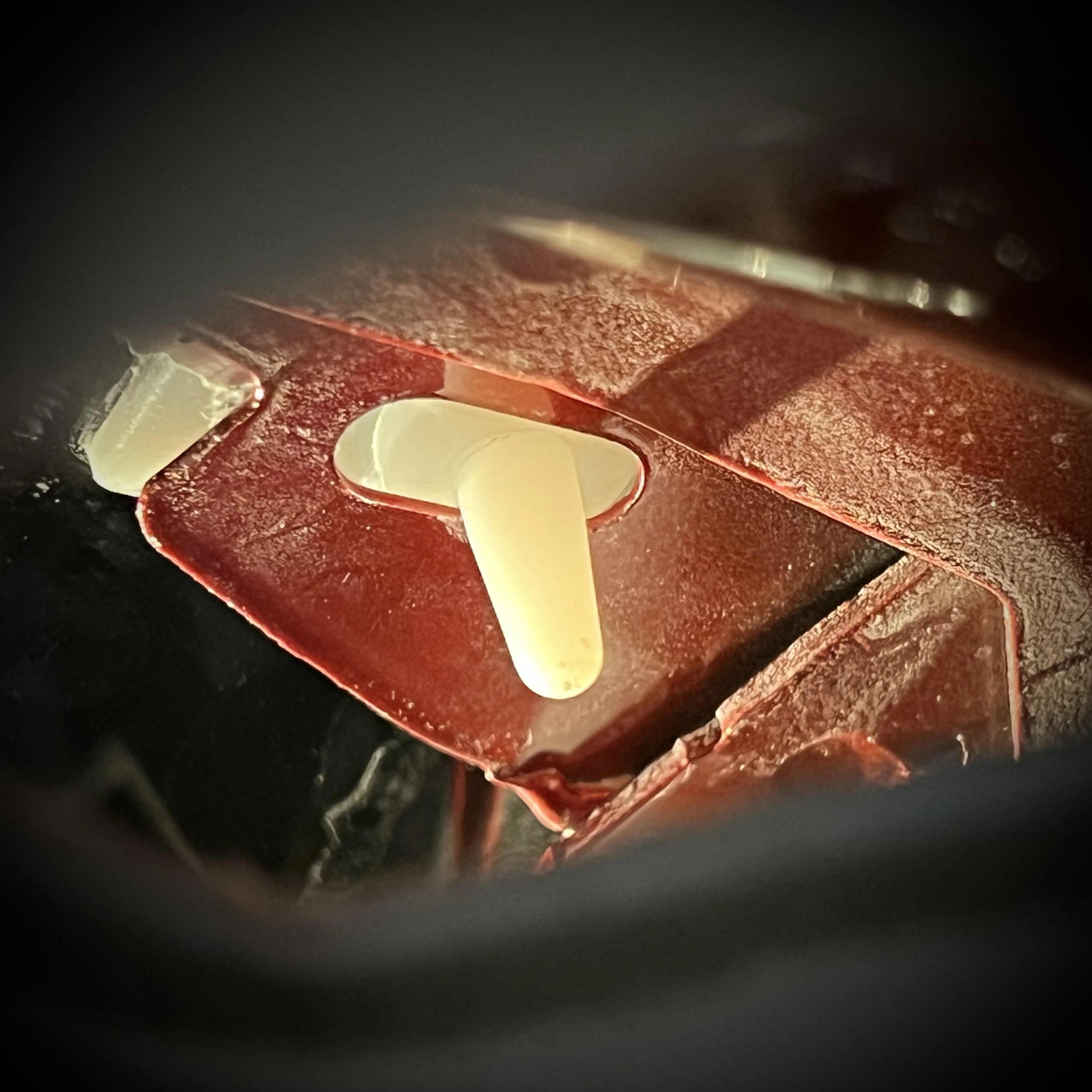

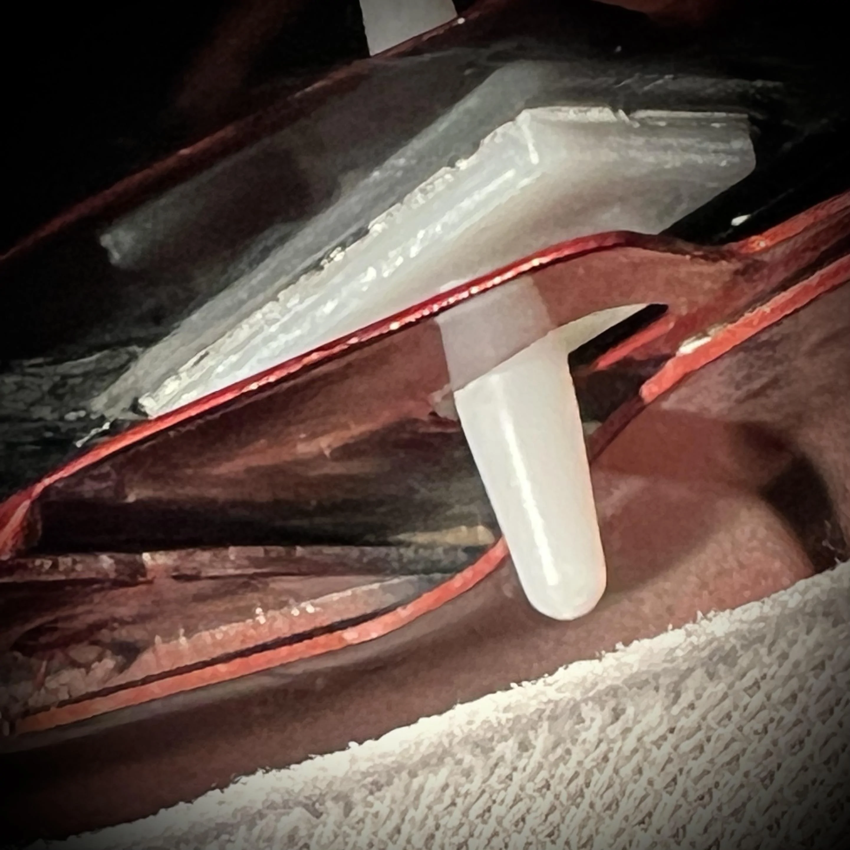

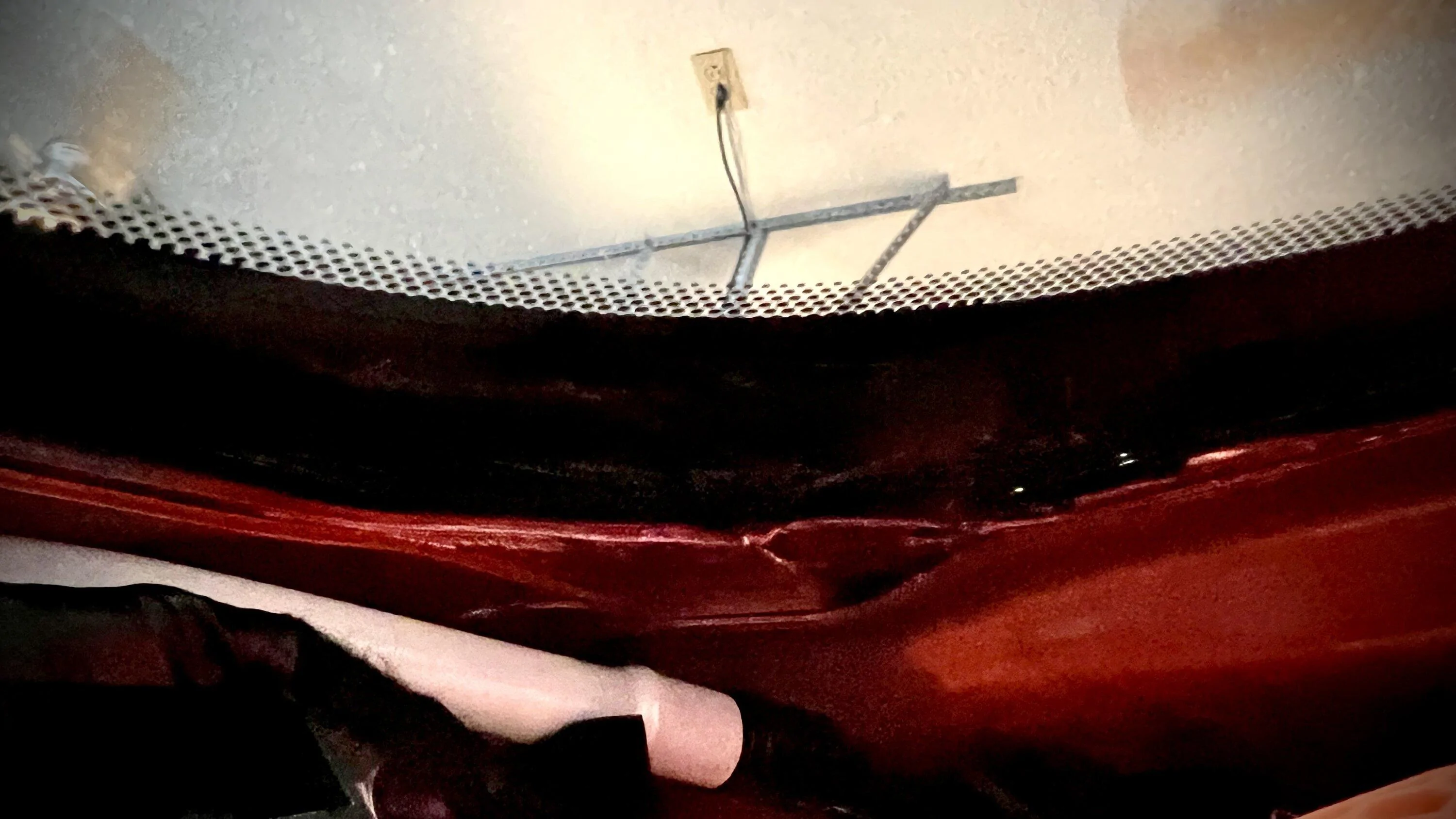

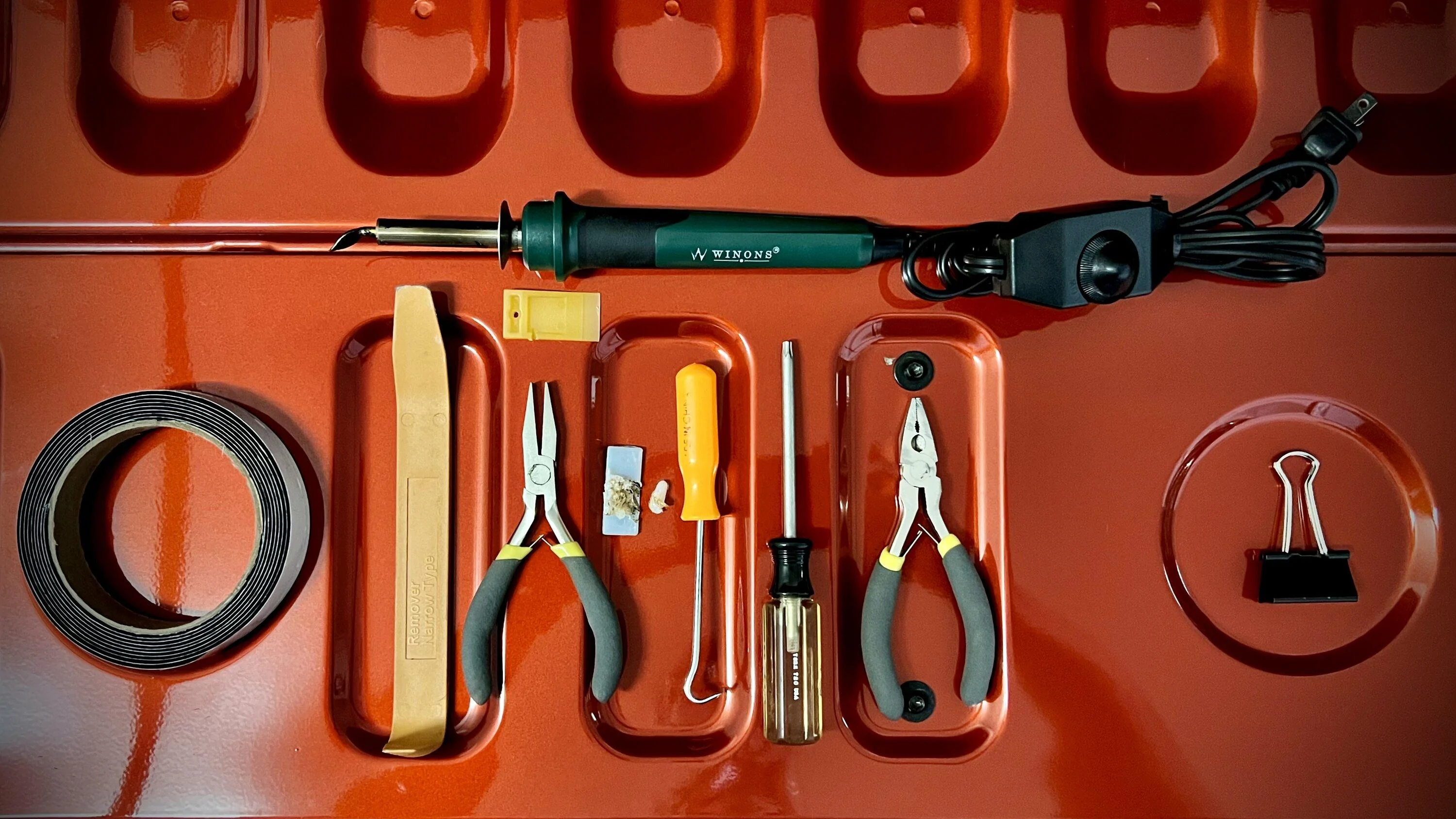

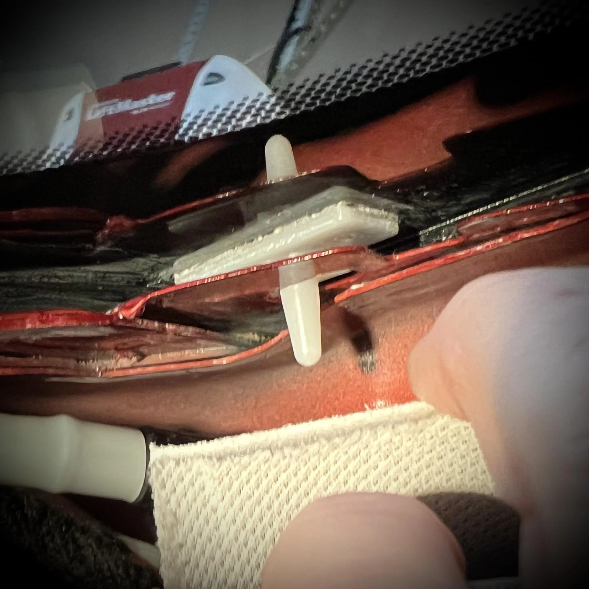

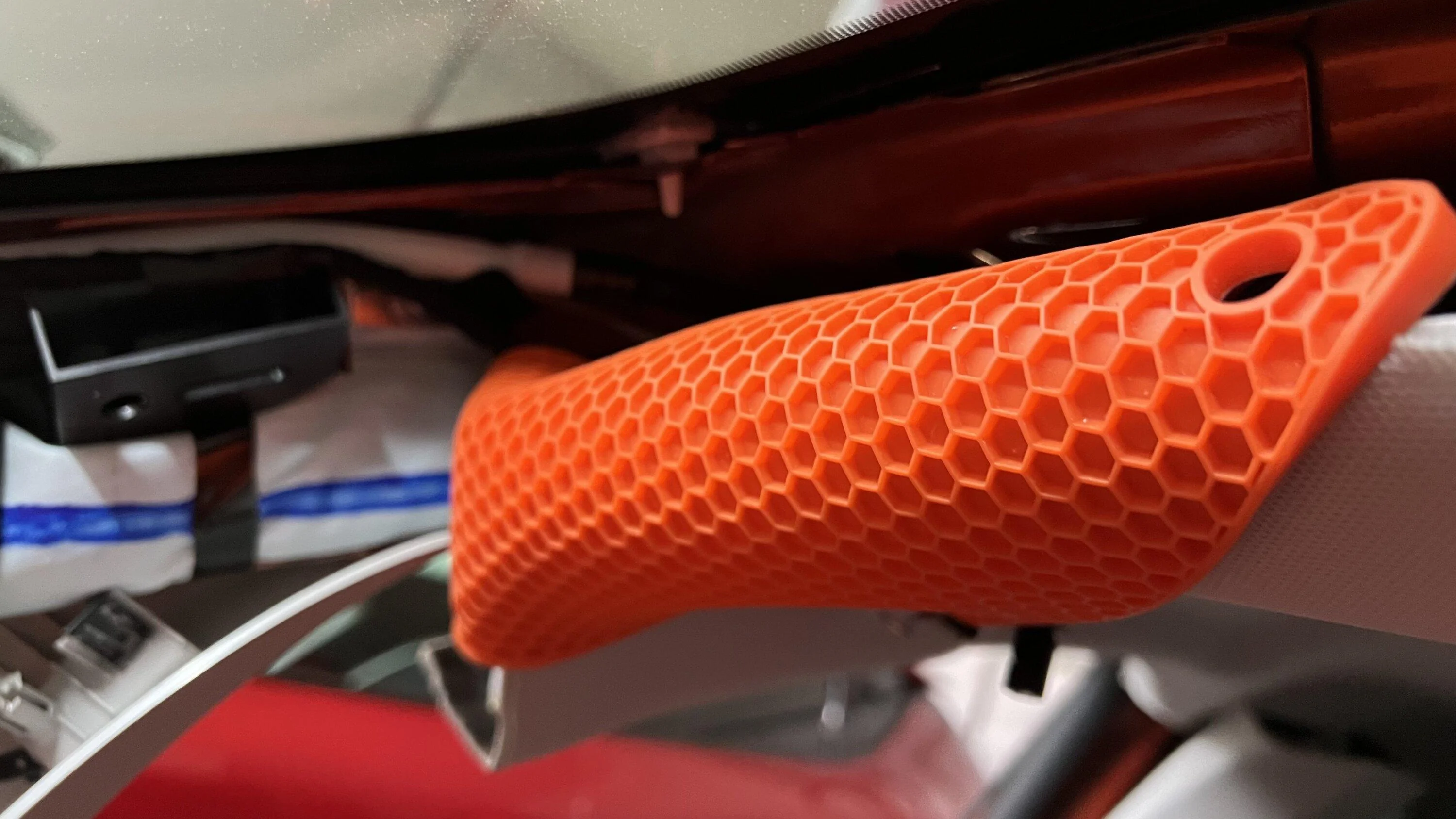

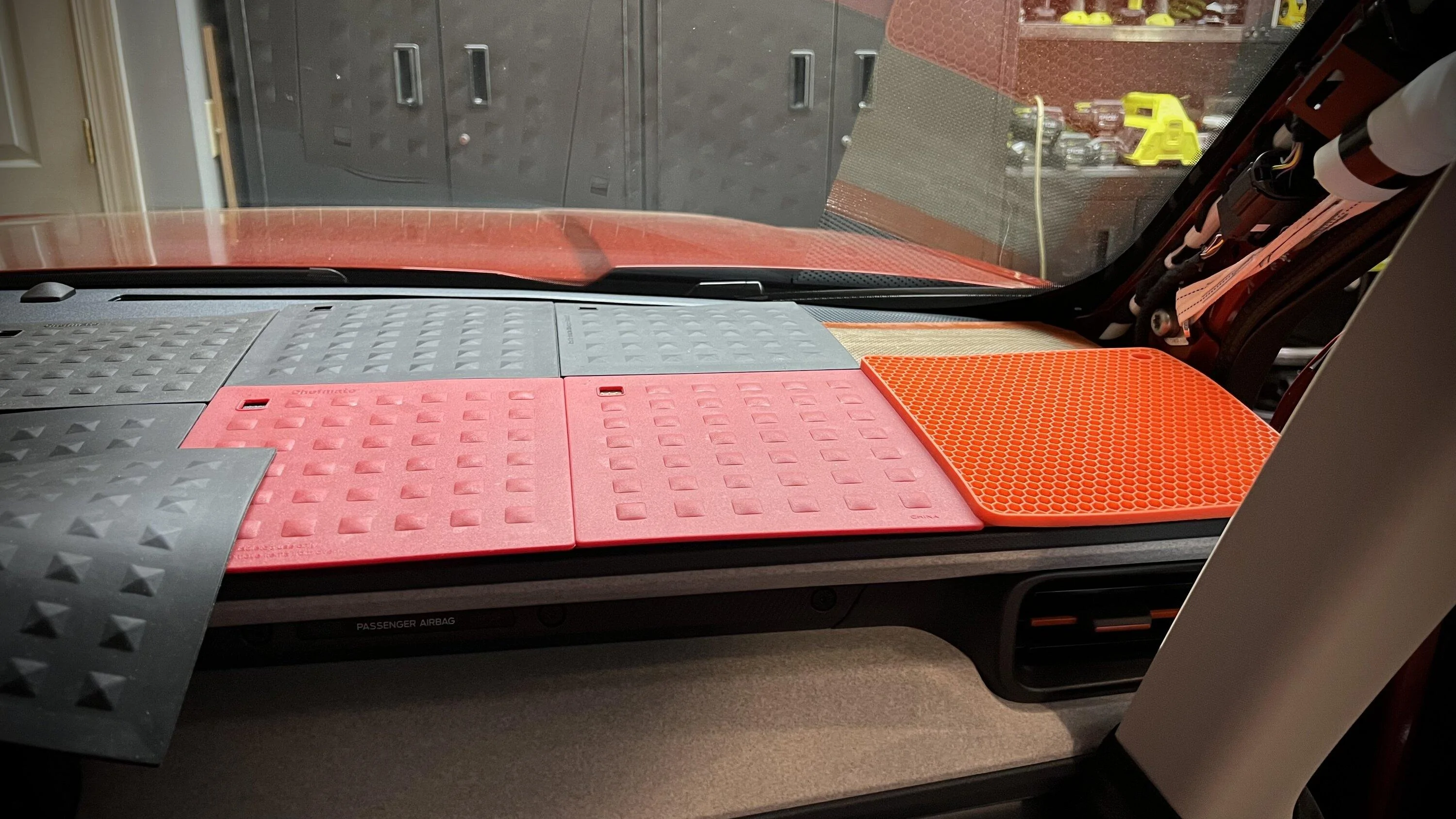

I felt more comfortable melting the short pin off. I used an automotive panel removal tool to separate the glued base from the windshield. Other assorted tools as needed. Heavy use of silicone pads everywhere…the iron gets super hot.

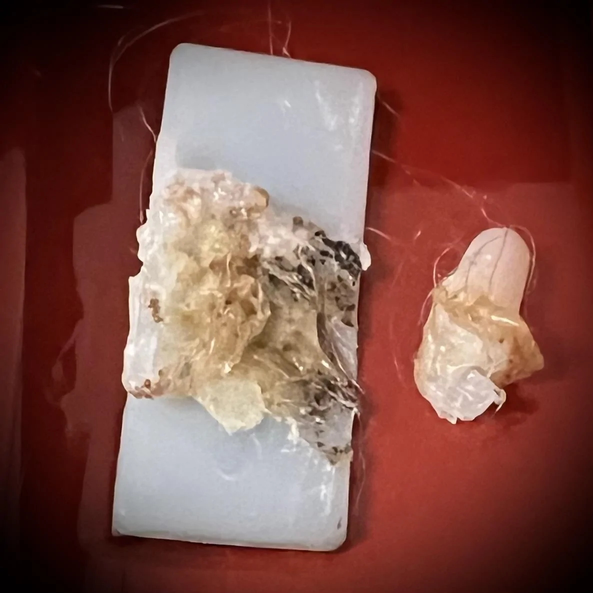

Added for context…

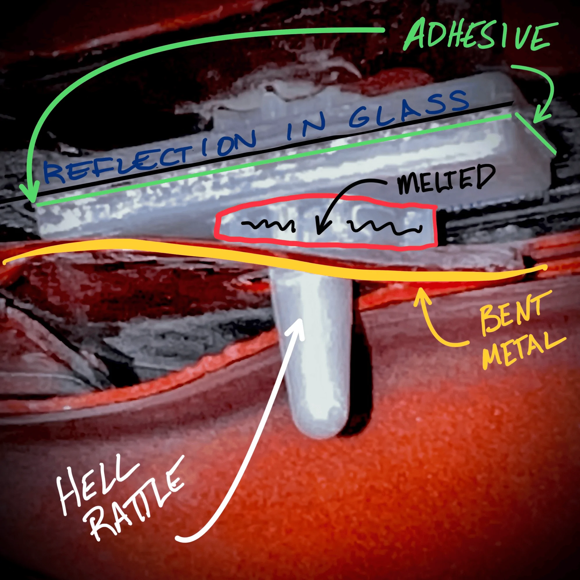

So you melted it first, in order to loosen the glue from the windshield? Then the whole thing popped off?

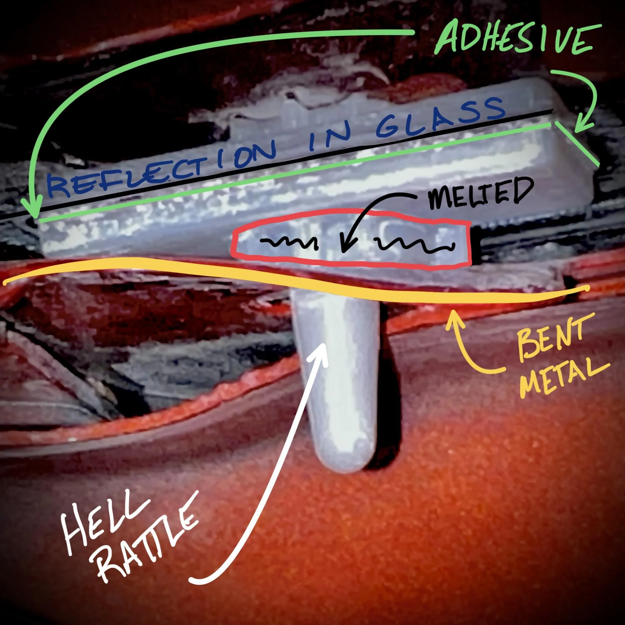

Melted the pin off between the metal and plastic base. (The metal pin locator is easy to bend downwards if more space needed.) Plastic base was separated from glass using automotive pry tool. Pulled the base out with small hook tool. Veery, very, very carefully.
It’s risky…so any efforts made are an individual’s owndecision.
I’m happy with my results, and thought it a less risky method than a saw blade, nor did I want the windshield pulled/replaced.
