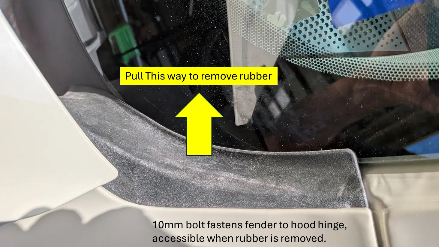

An update - the alignment is fixed. It turns out, the hood was aligned but the fender was not. The hood hinge fastens to the body with two 13mm bolts which are accessible with the door open. However, the fender well is also bolted to the hinge with a 10mm bolt which is underneath the rubber trim at the hood corner by the windshield. I discovered this when I loosened the hinge bolts to lift the hood and found that the fender moved up with it. Once I removed the rubber trim and discovered the 3rd bolt, I tightened down the 13mm bolts to the body again, loosened the 10mm bolt holding the fender to the hinge, and simply pushed the fender down and re-tightened the bolt. So, to make a long story short, simply remove the rubber trim to access the 10mm bolt fastening the fender to the hinge, push down on the fender, tighten the bolt and push the rubber trim back in place. Easy peasy.

Nice - I was literally going to jokingly post about moving the fenders instead - but I sure thought it would have more connections than 1 bolt back there from that prior pic.
