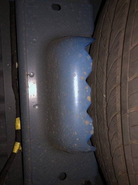

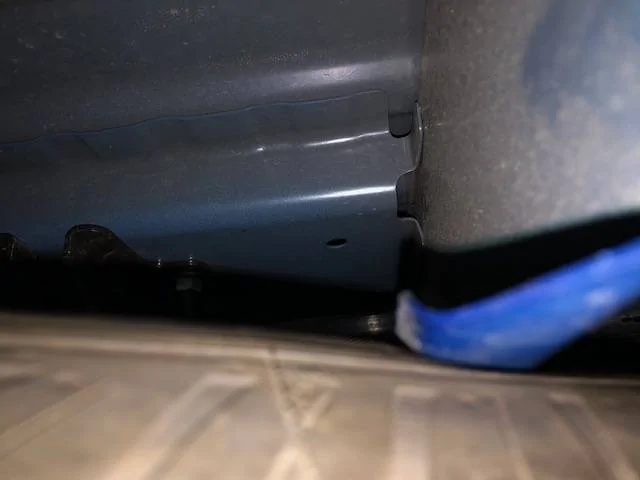

I was concerned about using one of my steelie rims with the stock size (225/65r17) fitting in the spare tire location. I bought aftermarket rims on my truck and wanted to use one of the take offs as as a full size tire to replace the tiny compact spare. It does fit my 2023 just fine. No modifications needed. It is a little snug but all the safety features are still intact.

That is pretty snug- The steelie should be wide enough for a 225/235 ?- kinda hoping a somewhat worm 245 could fit but without cutting into the sharks teeth- Not sure how much of an issue a 225 spare would cause if the running 3 tires are 245's - We do tow a trailer so not wanting to cause further issues if we need to break out the spare.

RE: purpose of teeth = they are part of the rear end collision system to deflate the spare in a controlled way to absorb the impact rather than transmit it forward. I wouldn't mess with it. Saving your spare tire will be the least of your problems in a heavy rear ender. Your truck will be totalled anyway.

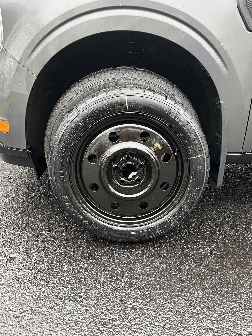

The XLs run 225s so if it is a stock steelie that will fit fine.

Is the stock steelie that comes as a *Full" size spare the same as what comes as the running gear on the XL ?
"Probably." I can't confirm for sure what the full size spare rim is because I wasn't lucky enough to receive one - but I suspect that it is a 17x7 just like the OE XL wheels.

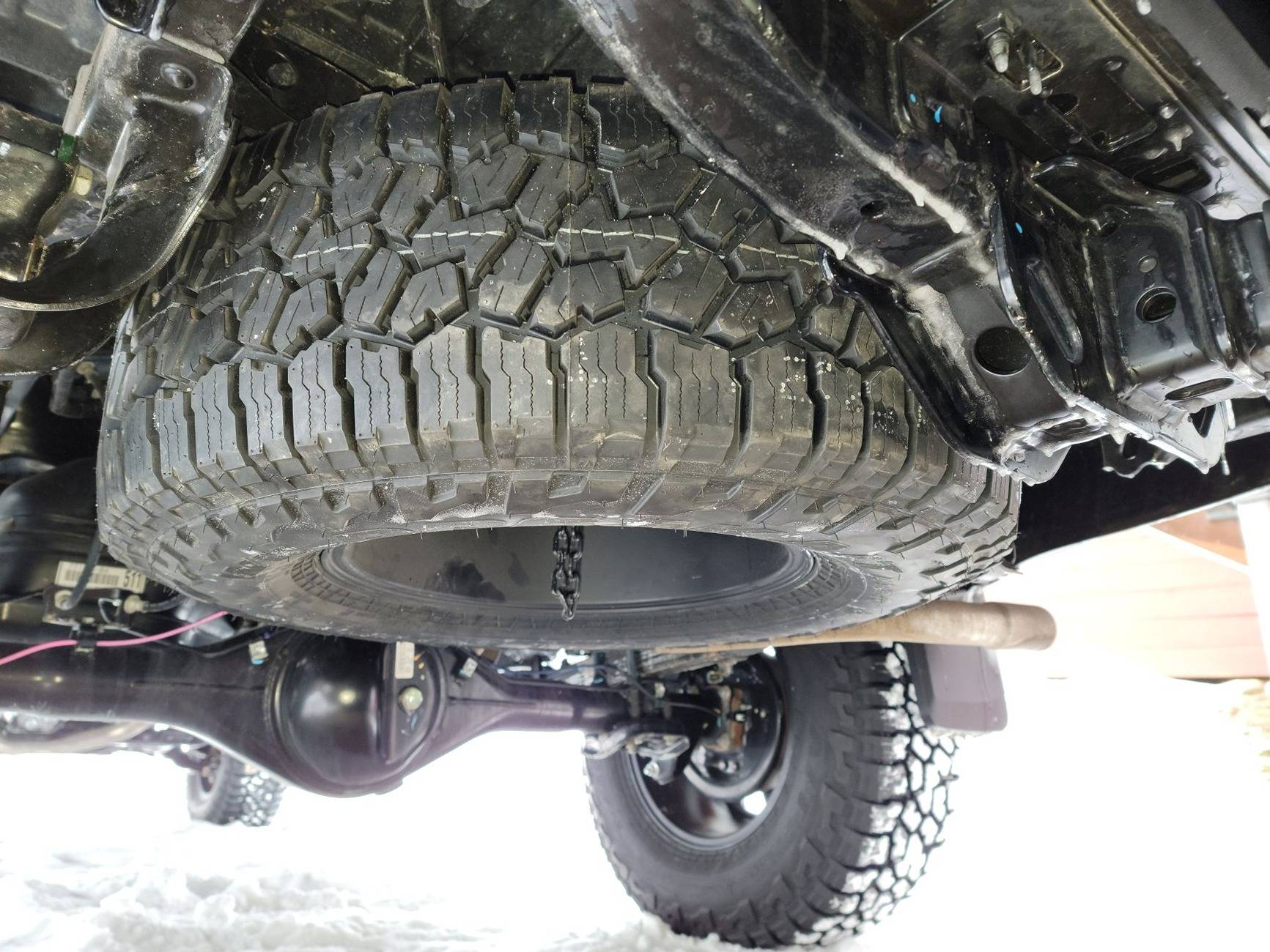

Yea I went from this
Ford Maverick Will standard full size tire fit in spare tire location? 007
285/70R17 fitting under a Tacoma
To this:
Ford Maverick Will standard full size tire fit in spare tire location? 2EECD662-26DA-450C-85AD-EB318652114A
(not my pic, could be better but you get the point)
To this:
If folks ever go somewhere where there's pizza but no pizza cutter...there it is. Right under their truck.
