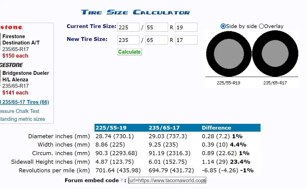

literally the one option, on the tire rack. it's a pretty good tire, but I would go to 17s.
That is my intention. Sell my 19" wheels and tires to fund a lightweight 17" wheel for 235 AT tire.
Might end up having my maverick on blocks because I want to sell them to fund the purchase of the others!

100% agree on the suggestion to go to 17s. Your tire options open up immensely, plus you'll have more sidewall. What's the point of all terrains on 19s if they're as thin as rubber bands? 😄
