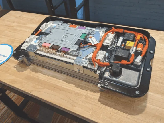

PHEV/BEV are trying to package a lot more power so space efficiency starts to become a concern. 1.1kWh isn't that much and even then only about 75% of the pack (about the size of a large suitcase) is the cell array itself.
Right, I just hadn't seen it mentioned that they use different battery cells. Assumed they were the same. Whoops. :)
Makes sense, anyway. An Escape FHEV uses the same 1.1 kWh pack as a Maverick. Escape PHEV gets 14.4 kWh and it's not 13x the size. Plus, FHEV batteries are constantly charged and discharged throughout each drive.

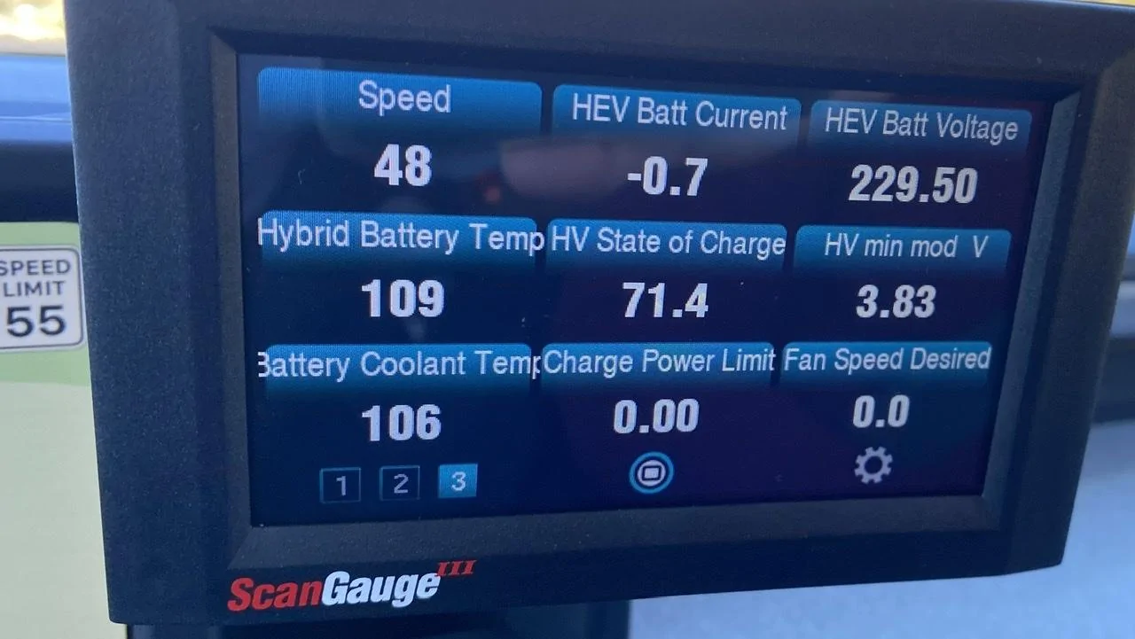

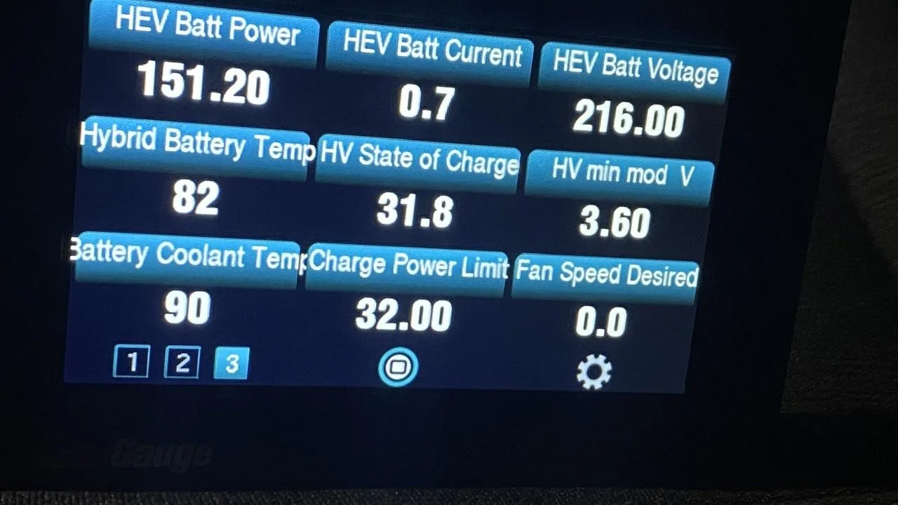

That label is misleading.
I've come to understand it is a common boiler plate label and not specific to any particular make or model. But if you say "Hey, this could contain up to 450 volts" you covered your ass when the real voltage is about 220 VDC.
The nominal, resting voltage of the Maverick HV battery pack is 220 volts.
Charging vigorously it may reach 240 volts. You're going to get a check engine light and maybe a system shut down if it ever exceeds 265 volts. During heavy drain like heavy acceleration it may drop to 190 volts.
That's confirmed for the battery.
The traction motor and starter are AC motors. So your Mav has two very large "alternators" in fact. So there are inverters and transformers and rectifiers and all that. Seems crazy I know, but turns out, AC motors are much easier to control, are lighter, stronger, and more efficient and have fewer "wear" surfaces than DC motors.
So while the battery is 220 volts. It is possible the "alternators" could generate up to 450 volts AC before all the conversions and transformations but I've only had mine a month and have not read up on the motors yet. But I will. 🥸
Ford Maverick Lithium-ion Battery pack size for the Maverick's Hybrid system? 4C089856-80FF-4C50-8329-F2BFD7FD4DDD
Power (W) = Current x Volts
Scanner attached to Maverick OBDII port.
Voltage at 31.8% charged above.
Voltage at 71.4% charged below.

The keen observer will be able to see from the above post that the Maverick HV battery contains 60 "cells".
