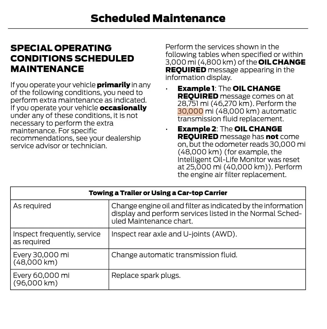

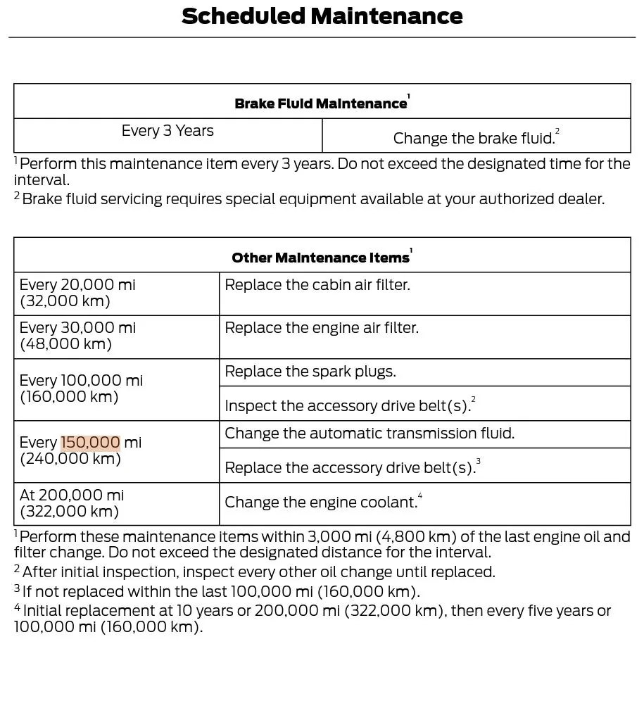

I do recommend a more aggressive transmission fluid change schedule than the manual suggests. It recommends the first one at 150k miles Under normal driving. Than suggests people who drive under “special operating environments to change at 30k with no middle ground. Otherwise the manual seems to be fine. Pages 441 and 442 of owners manual for reference.
Something people don’t think about. If you plan to take a trip the mountains or something that would make the vehicle go through its passes an extra oil change before wouldn’t hurt, or after if you just did one recently.
