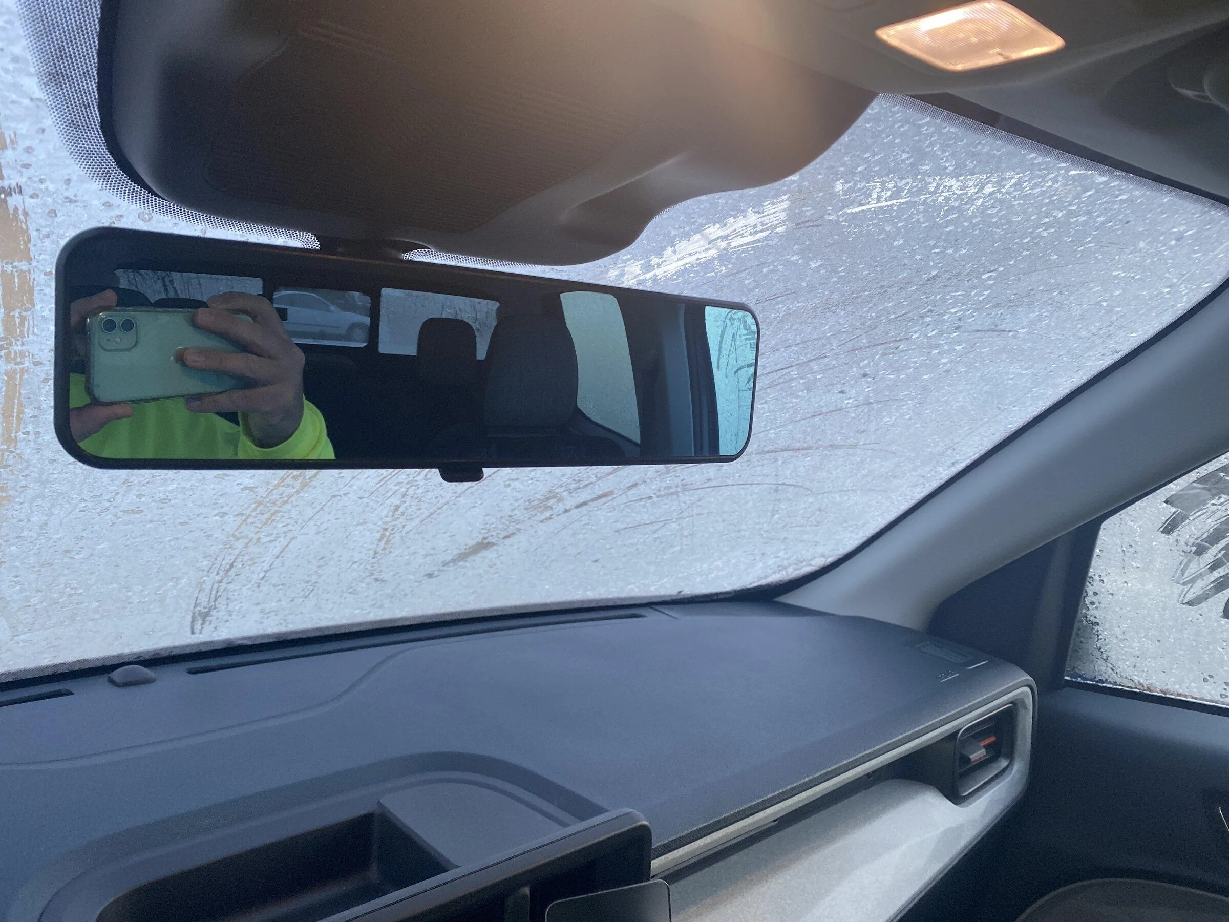

I’ve been rocking a convex mirror for 28yrs. Since I was 16 and found one at a flea market. I still have my original one which never went with a car I sold.
Same here! Hoping my original Broadway convex fits

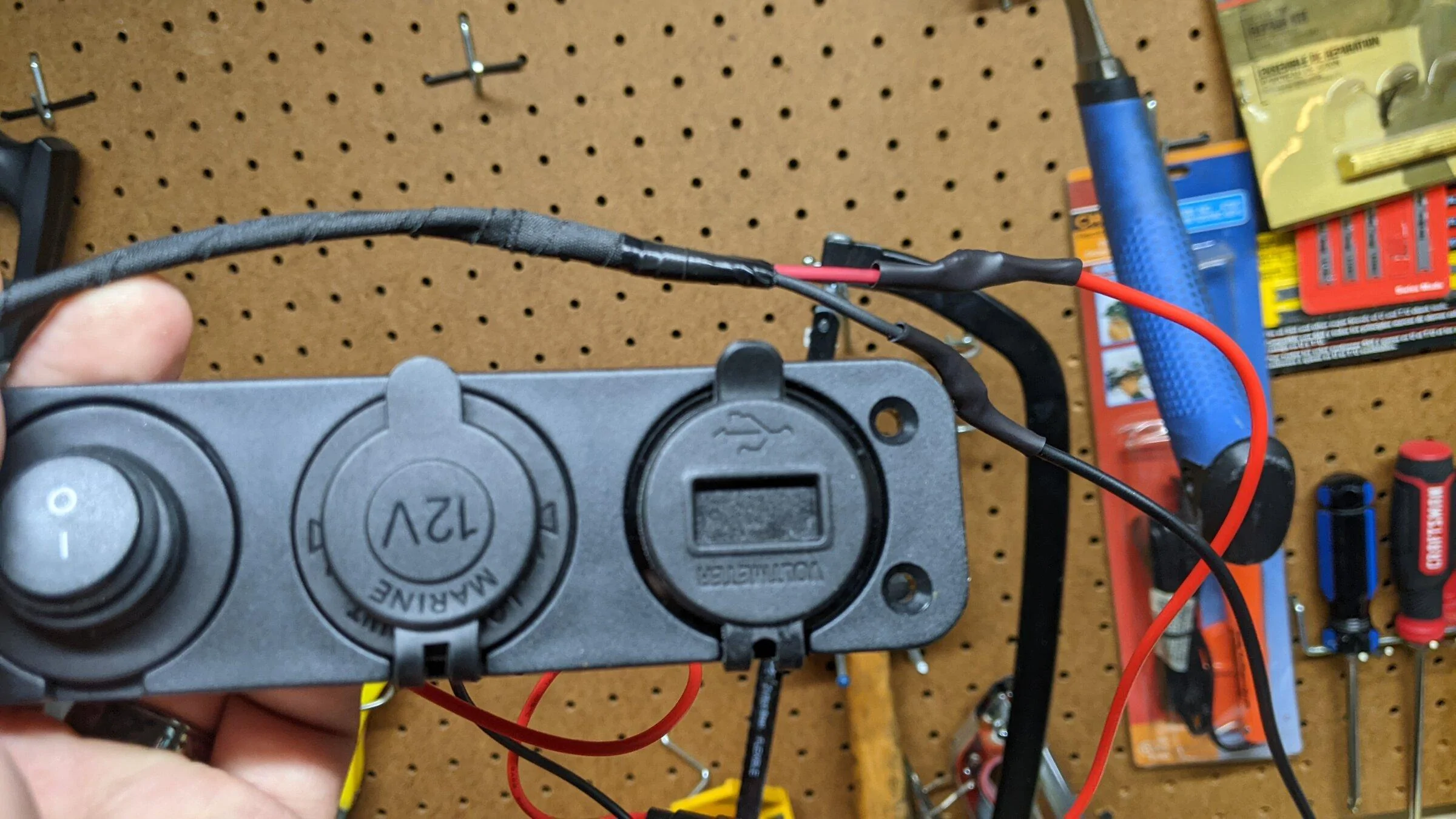

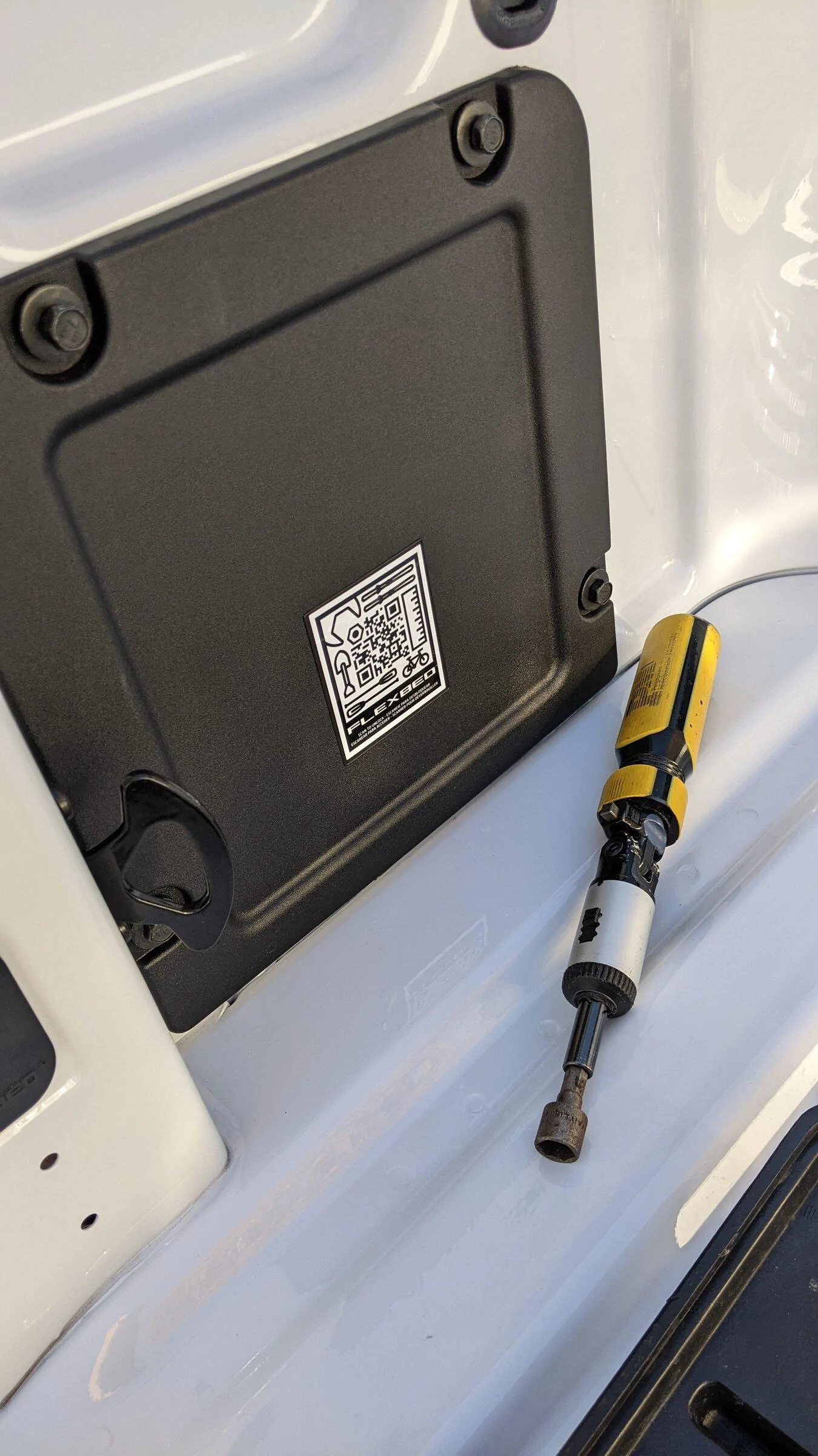

Next up... Power to the bed.
10mm bolt

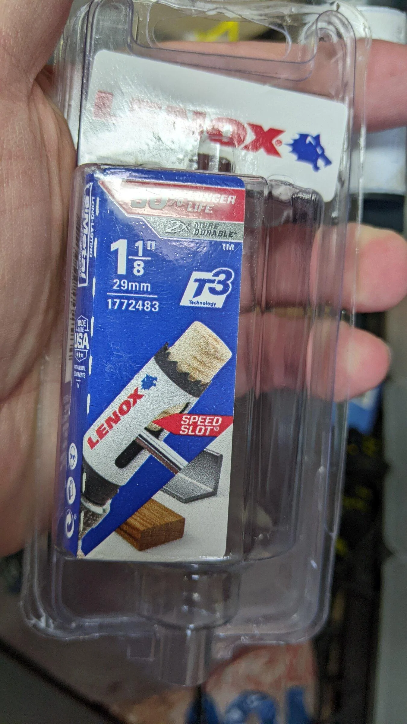

Here's the bit I used

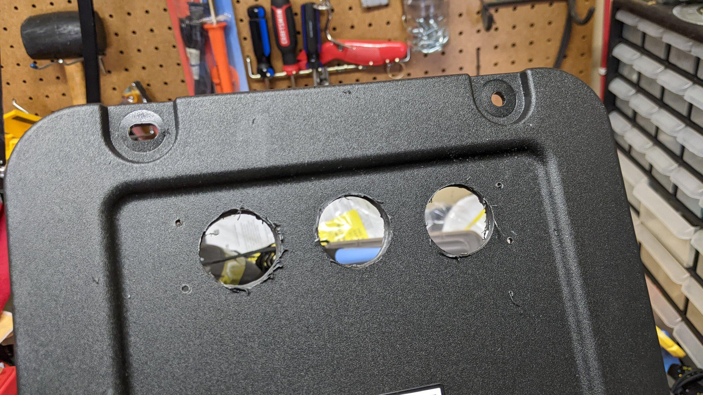

Laid the plate out, penciled in where to drill and drilled pilot holes for all.

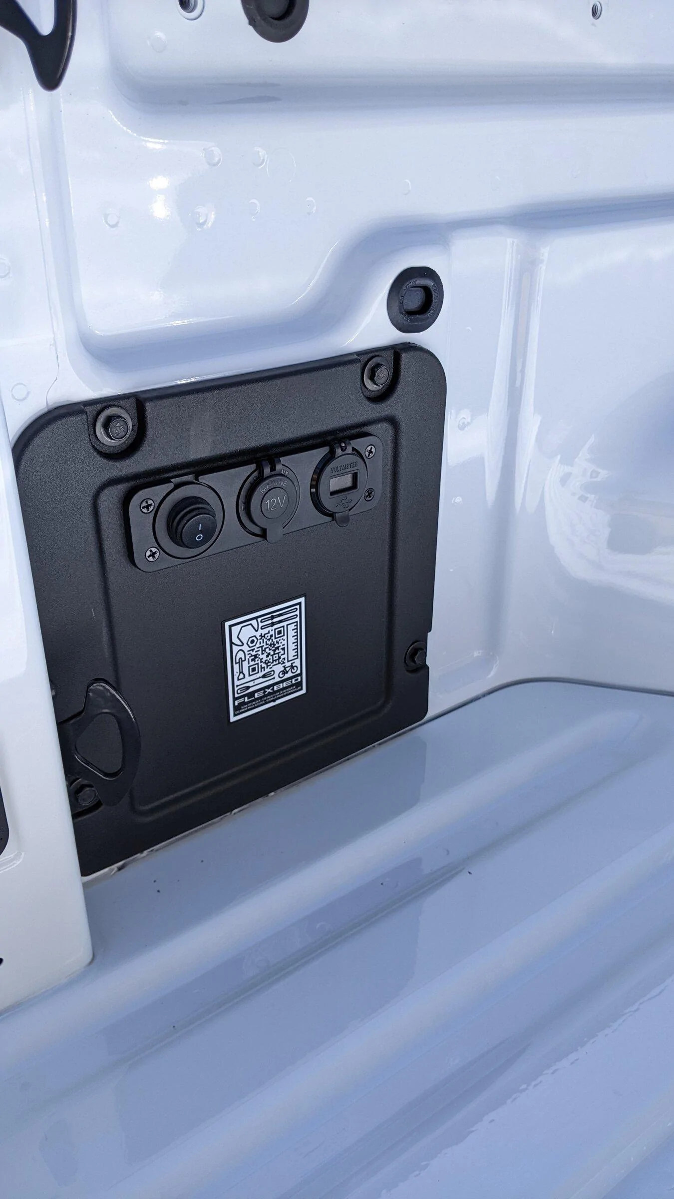

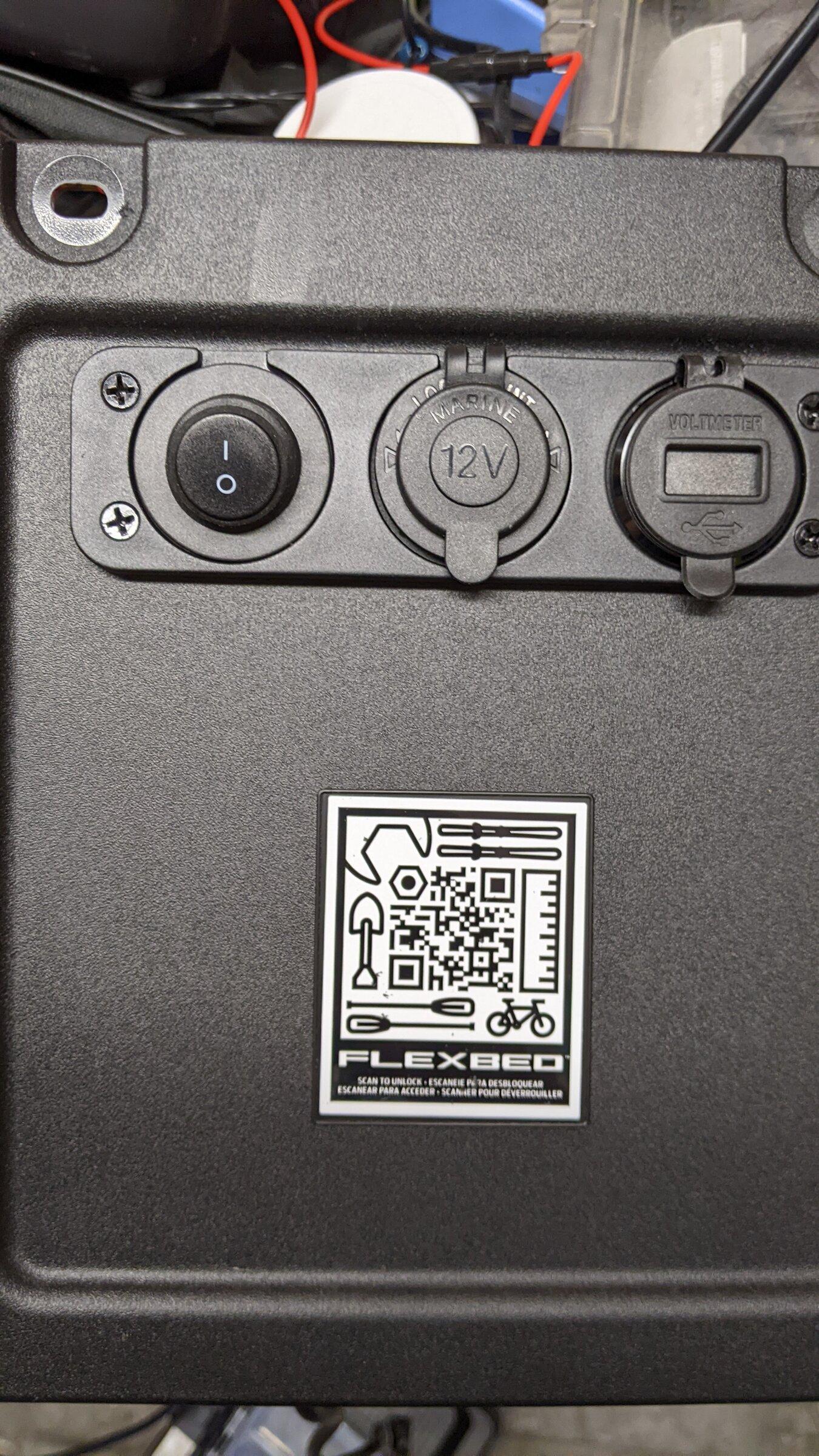

Plate and plugs installed.

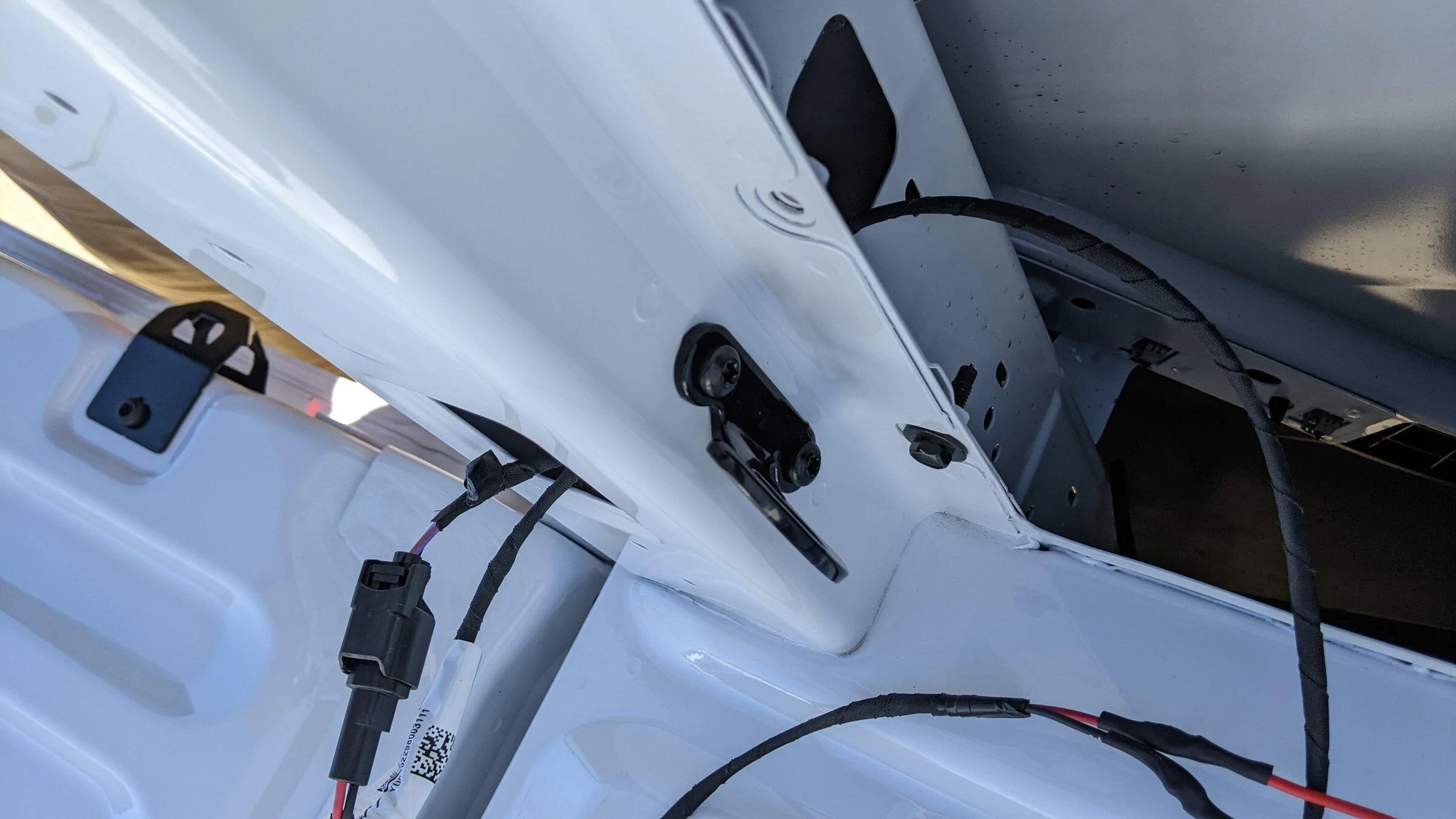

How I ran the wires. I used a zip tie to make sure there weren't wires hanging down.

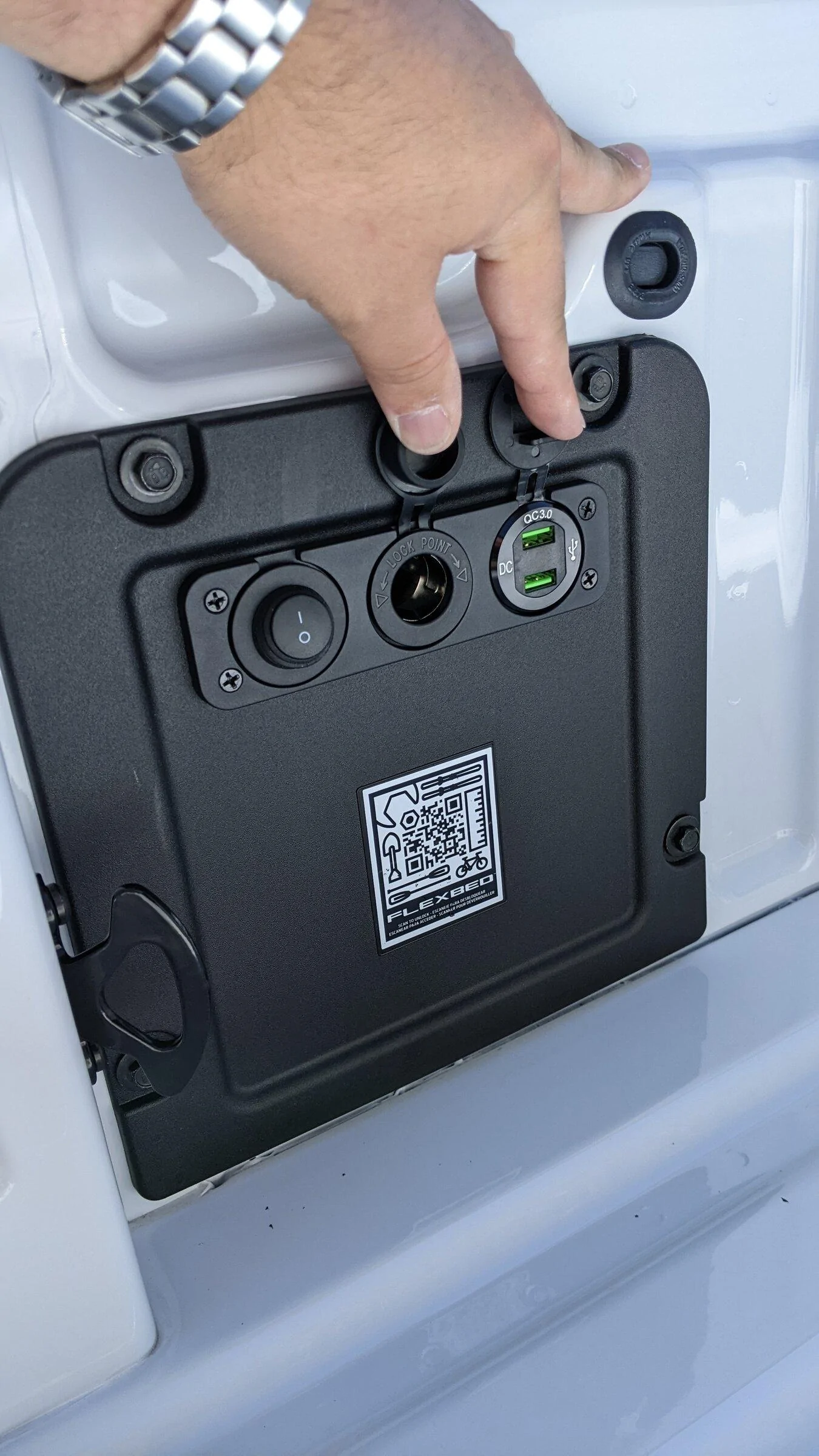

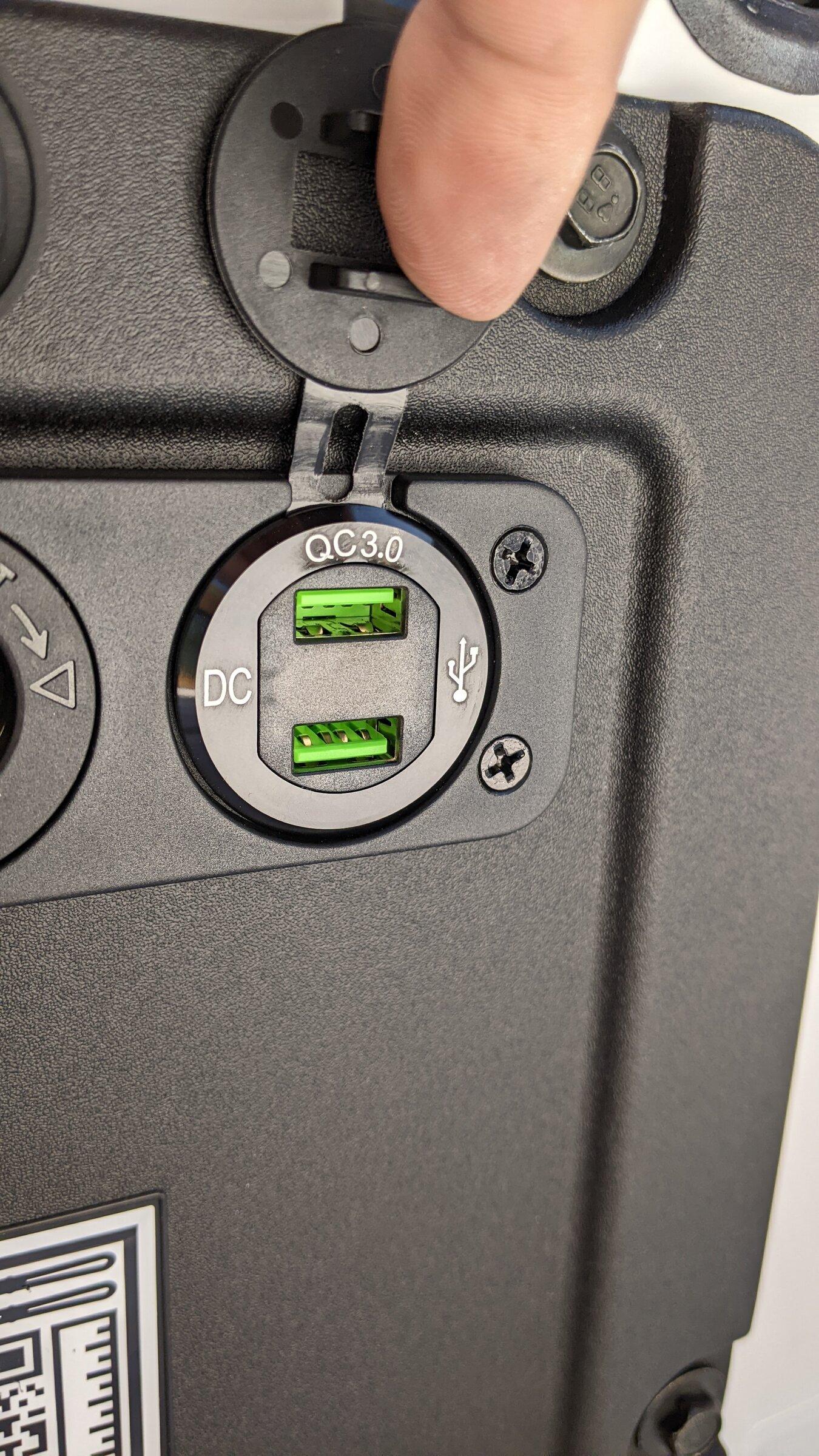

All done and working!
You can't see it because the glare, but there's a voltmeter between the USB plugs.
After I get a spray in bed liner, I'll consider adding need LED bed lights and wire them into the switch so that the switch powers the DC USBs and LEDs. 😁👍👍

Thanks for giving me hope that my 240mm will fit. I thought the stock mirror was 10.5" wide and I would need to get the 270.
