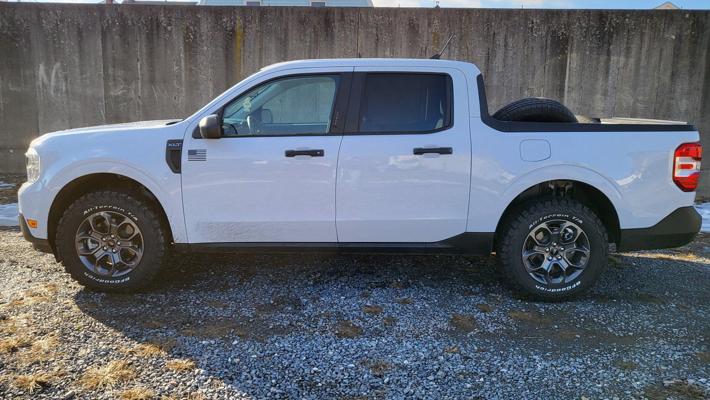

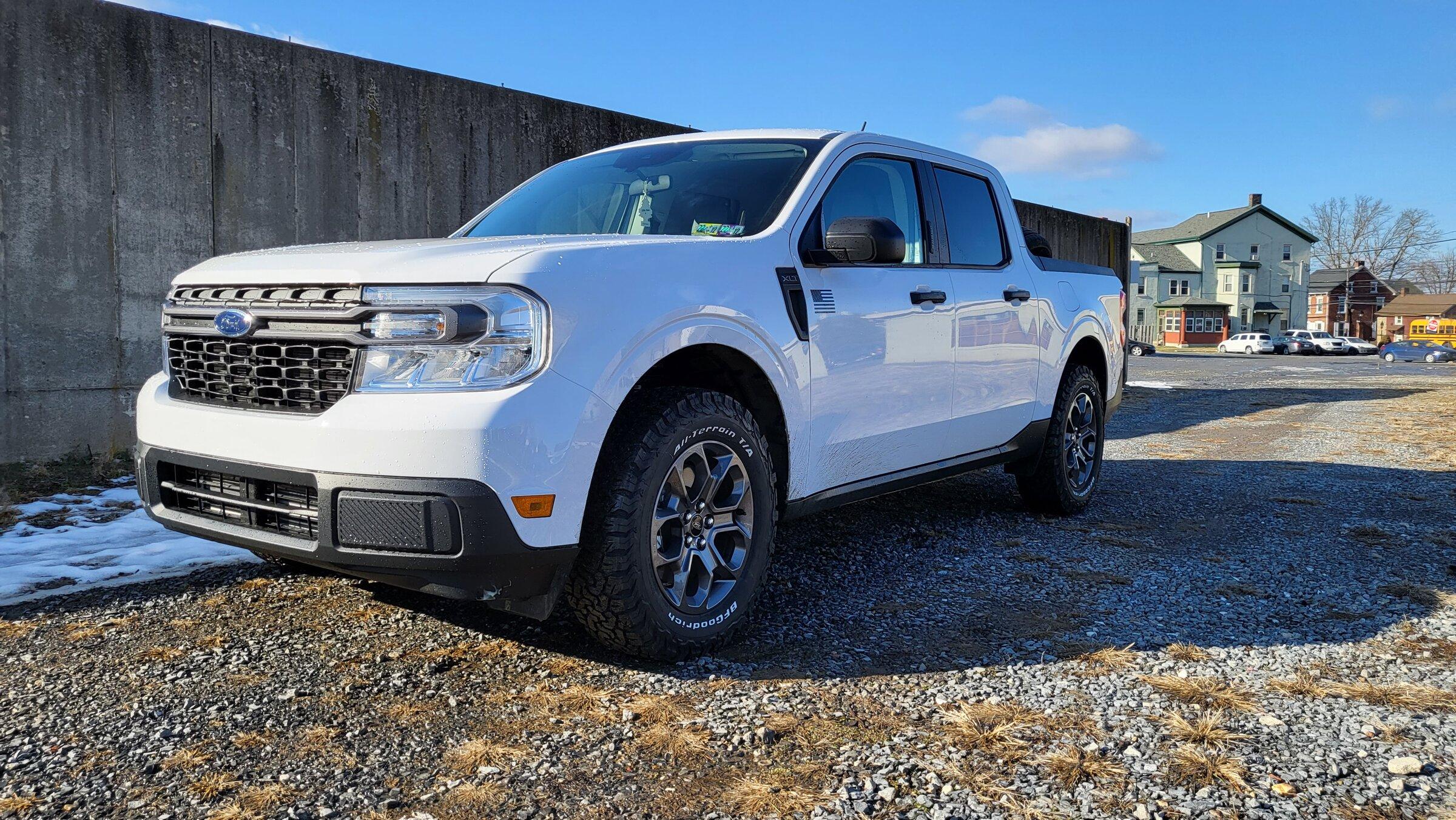

Just got my new shoes installed. Bfg Ko2 in 245/65r17. I can confirm I don't notice any rubbing and I think it looks a lot meaner. The tires do seem to stick out just enough to spray dirt on the side even in just my short drive home. That being said I do intend on adding wheel spacers and the rough country 2 inch lift in the future so I'm sure it's only going to get dirtier 😎
Although I think (and have seen) you could definitely squeeze 70s or 75s in there but I wanted to keep my speedo and mpg as close to stock as I could so I think these were a good compromise.

Very nice! Great choice!

Did you lose any mpg??

I haven't paid too much attention, I'd assume it dropped 1-2mpg just because they're heavier and wider than the originals. Also road noise is slightly more noticeable but that doesn't bother me I always listen to music anyway :)

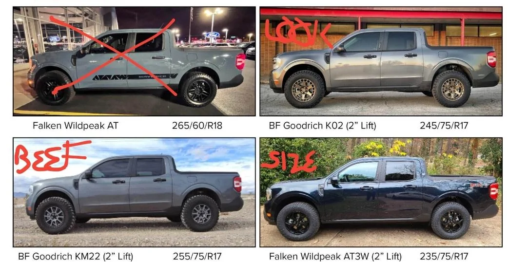

I've been debating which tires to buy and dropped a couple of options into a sheet to compare and then figured I might as well put a bunch more images in as maybe it will be helpful to others when choosing tires.
I did my best to gather the correct tire and size information but if any of these are your truck and I got it wrong please let me know.

75's make the tallest truck and with a 2" lift front, 1" lift back and looks the best (IMO) BUT SPEEDO GOES WACKO!

Great report! Thanks for sharing

Thanks for posting this info! 245/65/17s are the sweet spot without a lift.
I put the BFGoodrich trail terrains in this size. Fantastic tire. Although, especially the front tires, the stick out ever so slightly enough a lot of debris and mud, snow, etc. get flung up along the sides of the truck. To protect the longevity of the paint I did order some mud flaps, something to note.
