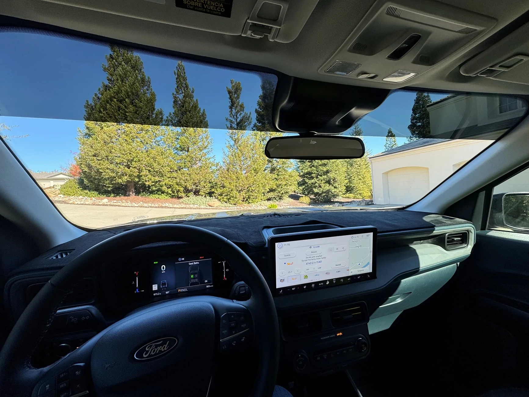

Each summer, we get around a ten day run of plus 110 degree weather with a sun that will bleach your bones while you're still alive. Having the windows tinted and the strip across the top of the windshield makes a huge difference in the amount of heat you feel on your skin while driving as well as the temperature inside the truck.
As someone who has gone a couple rounds with skin cancer, I appreciate the protection that tinted windows afford. I use dark tint on the front windows and the limo grade tint (darker) on the windshield strip, bringing it down to the A line. It looks straight across in the photo but it's actually curved to match the top of the windshield. The back windows and rear cab window came tinted on my '25 Lariat Hybrid. Works for me.

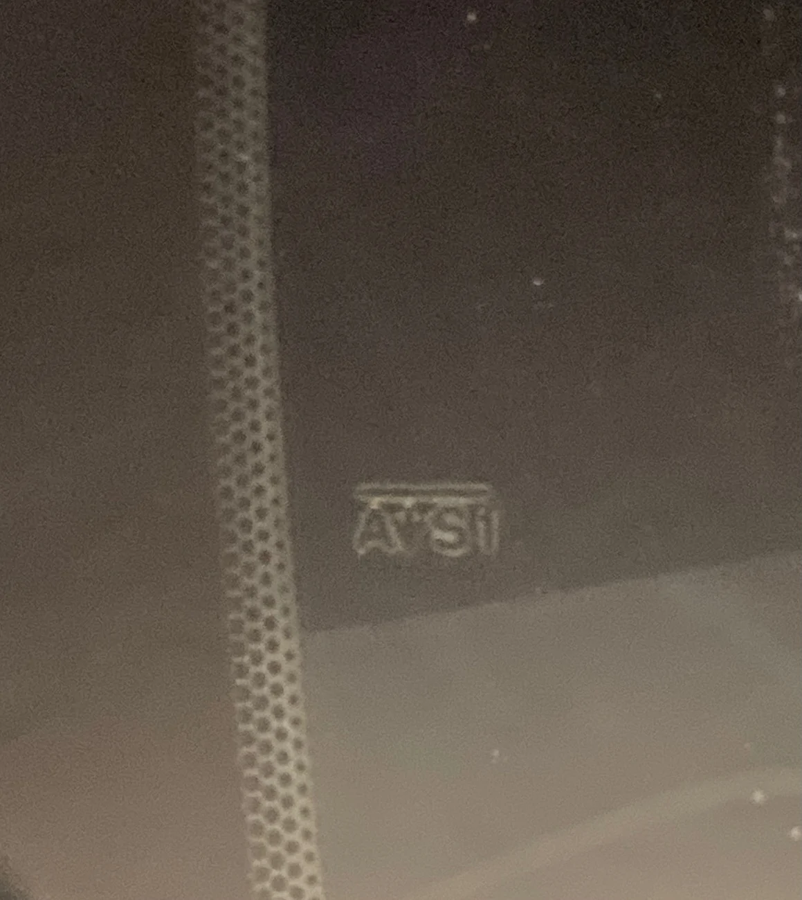

Note the AS-1 line that is etched into your windshield. Fed Law prohibits a shop from legally tinting below that mark fyi…
One can DIY lower at risk of getting a fix-it-ticket or unwanted traffic stop…

AS-1 line - good to know. Found mine is 2 inches below the AS-1 line. I'll remove and raise my windshield...tinted strip. The AS-1 line make sense.

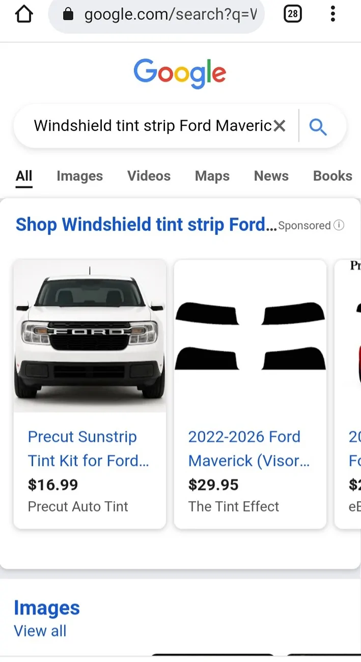

I searched windshield, stripe, tinted, and band and never saw this post!
What was the subject on this post?
Bill, @bcooke
Here you go the first one is the thread that you were inquiring about or use the Google button on the search function.
https://www.mavericktruckclub.com/f...-of-tint-for-the-top-of-the-windshield.76412/
This is another thread on the subject.
https://www.mavericktruckclub.com/f...windows-and-a-5-strip-across-the-front.18581/
Because the search function sucks on the form if you just type in what your looking for in Google.
https://www.google.com/search?q=Win...j4.34.mobile-heirloom-hp..0.6.850.FMXT1bcYVQA
