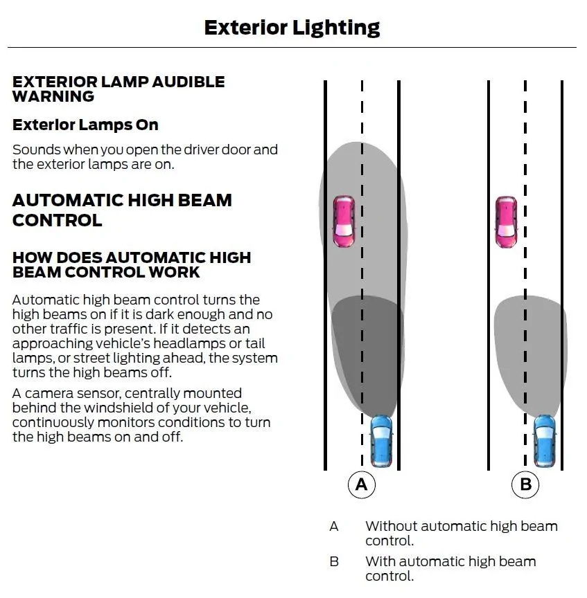

As far as I know, I only have a backup camera. But that camera sees out the back window, not the windshield, yes?
No all Mavericks have a Front Camera.
That camera is used for the "Automatic High Beam" and "Pre-Collision Assist".
Also if you have CoPilot-360 then the front camera is also used for the "Lane Keeping System"
Ford Maverick Acoustic Windshield Automatic High Beam
