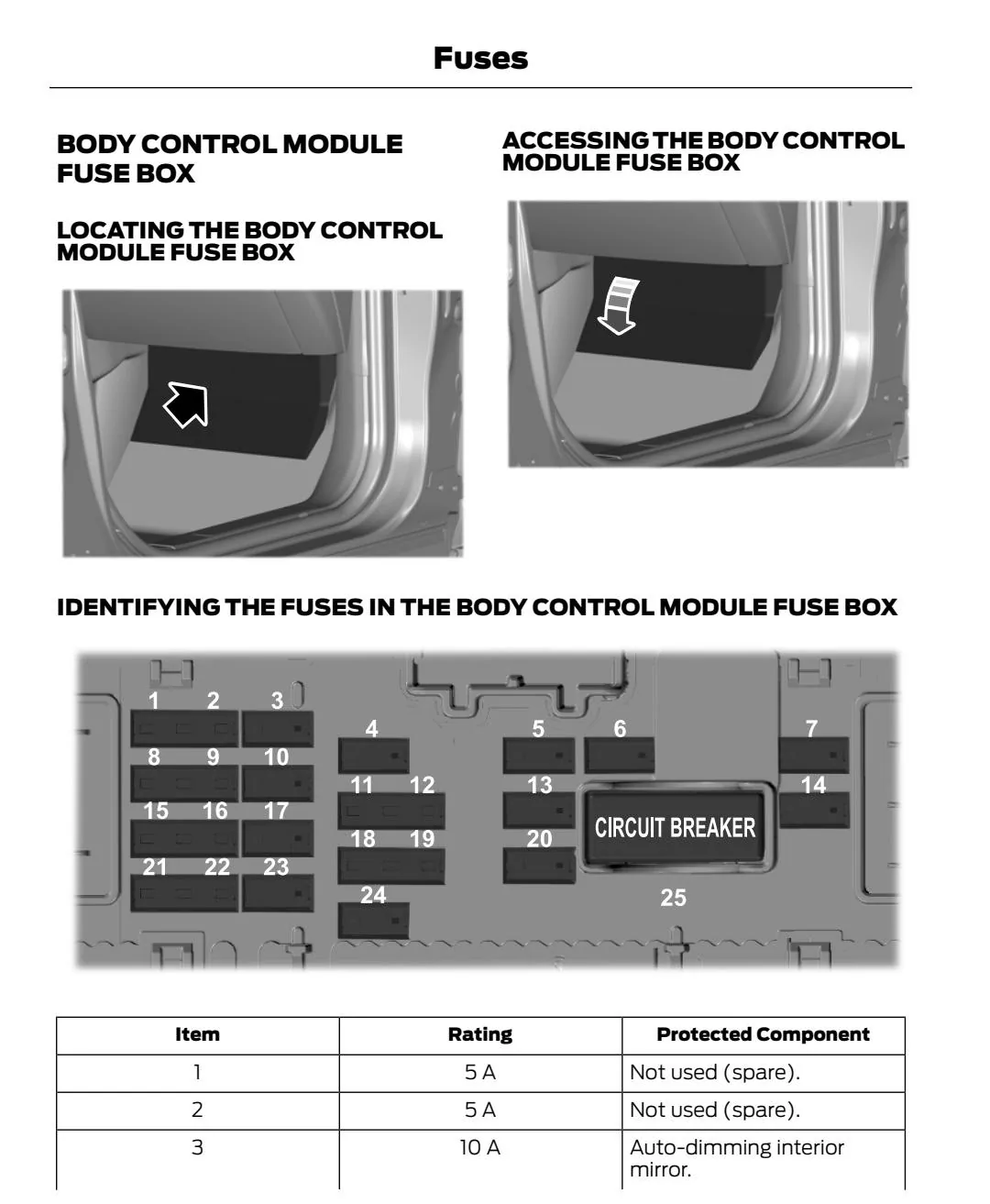

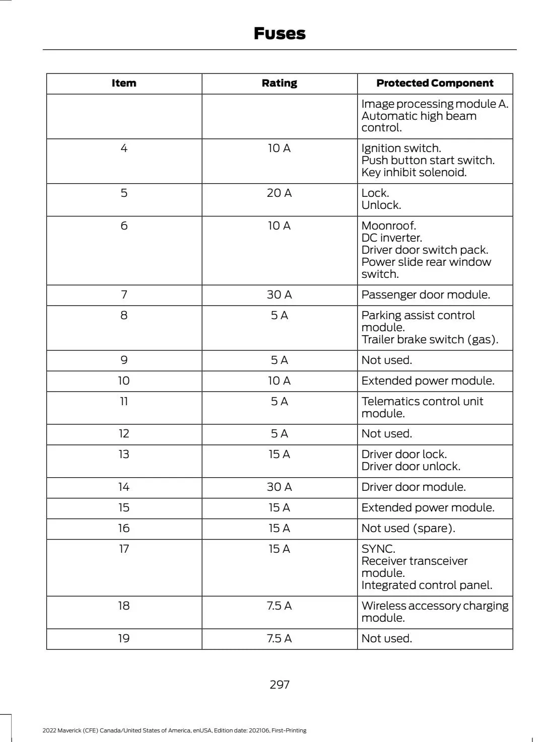

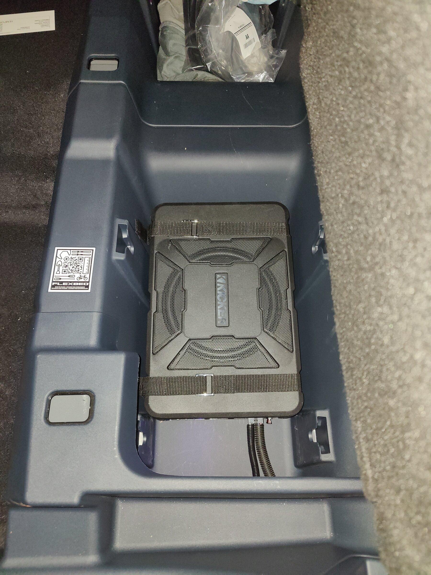

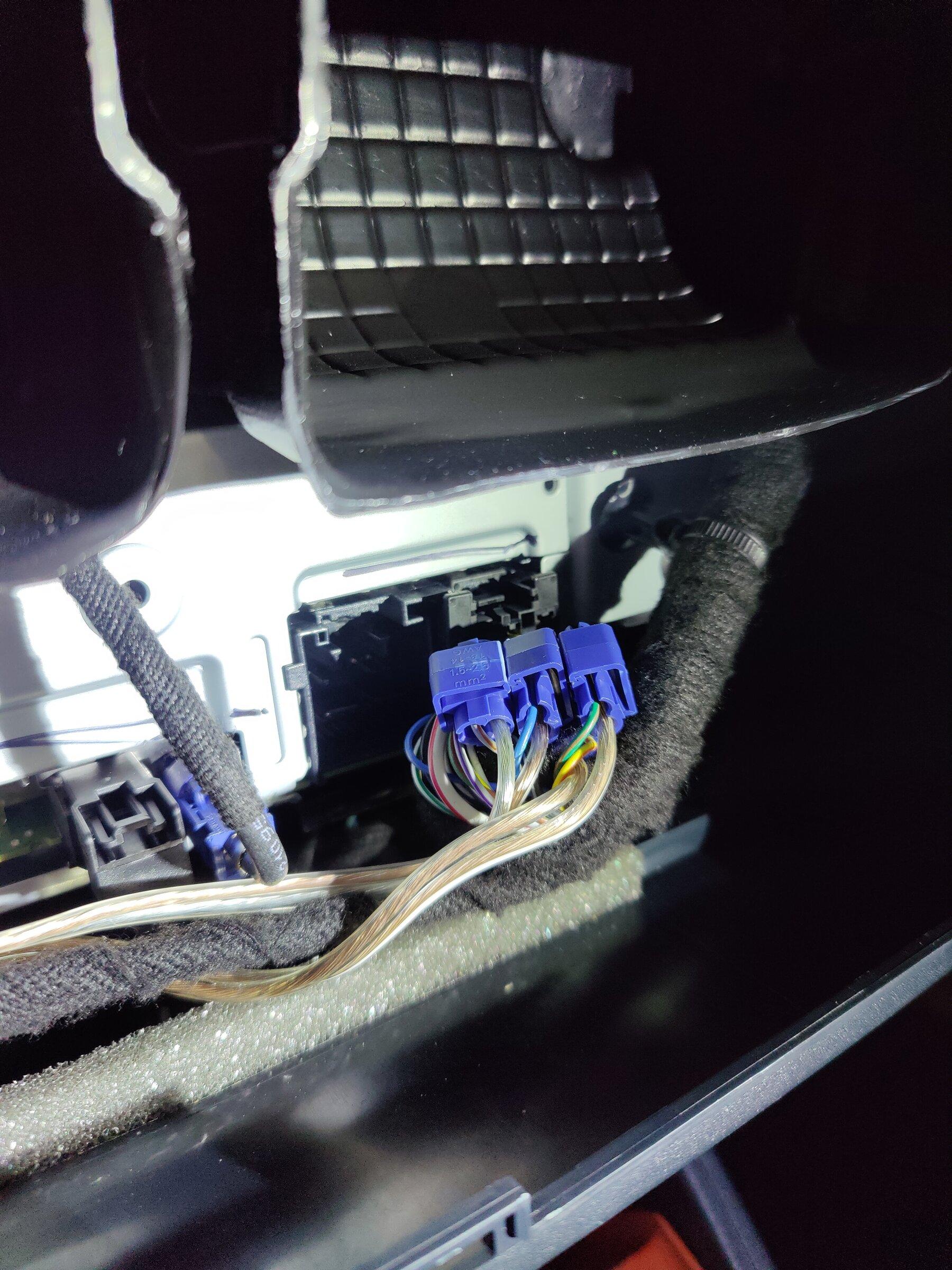

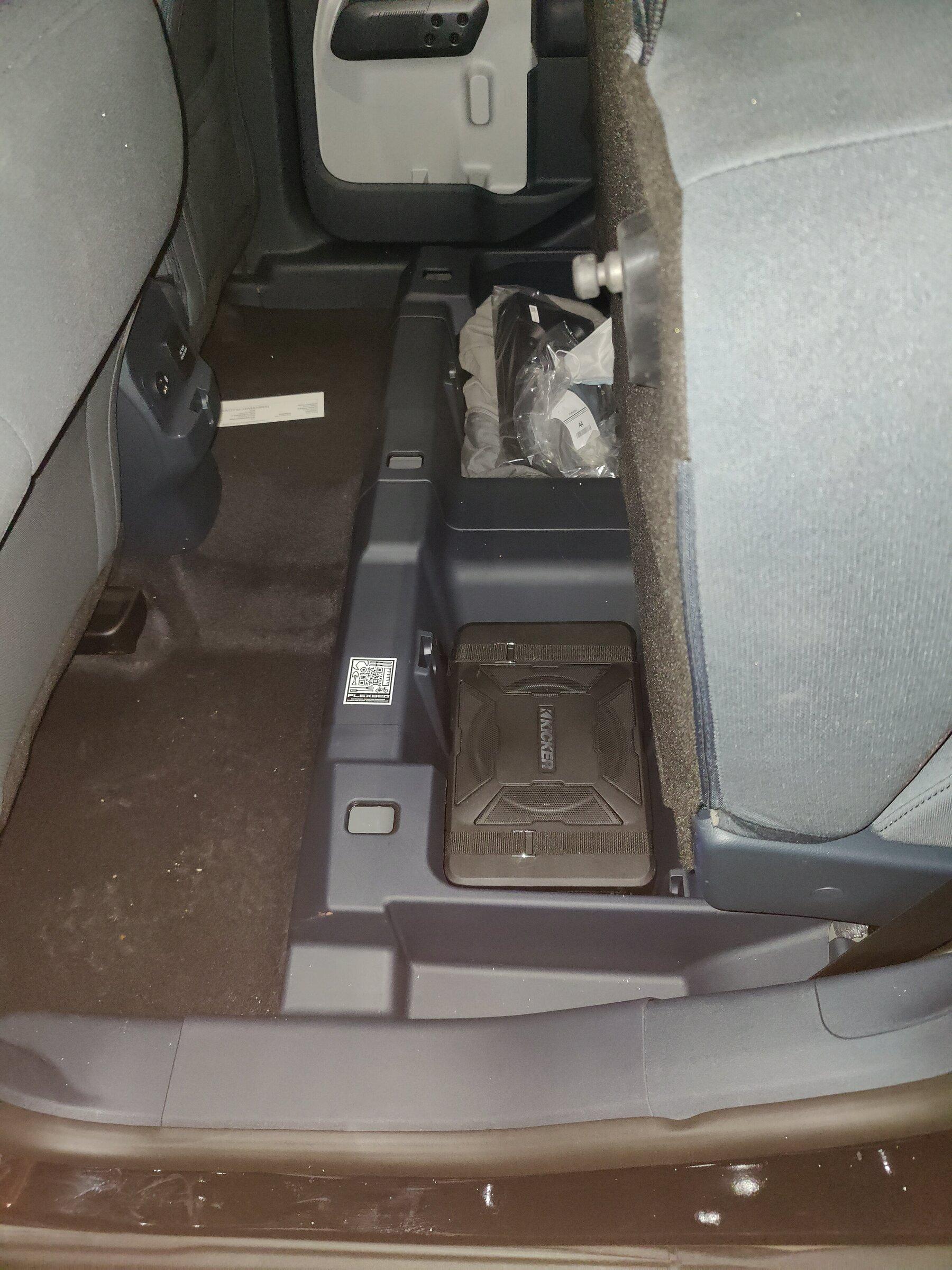

Finished up my Kicker hideaway install last night thanks to the info in this thread. I simply used wire taps on the wires as they left the head unit connector. (Of course this only applies if youre just installing a sub instead of a new amp etc. for the existing speakers.) Its a little crowded and theres definitely cleaner ways to do it but this is definitely the fastest and doesn't require any cutting of the factory wires, not to mention it'll all come off in seconds if you needed it to. As for the remote I simply tapped into fuse #6 in the cab fusebox. The power and signal wires were all ran on the drivers side and remote on the passenger side.
THANK YOU to everyone who participated in this thread as it contained all the info I could've possibly needed and this was the easiest audio install I've personally ever done.

That does look like a fantastically simple install. How do you rate the difference over stock? Is it over or underwhelming?
Rareone
Parker
Dec 13, 2021
109
Las Vegas
Maverick XLT
It definitely was simple. Not a single screw or bolt needs to be removed.
Its obviously not crazy bass but it does vibrate the truck and make a world of a difference, its what the stock system SHOULD sound like from the factory.
In my opinion, with how easy and fast the install is, its a no brainer to just do it.

Questions before I install as well, you still ran power from the battery through the firewall and to the sub right? Also would you be able to post a picture of the fuse tap?
Rareone
Parker
Dec 13, 2021
109
Las Vegas
Maverick XLT
Are you asking me? If so then yes I still ran the power through the firewall. I could post a picture of the fuse tap when I'm back at home but its just one of these things.
