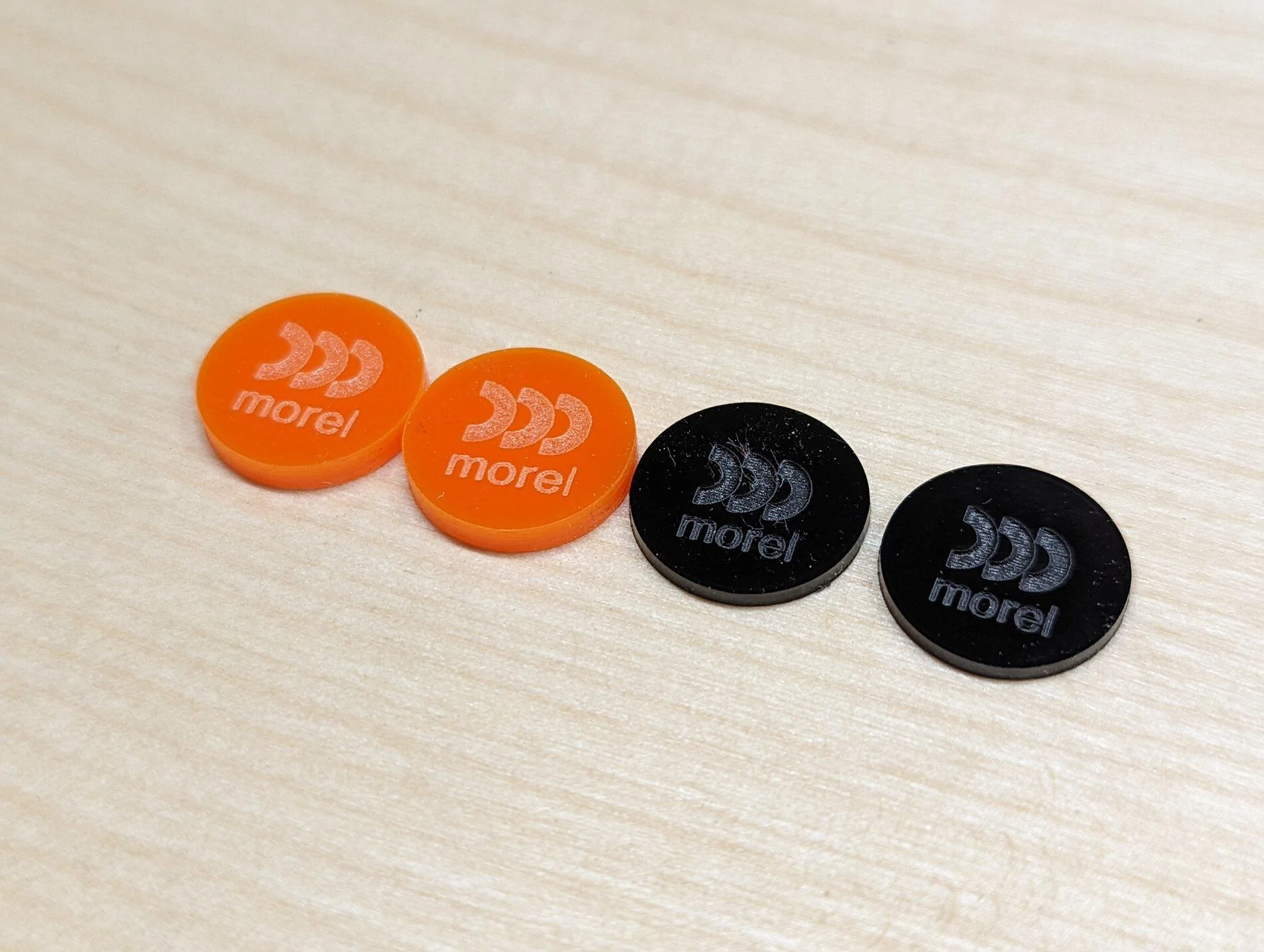

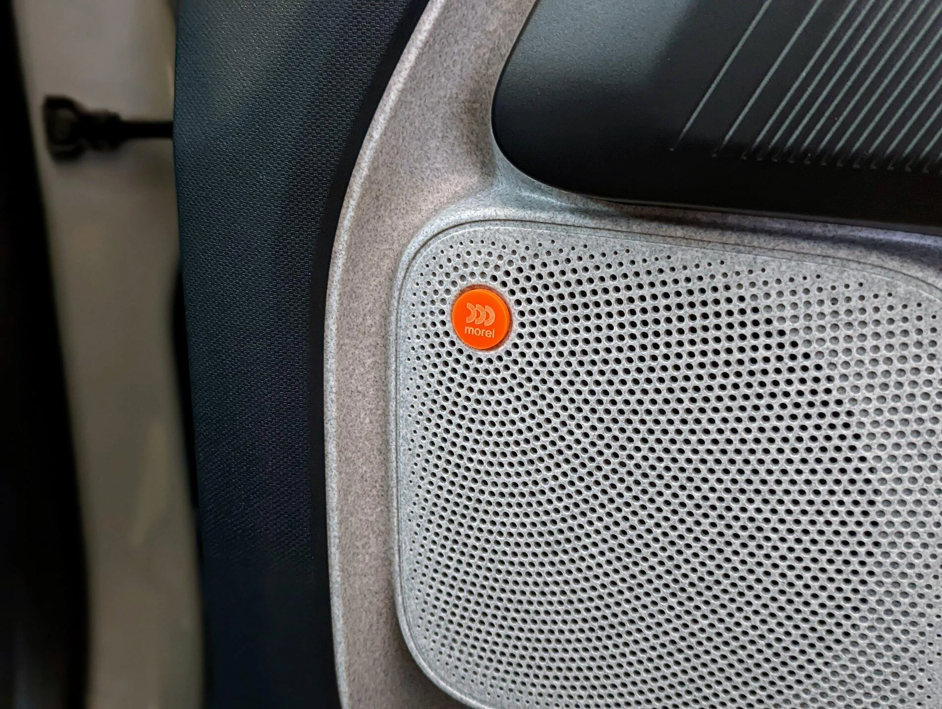

Made a small update on the install today.
I hated how the place for the B&O logo is empty on the XLT so I used my new toy laser cutter to cut a small morel logo for the doors in orange acrylic. I liked how it look now.
I made a black version and well, but that was a little boring, the orange matches the XLT trim pieces.
Ford Maverick Upgrading the XLT base audio system / door panel removal - finished with lots of pics. PXL_20211128_211953188
And installed.
Ford Maverick Upgrading the XLT base audio system / door panel removal - finished with lots of pics. PXL_20211128_213107905.PORTRAIT
And installed.
sooo good!
