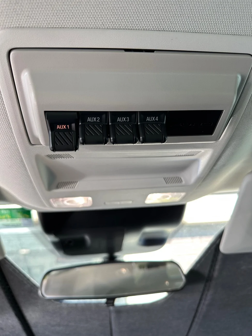

I can agree that I don't like to drill anything through the firewall, however, I needed to run the wires from the BCM to the fog lights, a power line for a future rear amp, and a couple extra wires for just-in-case future mods, so it was going to happen regardless. Having switches look/is factory is the most important thing for me so hence the Ford up fitters. Plus, I used the door boot off a Lincoln Continental as the grommet through the driver's firewall hole behind the battery. It fit perfectly, fit the wires perfectly, looks/is "stock" so no cutting or modifications to the firewall was necessary.

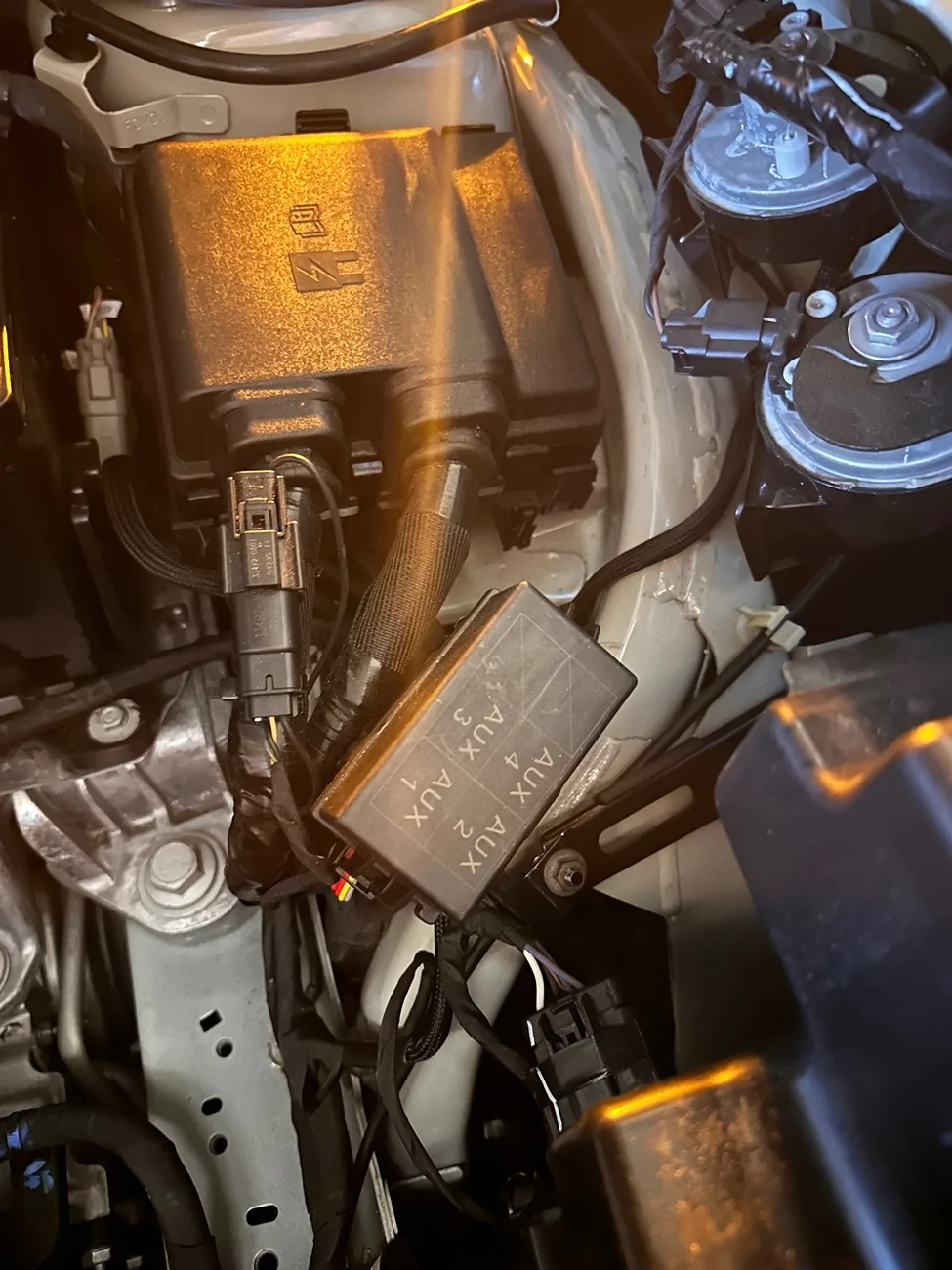

I would like to see where you put the relay box. I want to make mine look “factory”.
I just fabricated a quick bracket and mounted it to an existing stud.

Ford Maverick Upfitter AUX Switch Kit for Ranger fits the Maverick IMG_3230
Mavtremor
Luis
Apr 18, 2025
Punta Gorda, FL
2024 Maverick Tremor
Wow, thats exactly where i put mine.

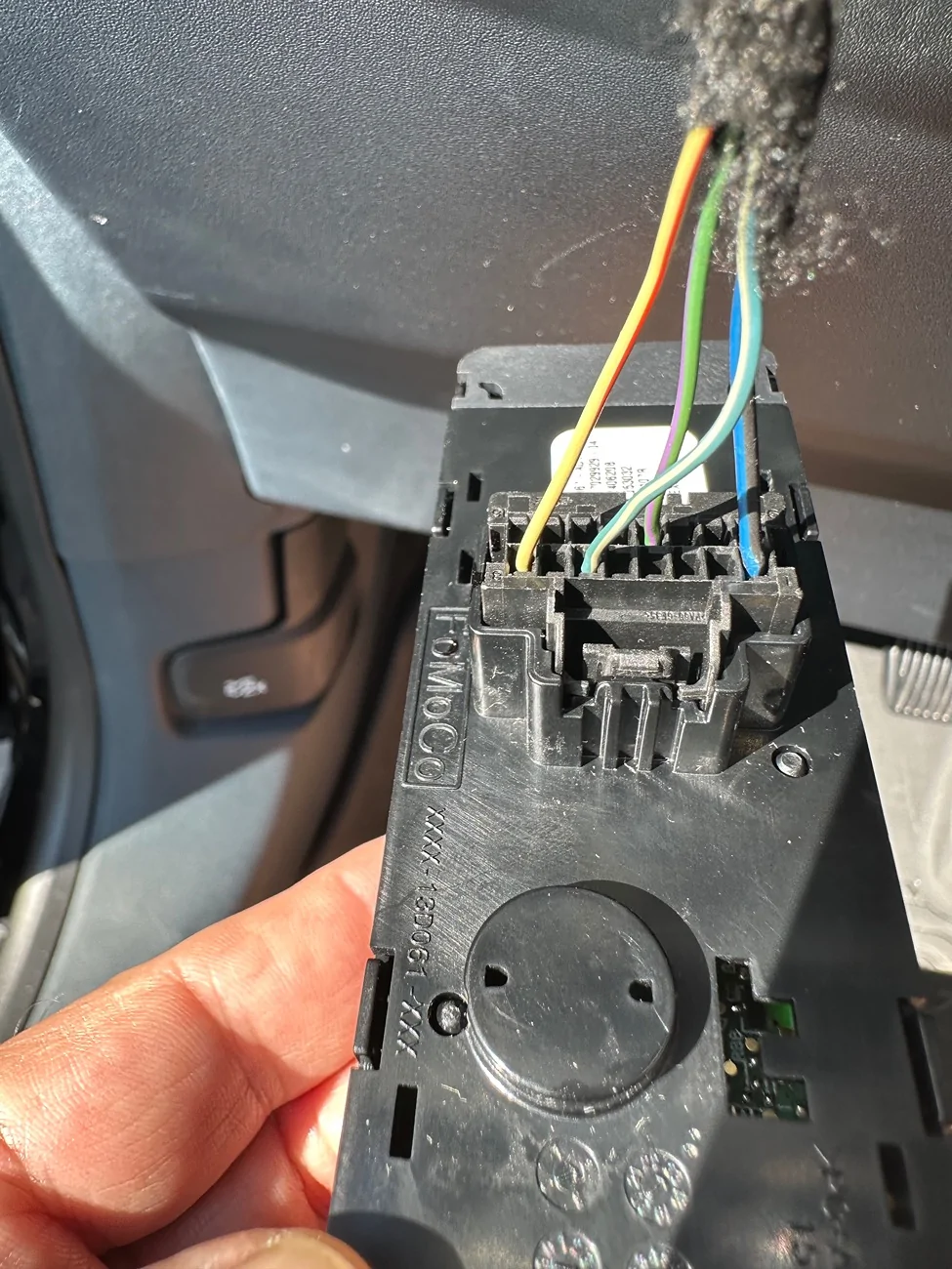

Ok, so I have mine all wire up and working. I have to figure out which wire in my 2024 Maverick Tremor is for the illumination/dimmer (violet wire in the kit). I think I can use a wire off the dimmer switch. Does anyone know what the wire color should be for my truck? It’s not grey/violet. I checked the voltage of the one I think I can use and the voltage goes from 9.71vdc to 9.45vdc when I go from bright to dim. Can anyone confirm this?
Looks to be pin 6 on this connector green wire w/white stripe?

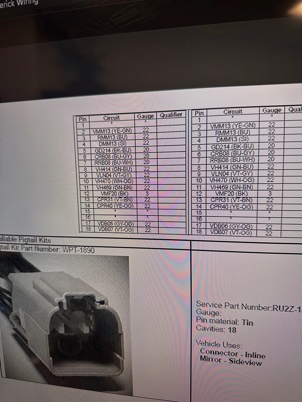

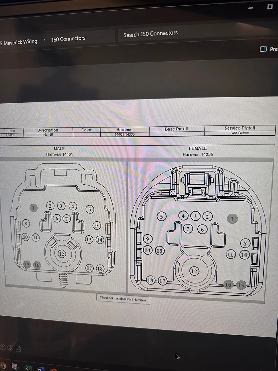

I did not use the switch. I used the C206 connector in the A pillar pin 9. Below is the 2025 wiring diagram.
Ford Maverick Upfitter AUX Switch Kit for Ranger fits the Maverick IMG_3263
Ford Maverick Upfitter AUX Switch Kit for Ranger fits the Maverick IMG_3264
