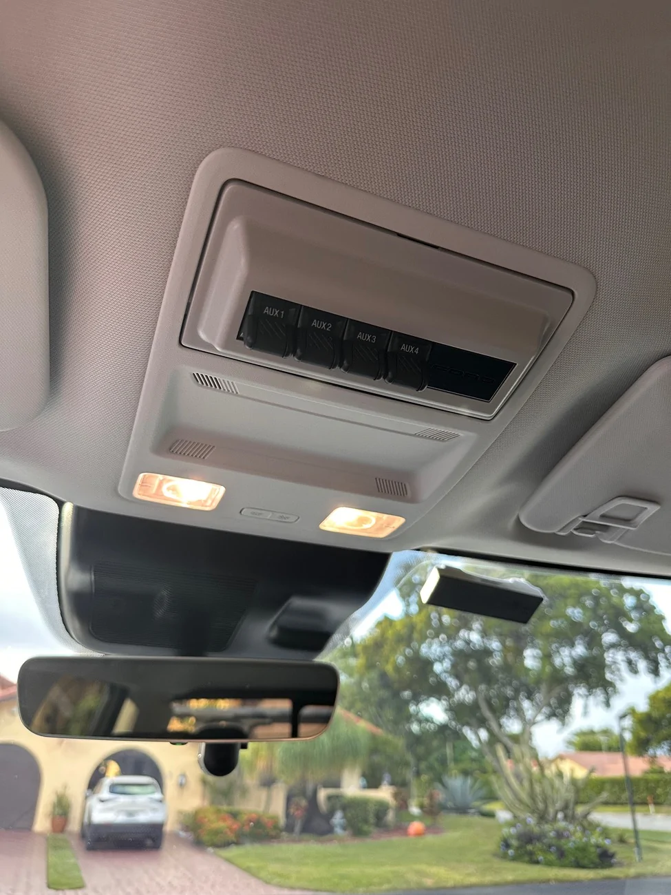

At $495 I’d like to see a step by step install before I purchase. Any link to additional switched to fill the switch bank. I’m a little OCD and blank areas where switched belong bother me. Got to fill the void ( whether I need them or not ).
I used Ford points and a promo code for 20% (Google) off so it was about $220 for me.
I will scan the instructions tomorrow and share.
It is seriously simple and strait forward to install. Step 1: Disconnect the battery, then run wires (from the battery, through the firewall, up the A-pillar and over to the overhead console), tap the cluster lighting circuit, pin the new connector for the switches (it comes with the connector for the switches not on it so it's smaller to pass the wires), connect the power. Then you can go from there with what you hook up to it.

I’m sorry, I meant removing the sunglasses holder and replacing it with this. Does it pretty much snap out and snap in? Excuse the dumb questions, I’m on the road and my maverick is at home so I can’t look at it right now.
You will have to remove the sunglasses tray, damper gear mechanism and the latch, then this one pops in and you actually retain it with two zip ties through where the previous hinge pin was. It's not visible and it's solidly secured. It will not flip open, move, or whatnot if you push or pull on the switches. If you're hesitant, you can get replacement consoles for under $100. I had a black one for a while from a mustang I was using because it was different that I picked up for $40 on eBay.

You will have to remove the sunglasses tray, damper gear mechanism and the latch then this one pops in and you actually retain it with two zip ties through where the previous hinge pin was. It's not visible. If you're hesitant, you can get replacement consoles for under $100. I had a black one for a while from a mustang I was using because it was different that I picked up for $40 on eBay.

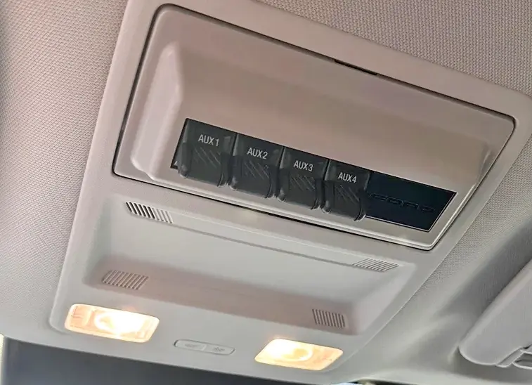

I just came across the Ranger Upfitter Switches for what I believe will replace the sunglasses cover in the overhead console. I know the Ranger has the same overhead console as the Maverick and Mustang. Just wondering if anyone else has installed these. I just ordered mine for my tremor. I was originally going with GM switches, but I prefer the stock OEM look.
UPDATE: The kit does fit the Maverick. Just need to accommodate for the illumination wire tap.
Ford Accessories - Ranger Switches
Updated with installed look:
Very happy with the kit. The gray is only a very slight shade darker than the Maverick. The kit is great. Includes everything you need. Just have to accommodate for the switch illumination tap.
Very cool. So it's an official upfit not a replacement part.
