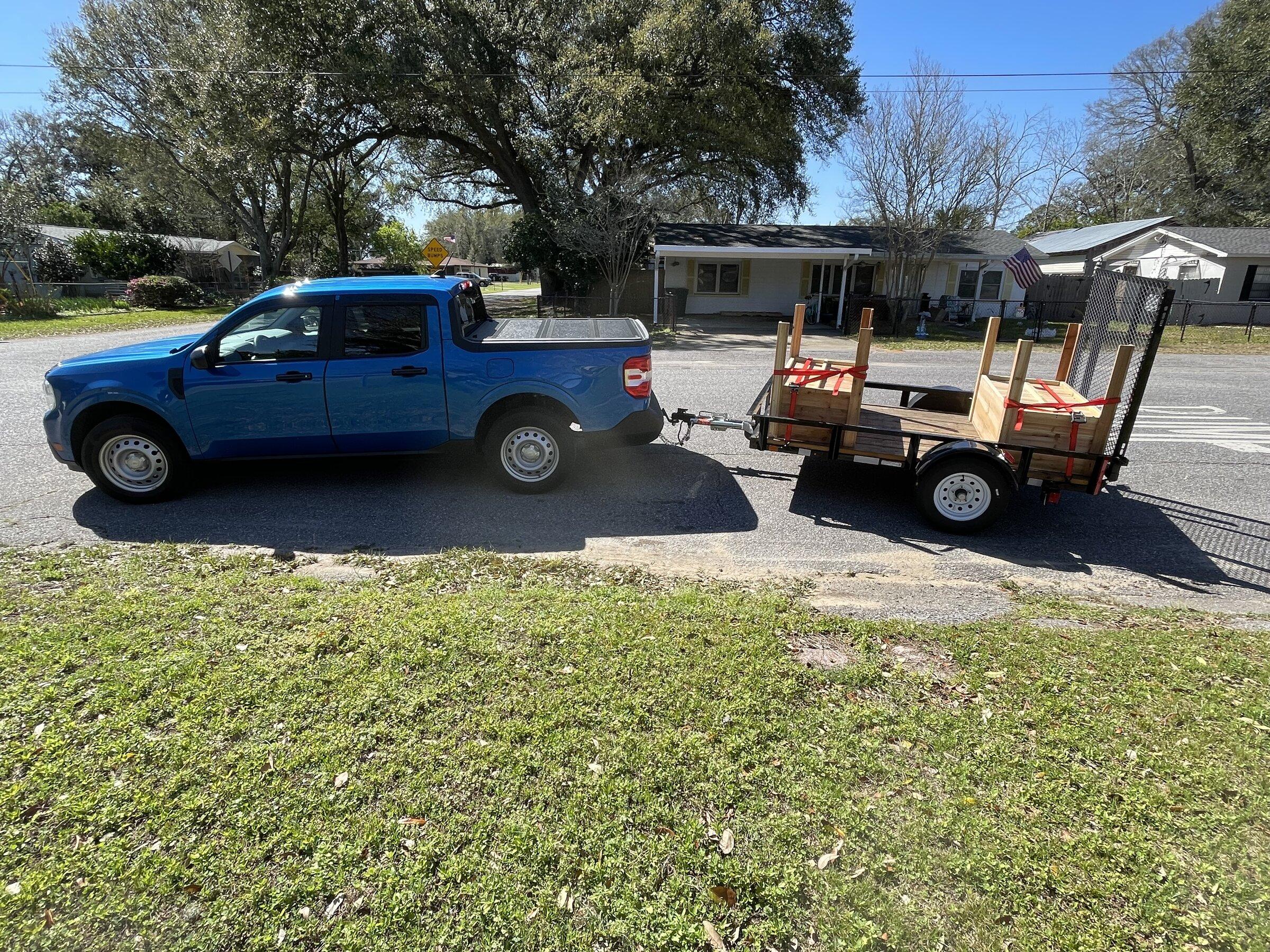

I have to thank finallygotamaverick for his ingenuity!! With his lead, I ordered the Curt BS wiring harness. I had it installed yesterday. And just like his, the brown and red wires on the harness needed to be spliced and switched to make everything work properly.
And for “Negative Nancy” out there that says “you should have added the tow hitch when you ordered your Maverick”, some of us are still waiting on our orders to go into production. I, like others here, picked up a Maverick that a customer ordered, but canceled their order. The person that ordered the Maverick I have didn’t need towing capabilities. I do. I make raised bed garden boxes and deliver them to customers with my 5’ x 8’ utility trailer.
I ordered a hybrid XLT with CP360 and the lux pkg on 19 Oct, which is now five months ago. I was called by my dealer and they read the Ford bulletin about removing the CP and lux. I refused to, and was told the regional office won’t even look at my build unless I remove them. I was lucky enough to find this XL hybrid to get me by until whatever year my build is produced.
