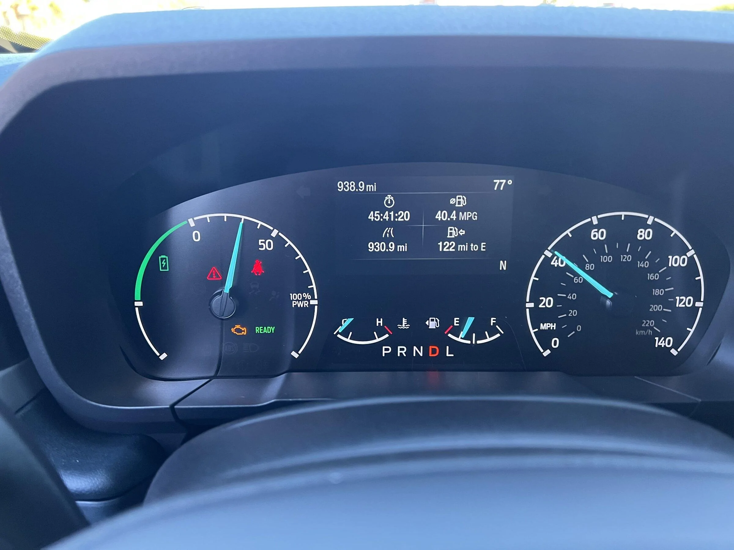

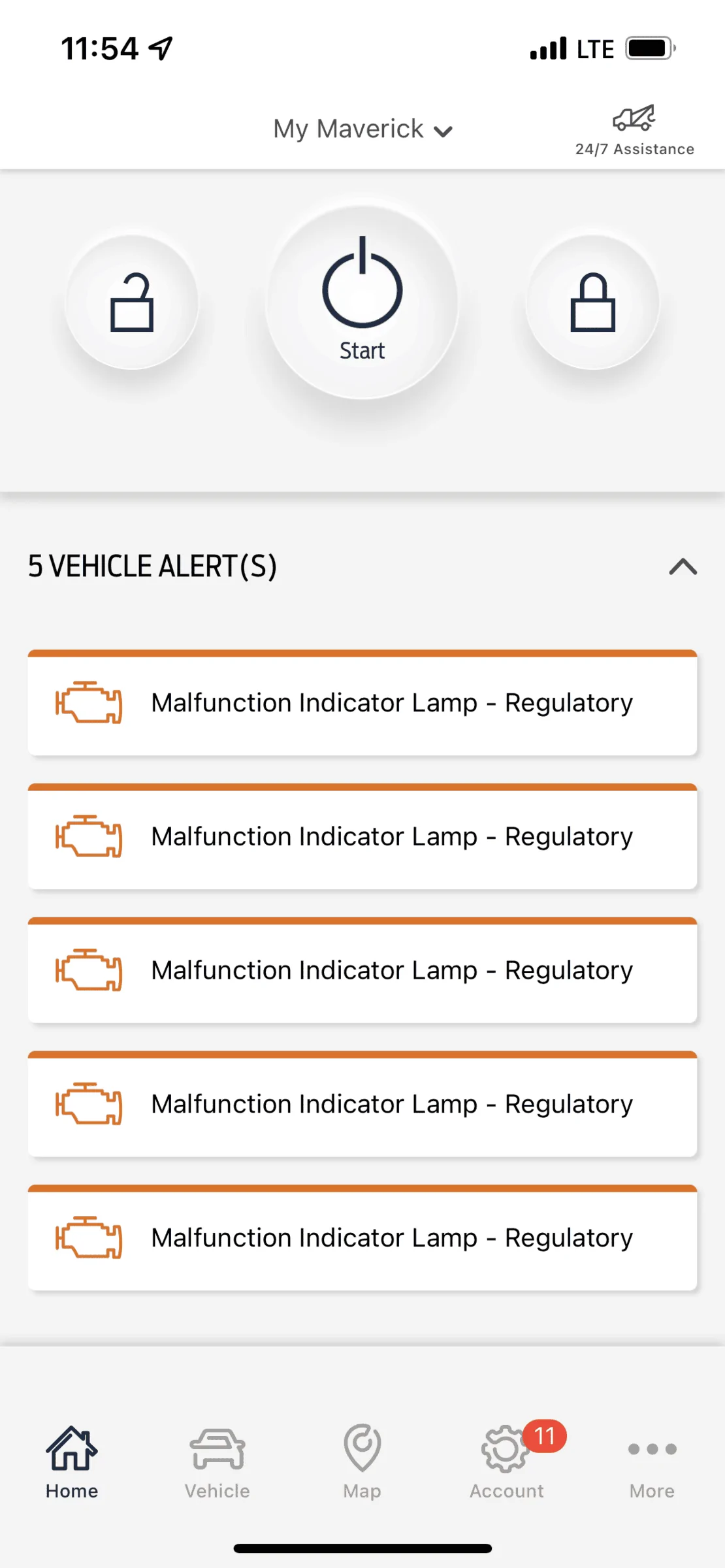

A little update for everyone, I dropped it off at my local dealer this morning. I was able to jump start it yet again but this time, the check engine light came on after I got it started. When I was pulling into the dealer, another light and chime came on while driving telling me to pull the vehicle over and stop it asap. A red triangle with an exclamation point illuminated on the dash. My service advisor said that light could indicate a major issue with the vehicle.
If anyone is interested, the codes from the check engine light were:
U3012
C0564
P2C22
U019F
They didn’t have any loaner cars available but the service advisor said he would have to call Ford to get permission to cover the cost of a rental car for me as it will likely be at the dealer for a while, in addition to the interior rattles they need to diagnose and fix.
