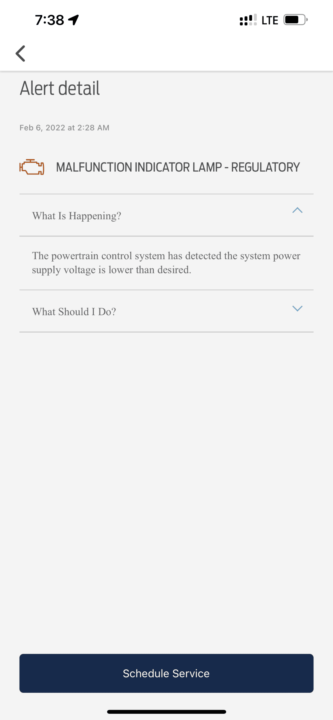

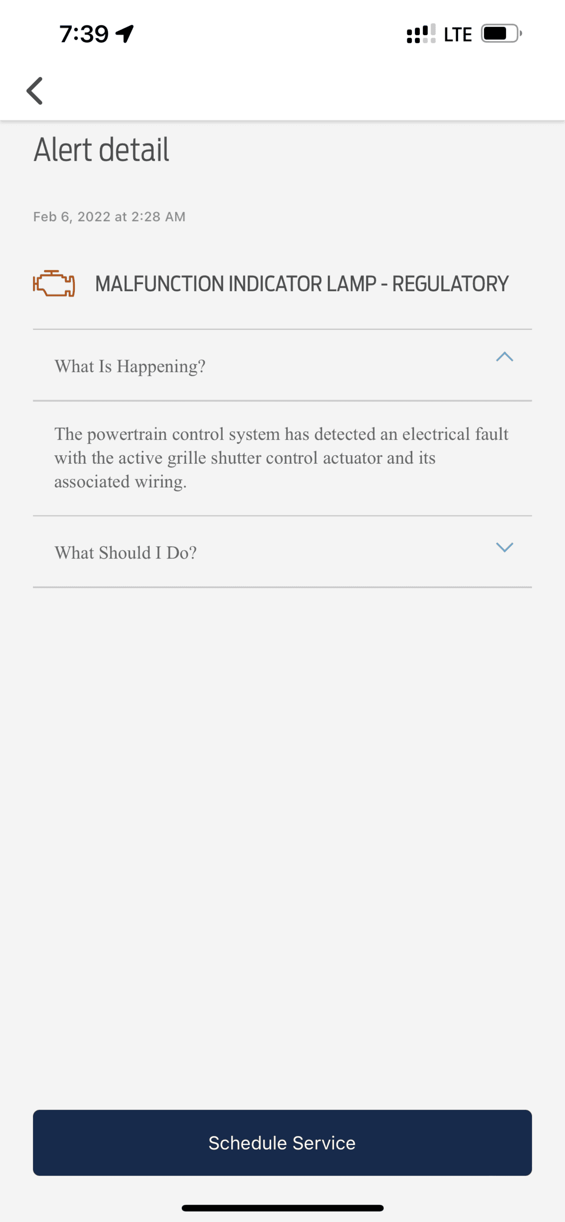

Have you got any FordPass notifications or has your door chime played through your steering column instead of the car speakers?
Didn't hear the door chime at the steering column, won't hear it through the speakers as I've got an amp installed and it won't turn on with that low of a load.
Charged the battery up for a bit and it started up, took it out for a drive to charge it up.
Ford pass has these alerts.

I've had a couple of the disable remote features, here's a couple, but I think I deleted 2.
Ford Maverick [UPDATE 3/22/22] Dead Hybrid Maverick at 1 month old after getting "Deep Sleep Mode" messages. [Possibly fixed by software update.] 8A8B86EC-2895-4D7A-9A47-8BC08E78F7B5
