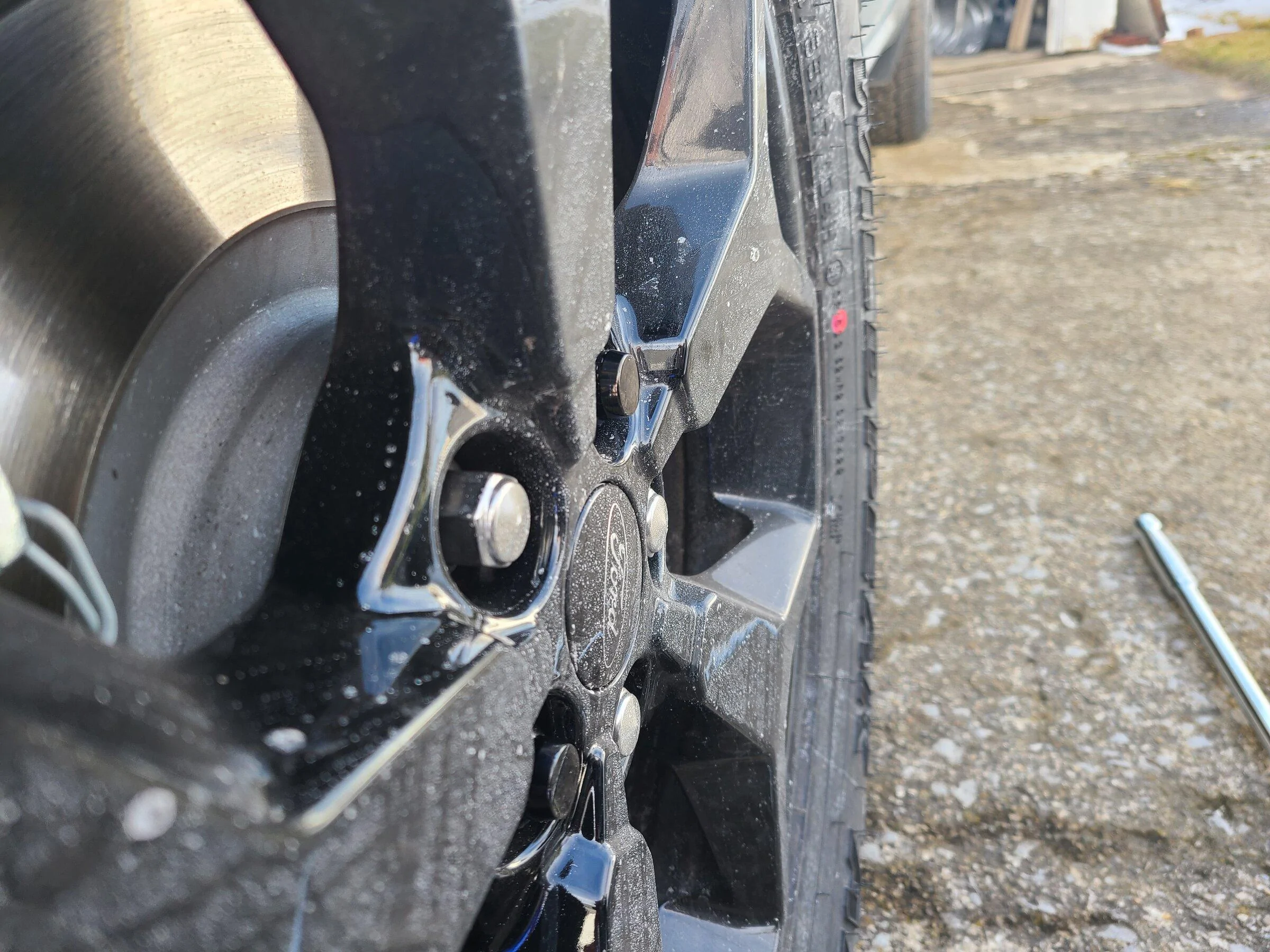

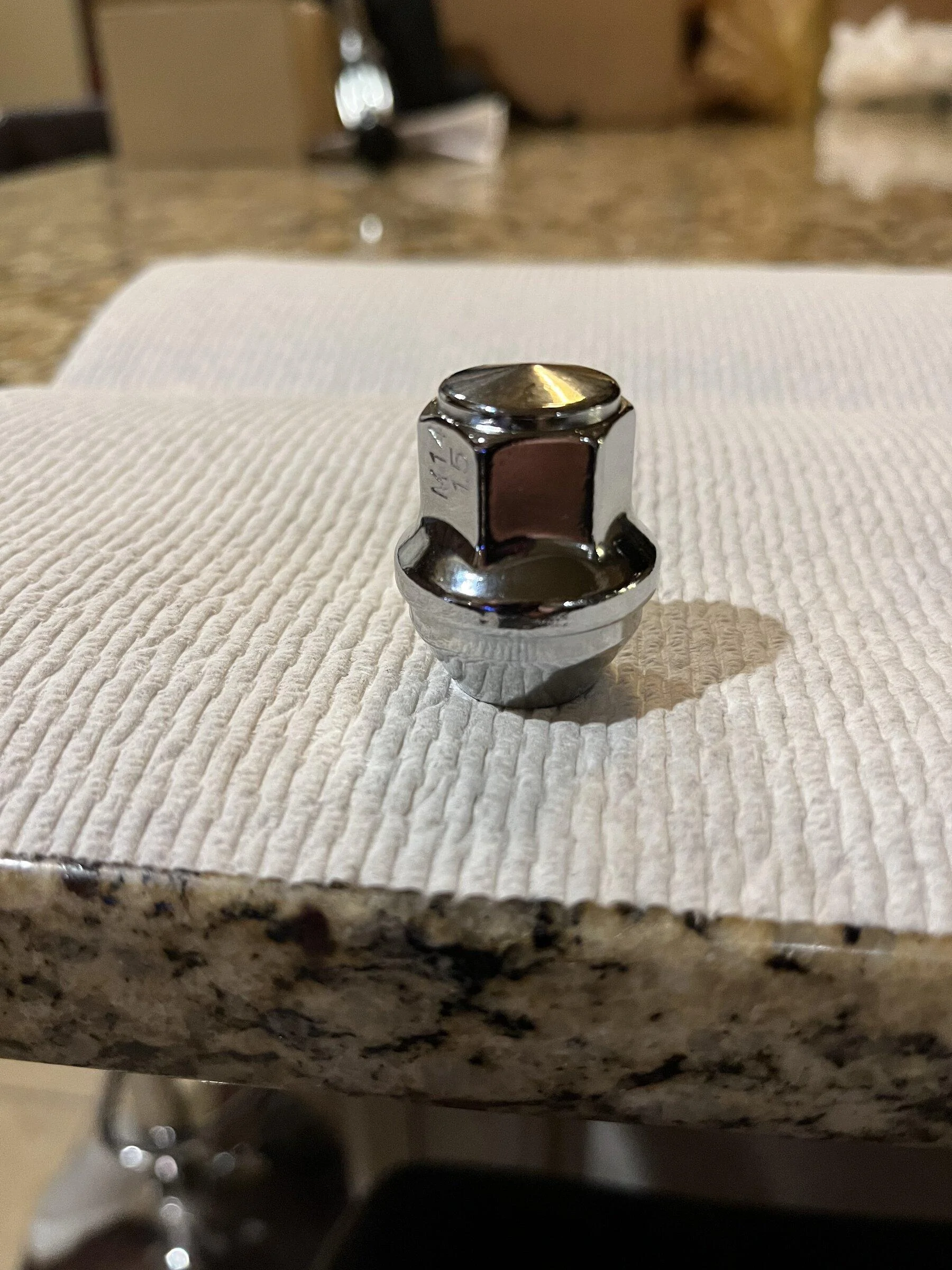

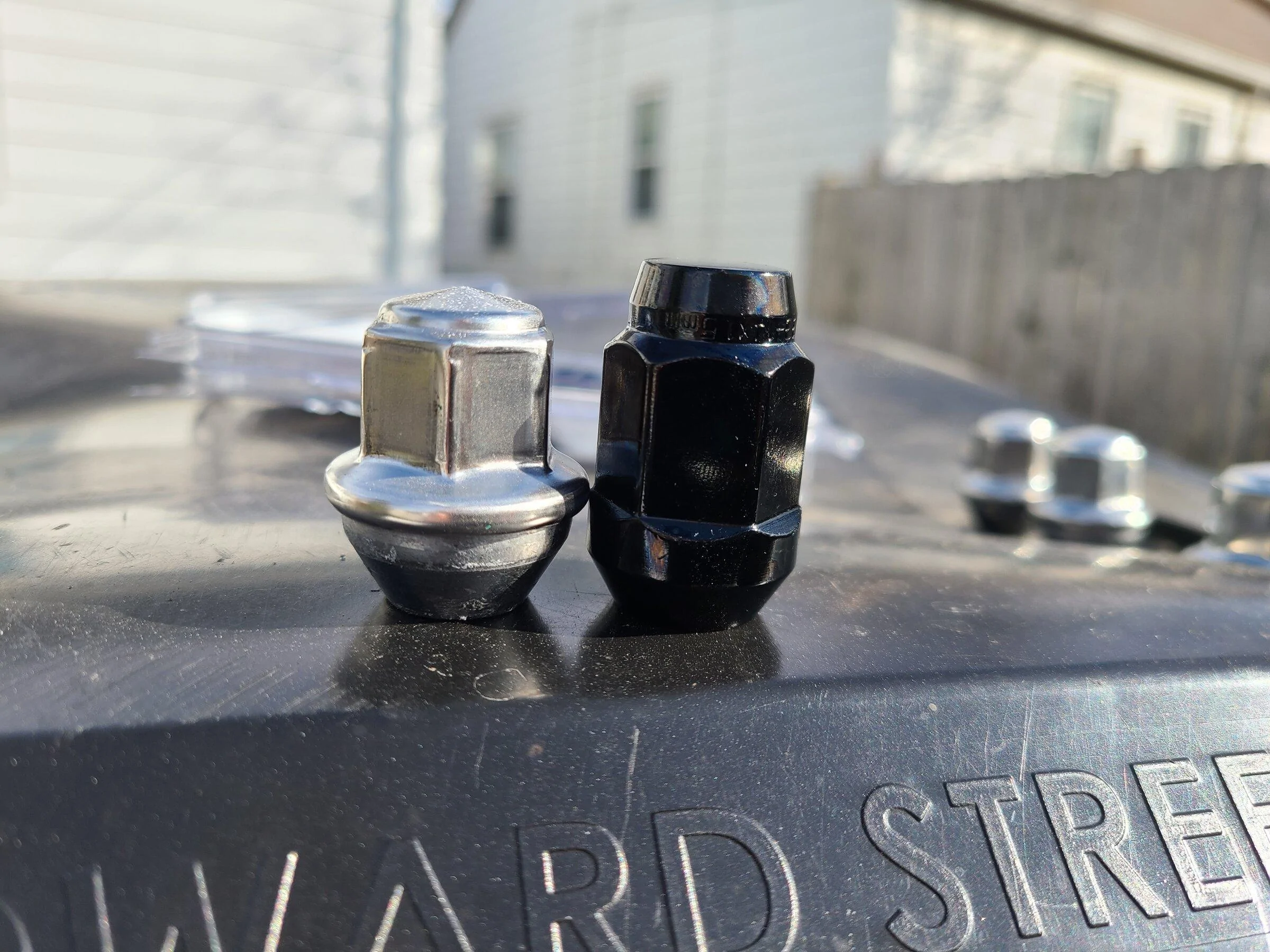

Just for info, I installed the below lug nuts on my Maverick recently and grabbed a few images to show the results. The first image is the overall difference in size, which is not much. The second is the box with part # for anyone wondering, and the third is an image showing them installed on a few studs compared to the OEM nuts. I opted for the 'longer' ones as I figured the extra purchase with a socked would be a good idea given the high torque spec.
As you can see the new nuts are only slightly longer installed and are still recessed from most of the wheel contours. Sorry for the dirty wheels 😑
