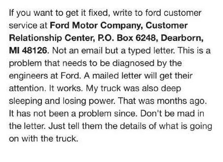

Ford Maverick Unexpected surprise with the Maverick Body Control Module Recall (24S27B) Write Directly to Ford
