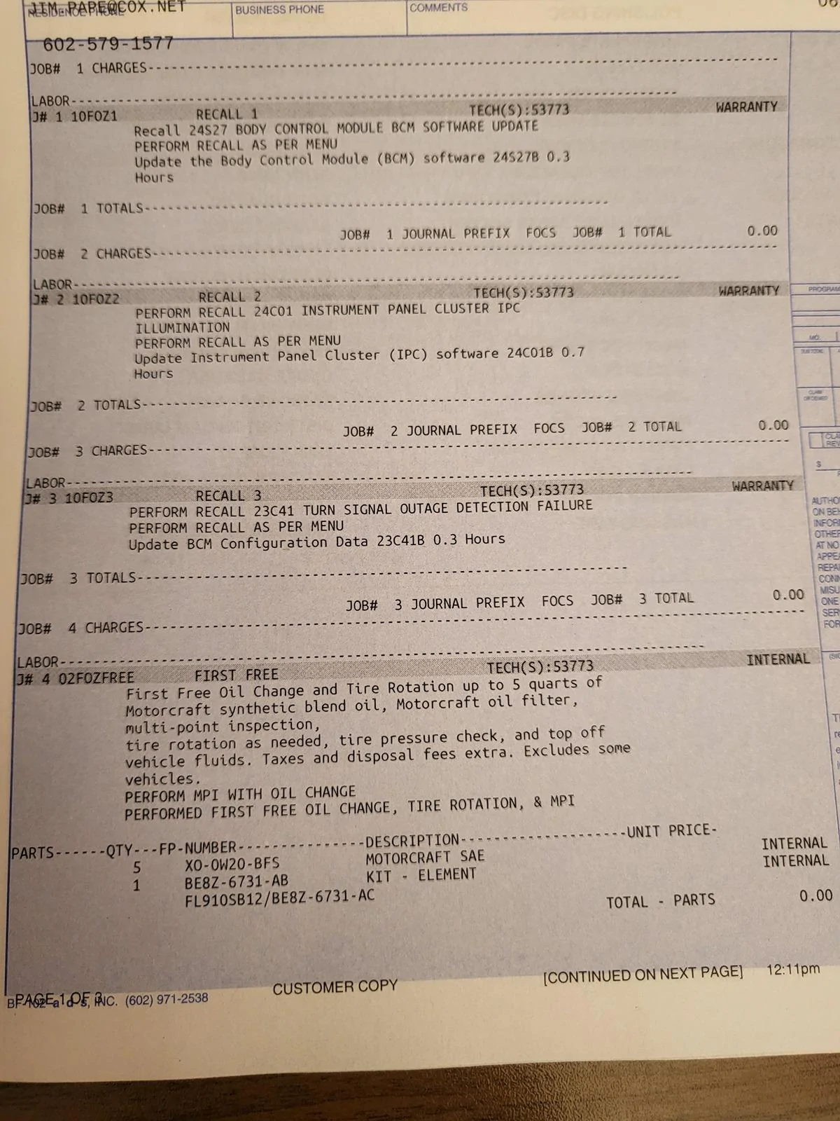

Hybrids get full synthetic, not the blend.
The invoice shows they put in XO-0W20-BFS full synthetic oil.
The mention of synthetic blend is language used for a free first oil change. They put in full synthetic at no extra charge.
