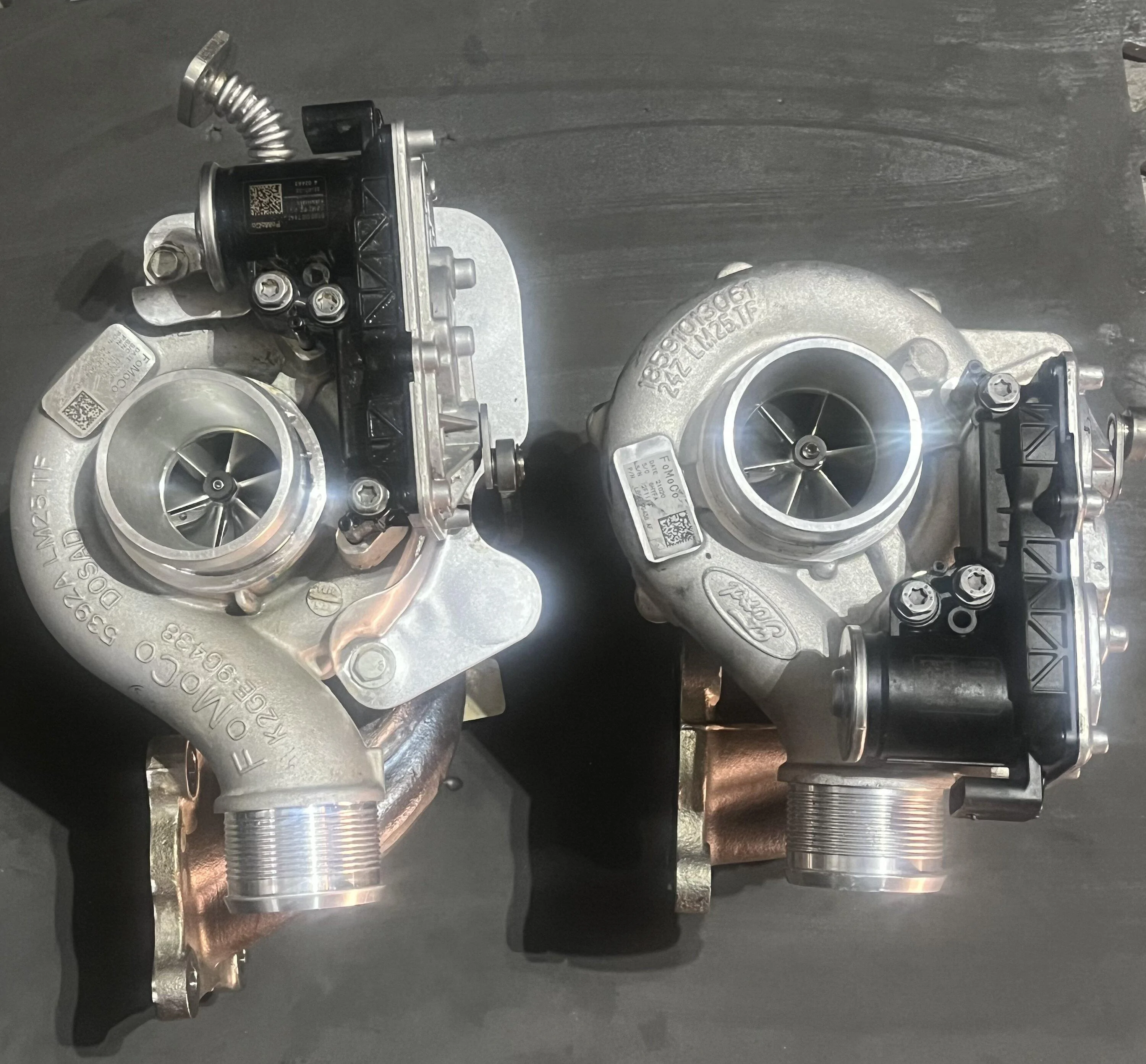

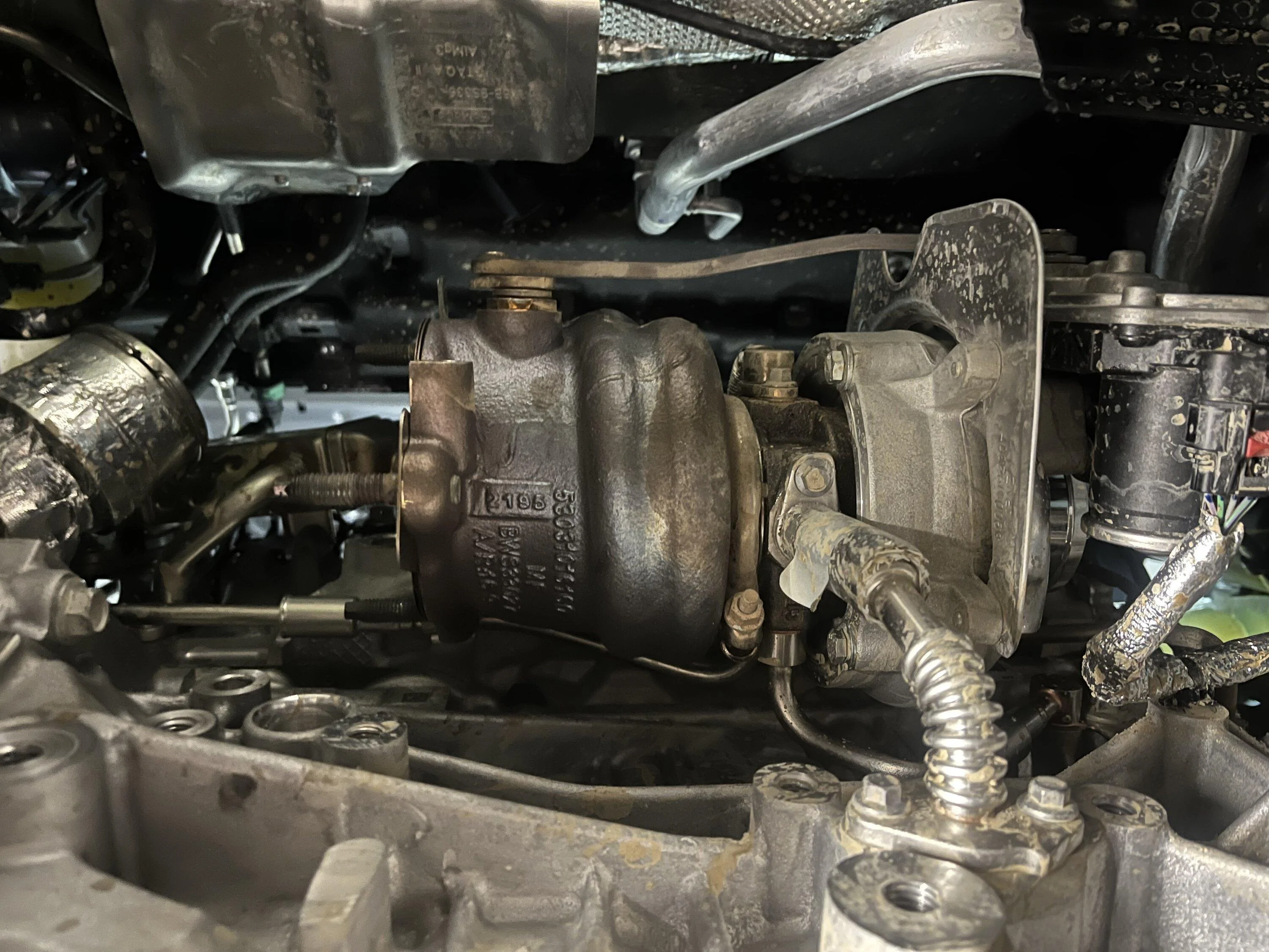

For anyone interested, removing the turbo is 100 times easier if you drop the transfer case. There’s so much room for activities!
There you have the stock turbo on the left and a Ranger 2.3 on the right. Next order of business is installing the Ranger and mocking up the downpipe. Once that’s done I’ll figure out the oil and coolant line length needed.

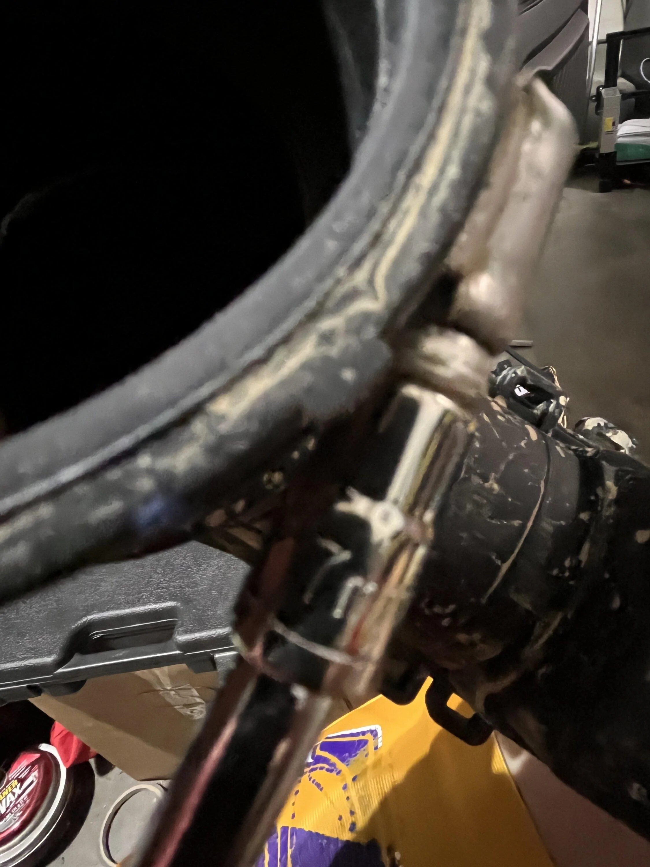

Not fully related but since you have removed the turbo you can probably help me if you have a moment. I was swapping the air intake tubing to a K&N, it was defective so when removing it a grommet accidentally fell down the air intake tube that goes back under/behind the engine. Does that lead directly to the turbo? Can that tube be removed from the top of the engine? Trying to get this grommet out and not having a lot of luck.
Fast Mavericks
Fast Mavericks
Ivan
Apr 26, 2022
85
459
2,375
2023 Lariat Eco AWD
disconnect intake from top and 7mm clamp on turbo inlet.
