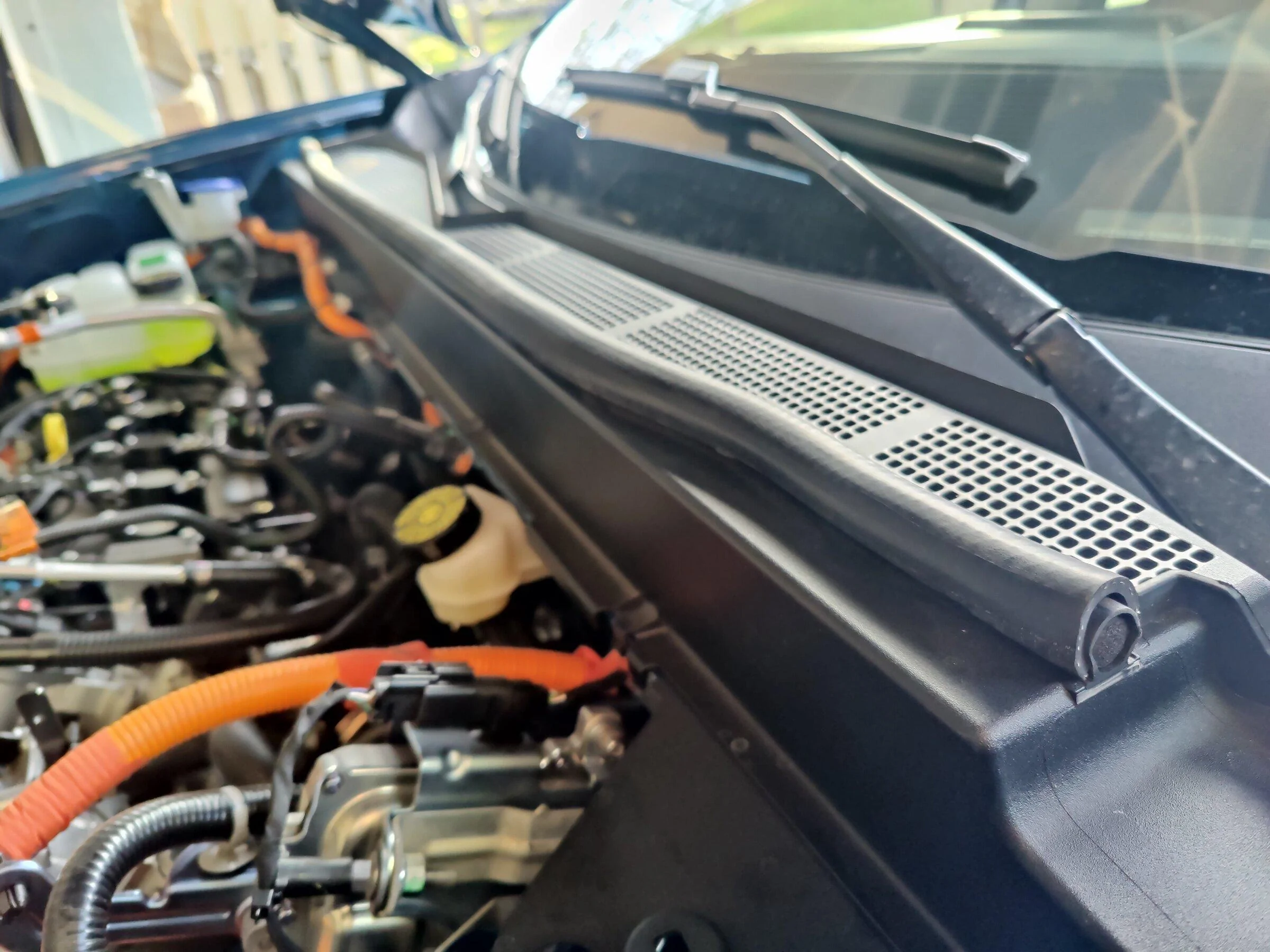

No adhesive, it just stays on due to the curve of the hose.Did you just lay is as pictured or did you fasten it some how (like with an adhesive)? Thanks.
Just lay it overDid you just lay is as pictured or did you fasten it some how (like with an adhesive)? Thanks.
Heater hose is stiff enough that just opening it to fit over existing stays pretty well.Did you just lay is as pictured in the fix above or did you fasten it some how (like with an adhesive)? Thanks
I installed this hose yesterday in preparation to installing the aeroskin II. Do you notice that it lifts up the corners of the hood closest to the windshield? For me it seems to have lifted up a bit and also makes unlatching the hood feel much stiffer/clunky.I just installed the Aeroskin 2 today, and it caused the hood flutter. Bought 4ft. of 1/2" heater hose for $8 at AutoZone. Split it lengthwise and put it over the rear hood seal.
Almost removed all the flutter at highway speed. Still a little but it's in the middle of the hood, more like flexing. Could have been there before and I didn't notice.
Just slightly. Doesn't bother me, and I'm pretty OCD about things. Seems to have lowered a bit after a month as well.I installed this hose yesterday in preparation to installing the aeroskin II. Do you notice that it lifts up the corners of the hood closest to the windshield? For me it seems to have lifted up a bit and also makes unlatching the hood feel much stiffer/clunky.
