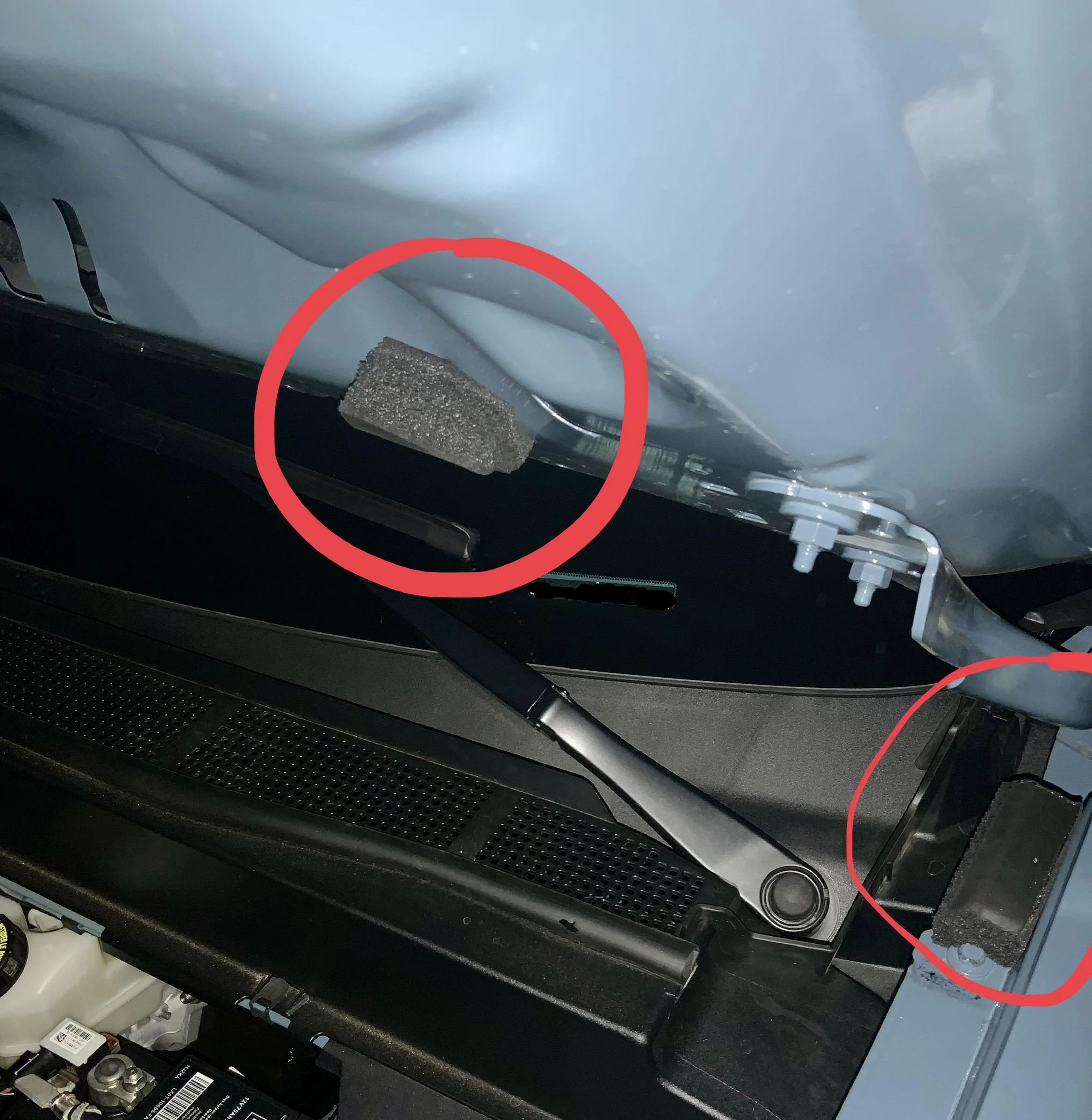

Good work and suggestion, thank you. Did you use an adhesive to make the fuel line stay in place?

I had no shake at all till I installed the bug deflector with the lip I took it off and no shake I ended up ordering the flat bug deflector and no problem at all. It seems like the problem is with the deflector but it looks like a good fix for it
This isn't me doing the "repair". He mentions in the comments that there was no adhesive needed.

Putting on a big gasket is actually a good idea, though I’d prefer something softer than fuel hose. Bet we see a bigger gasket in future year Maverick’s

I took a long trip and made several stops and adjustment on all 4 screws and same issue. finally I put this garage wall protector and what a difference it’s definitely a lot less shakes you can see very tiny movement I think I will just cut it longer to cover more. Got it in Amazon 4 piece.
