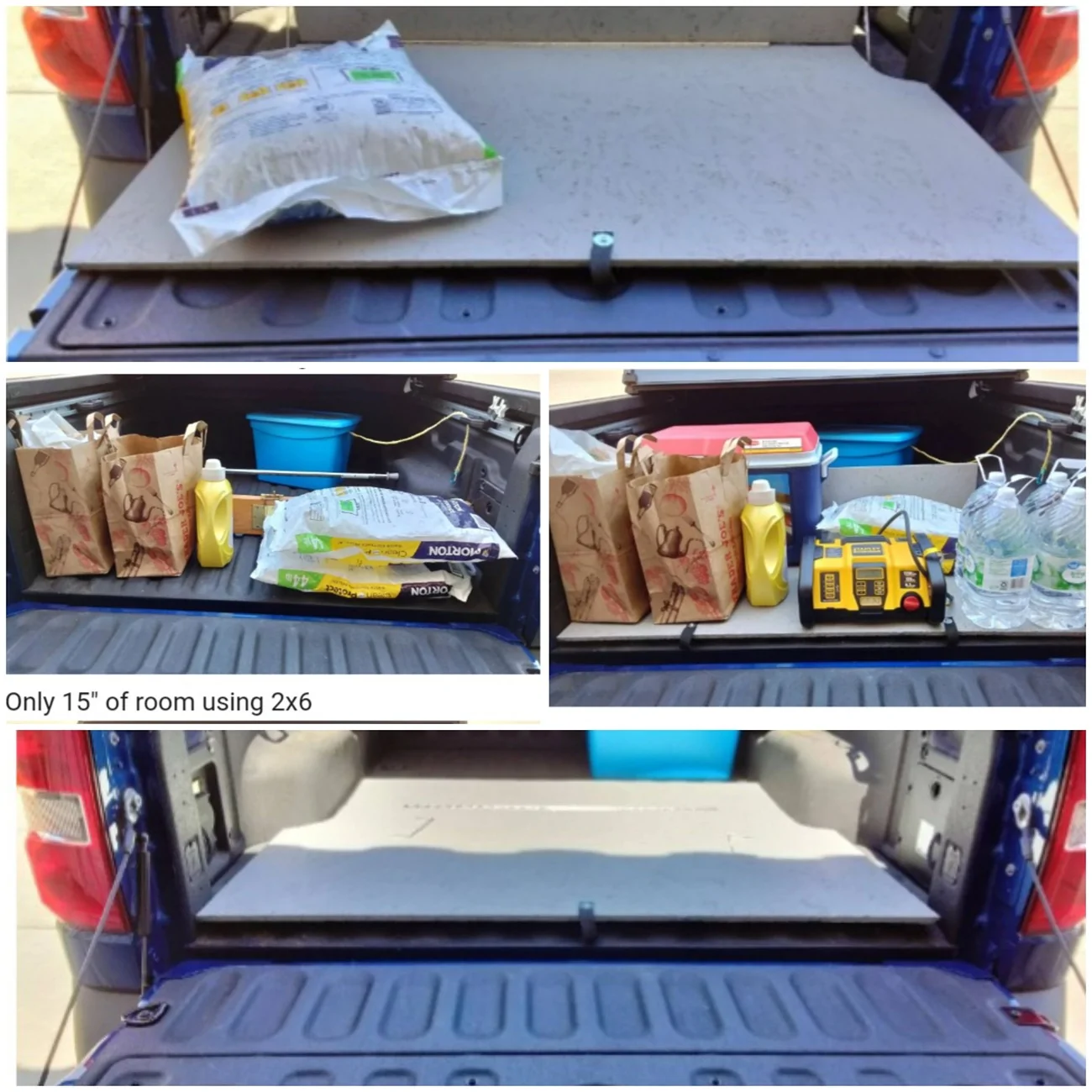

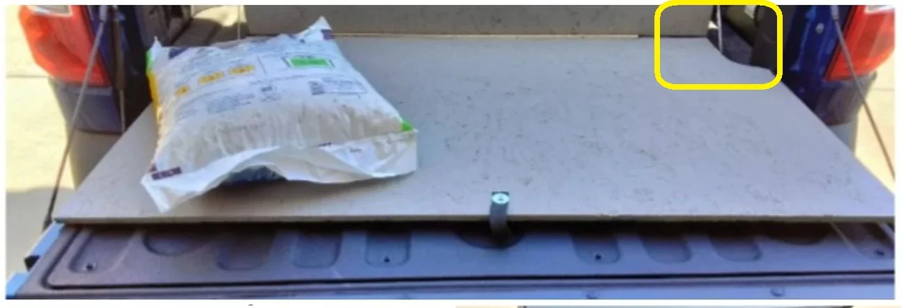

Using a 2x6 a 2x4 or 2x10 did not solve MY issue of too little room between the board and the tailgate.
. I found the 15" of storage space from the board to the tailgate to be inadequate for our shopping needs. My design gives 27 inches of storage area. The same area my wife's Escape has between the backseat and tailgate.
I didn't like having to bend across the tailgate in order to pull items out of the back. I can pull the whole tray to me once.
And if I need the full bed. I pull out the side brackets and the front portion lies down and I can use the whole bed and have nothing to store.
A lot more room and nothing rolls forward.

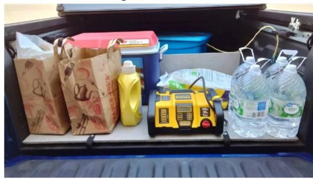

For me having just 15" of storage area between it and the tailgate wasn't enough. Especially if I pick up a couple bags of salt when we're grocery shopping.
When you compare these two pictures. You can see how much more I can put in that area and still have it secured from sliding to the front of the bed.
Unlike a pole nothing is going to slide under or OVER the rear divider. 👇👇
Ford Maverick Truck Box Divider 20260821_123430
👆🏻 50"×27" 👆🏻 or 👇🏻50"×15"👇🏻 of room.
Ford Maverick Truck Box Divider 20260821_123356

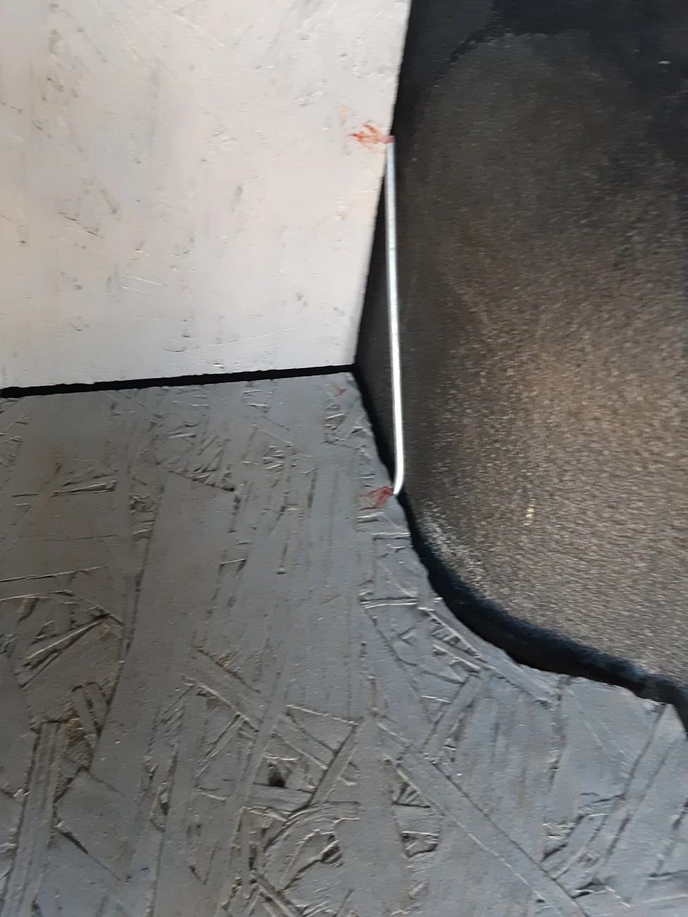

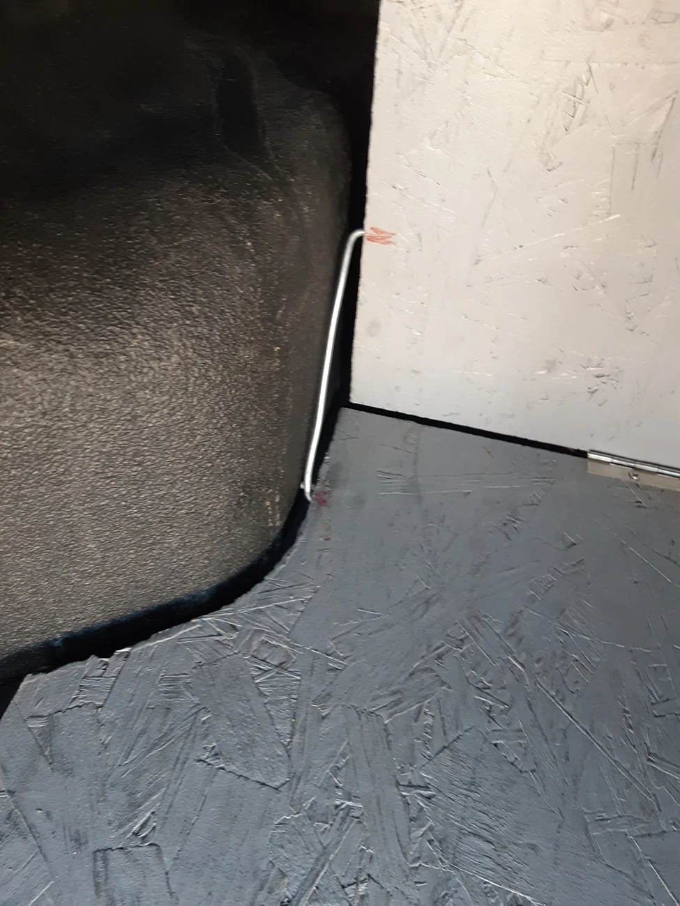

Any chance we can get a better view of these side brackets?
HRG
Of course.
I cut and used the metal frame from a discarded I think?🤐 election sign.
With the tray pushed all the way in the wheel wells brace the brackets.
When I want to fold it flat and I pull it out, then pull the brackets out and lay it down.
Simple and cheap.
As a matter of fact the paint I used was on the discounted racket Home Depot $5.
You can make it fancy by putting brackets on top of the wood that the metal would slide into. I didn't want anything to catch on when I wanted to use it flat.
Ford Maverick Truck Box Divider 20260821_125443
Ford Maverick Truck Box Divider 20260821_125449

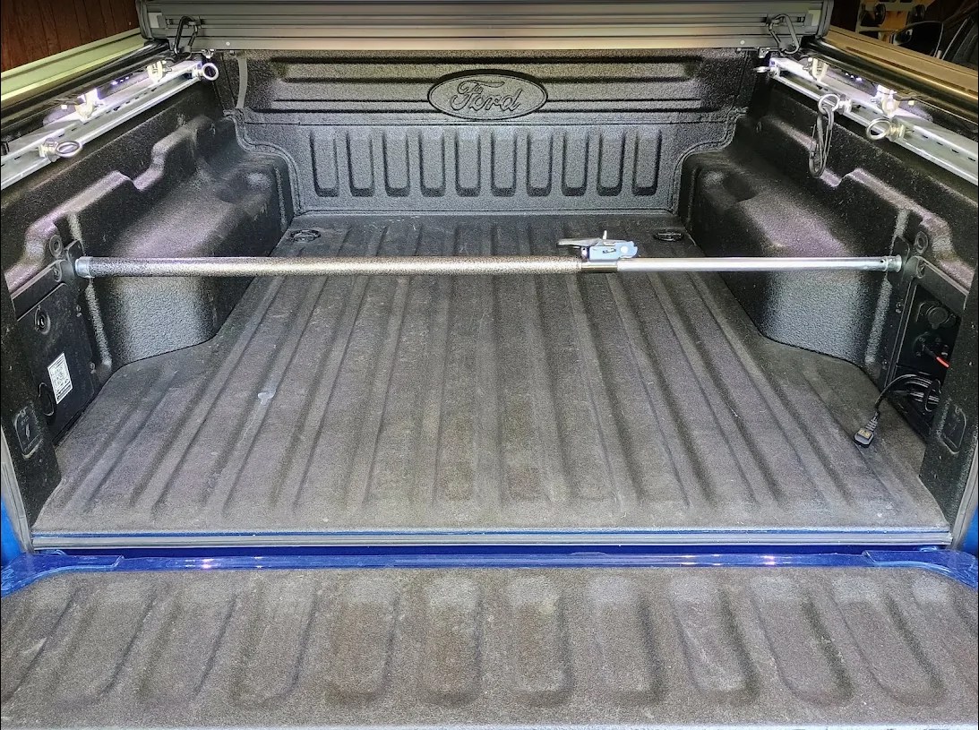

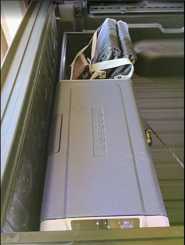

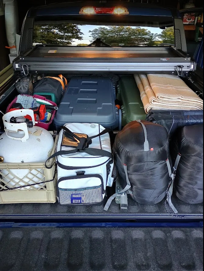

Ratcheting cargo bar:
Ford Maverick Truck Box Divider 1787582135155-j3

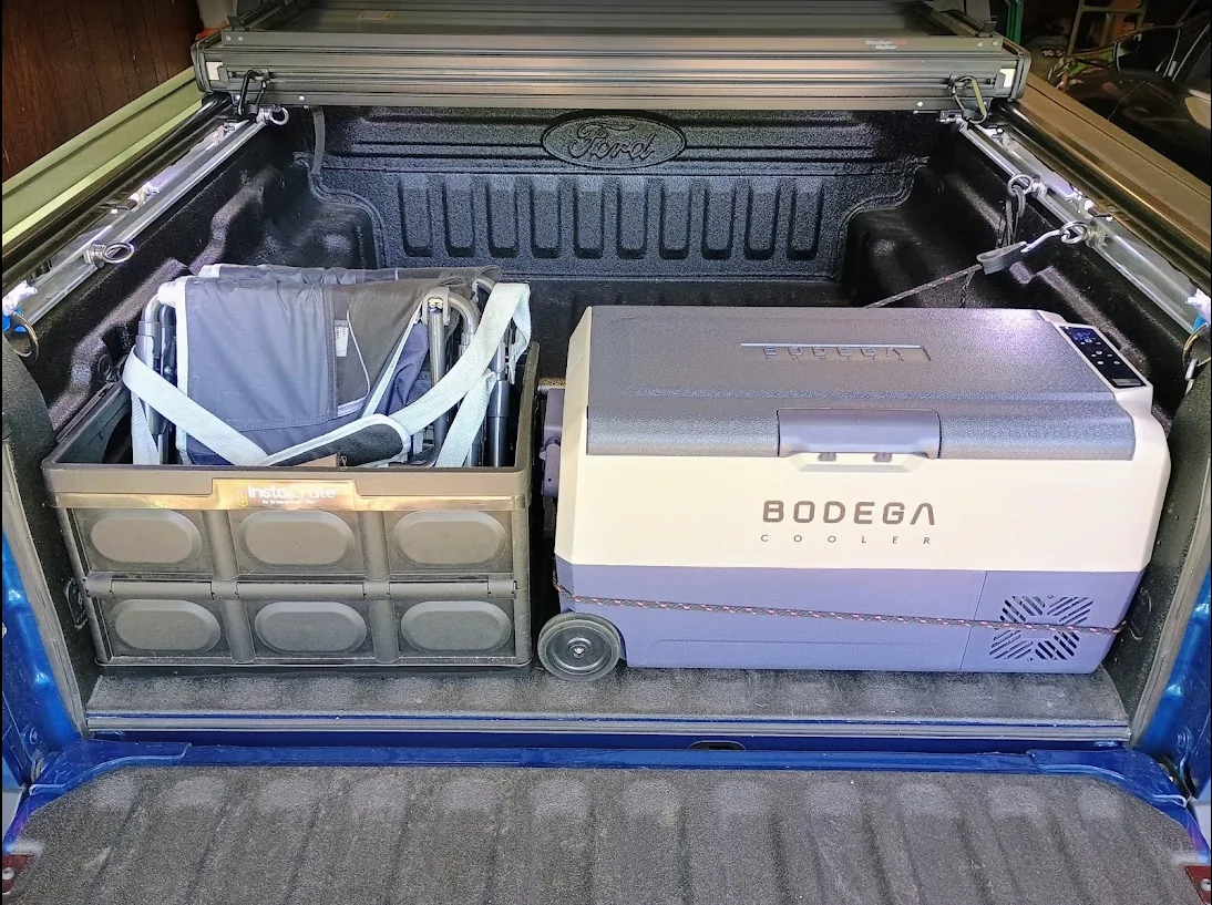

Cargo Bar with 3 Insta-Crates, one collapsed as a lid w/Rope Ratchet to secure crates:
Ford Maverick Truck Box Divider 1787582234182-9
Insta-Crate with 38qt. 12V fridge/freezer secured with Rope Ratchet:
Ford Maverick Truck Box Divider 1787582315876-zu
Ford Maverick Truck Box Divider 1787582405698-if
Ford Maverick Truck Box Divider 1787582372066-rq
Loaded for camping. 12V cooler strapped in to back seat with the dog (not pictured). Propane secured with Rope Ratchet. The two Plano rolling trunks fit perfectly between the cargo bar and the bulkhead :

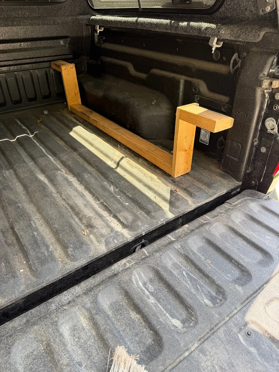

I am looking for a source for a Truck box divider for my 2026 Maverick. The only one I can find so far is from Ford but it requires you have some box divder ranck device. All I want is a light weight divider that will slide in to the existing slots in the truck box.
Thanks Doc
Ford Maverick Truck Box Divider IMG_5591
Ford Maverick Truck Box Divider IMG_5592
Paullamphear
Paul
Jun 22, 2023
23 Maverick Hybry
Thanks Doc
This homemade very easy to make and incredibly useful for all my tool boxes and purchases. I see one other respondent made same kind of setback sized for his/her bins.

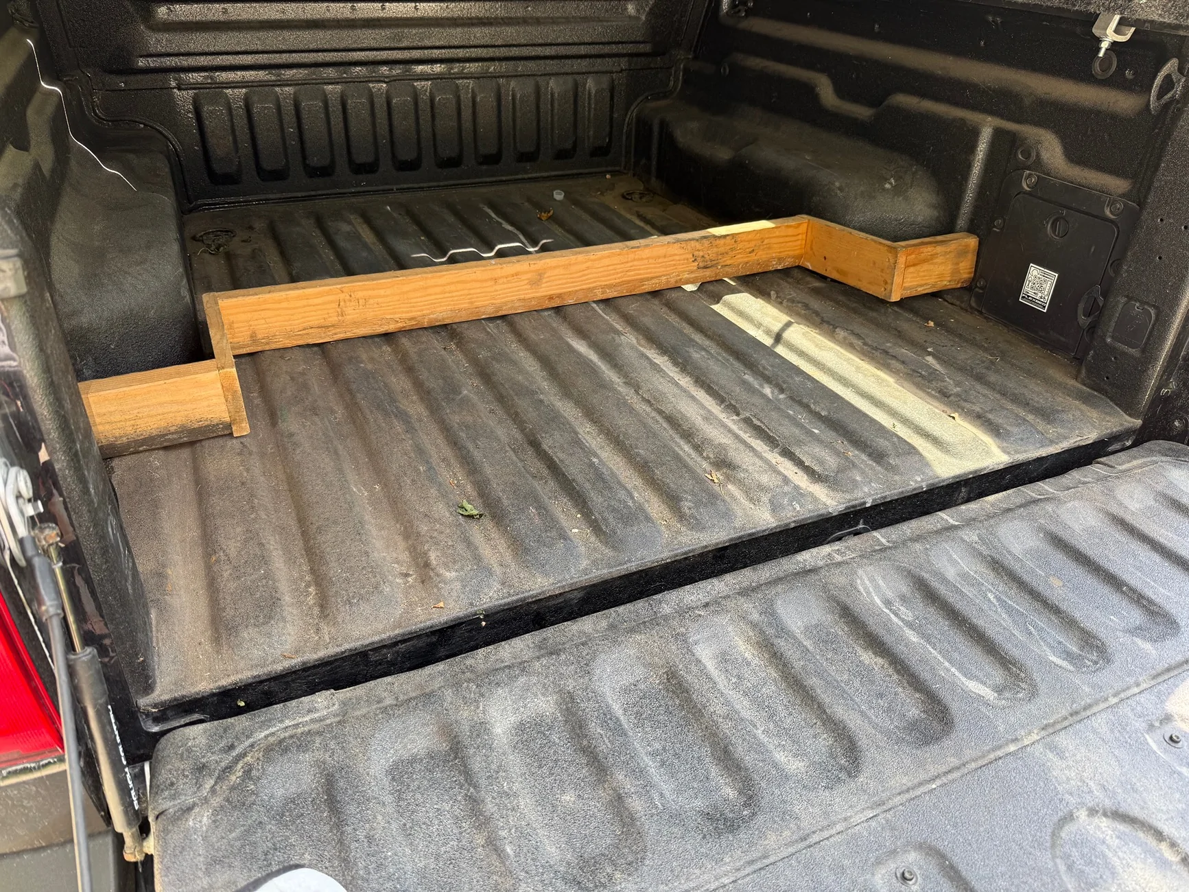

Heck, if all you want/need is a barrier between the wheelwells, just make a simple 3-sided one like this, that you could easily flip-over and place against the front wall.
HRG
Ford Maverick Truck Box Divider ag4a0638
