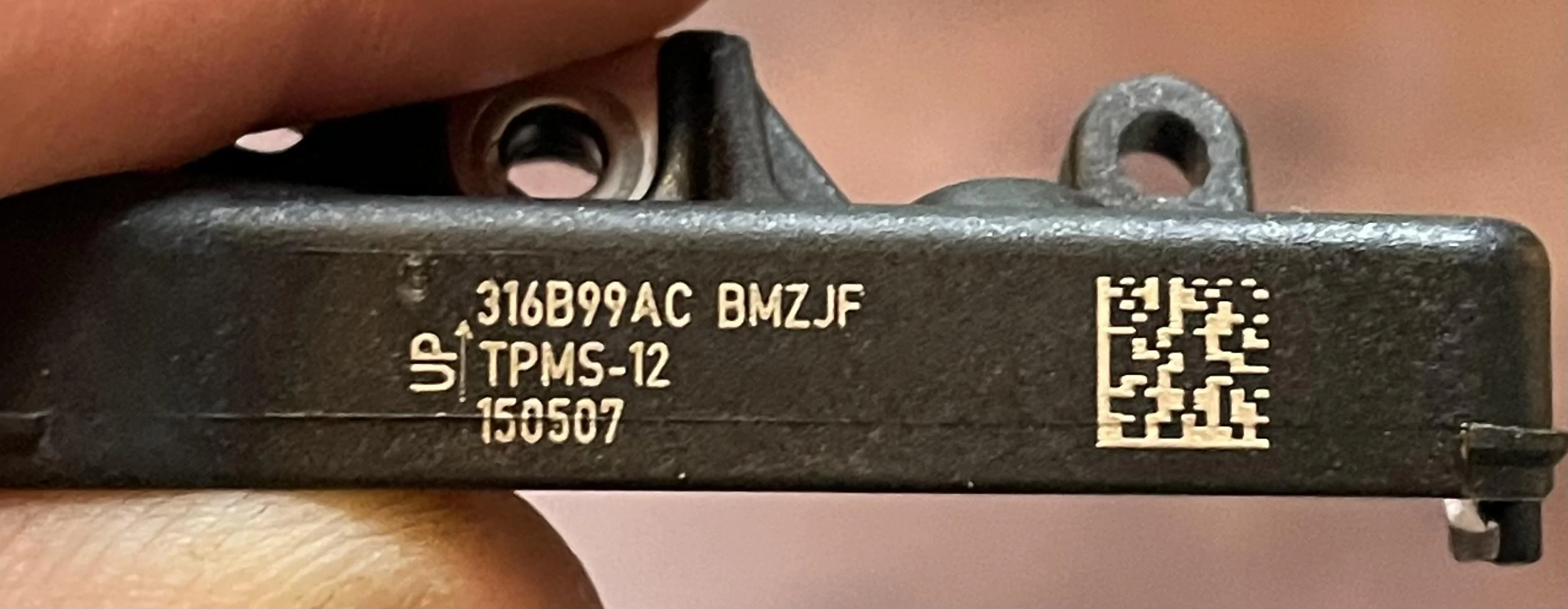

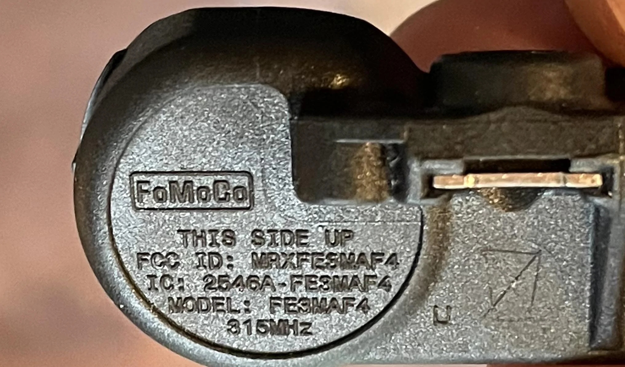

I have those sensor. Will they work on my ‘23 Maverick?

When I got new ones last month the tire shop needed the VIN number to get the right part number from the Ford dealer. There were various ones for the Maverick.

Cool. Well I bought the ones I mentioned and had them mounted on an Maverick that was produced right before they switched over to the 23 model year (mine was built in mid-November). They work just fine and "relearned" with ease.
So at the very least the dates you mentioned about a switchover from one frequency to another are incorrect. Ford is/was using 315 frequency for at least the entire 22 model year. I have no reason to believe they changed that for the 23 model year.

Who knows. But I can now provide another data point. I sold that 2022 and now have a 2023. Was able to take my aftermarket rims/tires/sensors off the 2022 and then easily relearn the same sensors onto the 2023. So the frequency is still 315 for 2023 model year. My 2023 was built in May. So not at the very beginning or very end of the production year.

As far as I know, there are only 2 frequencies for TPMS, 315MHz and 433MHz., the only difference is the mounting fixture for the specific rim. You also do not need a tool to program them to your car anymore (as in previous years). Your Maverick should pick them up automatically. Store your spare rims a distance away from where your truck is normally parked, I've read the truck can pick up the signals and give problems in the readout.
