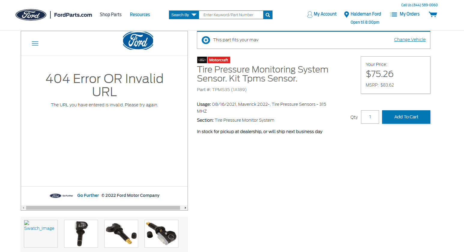

I have wheels and tires from 22 and they work. They are 315hz sensors. The sensors are $60 from Ford. The TPMS kit for 4 sensors are TMPS35. If you check, they are good for 22 and 23. So I call BS on them trying to sell you sensors. I put 23 maverick using my vin in this search and it provided this below. So I call bs.
Ford Maverick TPMS sensors are model year specific? 1675098836349

I work in a Ford Parts Dept. Just Checked this 23MY (3FTTW8F91PRA04374). It has 315mhz sensors.
Ford Maverick TPMS sensors are model year specific? 23 Mav
