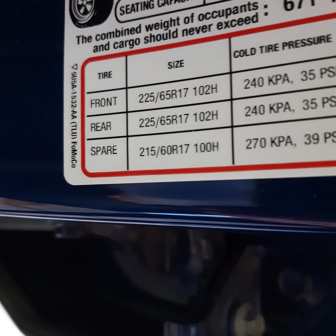

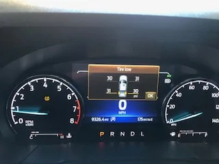

Wouldn't a warm tire pressures of 30 and 31 be considered low?
Wouldn't that put his cold tire pressure around 26-28 psi ?
Ugh - I couldn't get picture to enlarge enough to read them. Well, without downloading it.
Not malfunctioning at all.

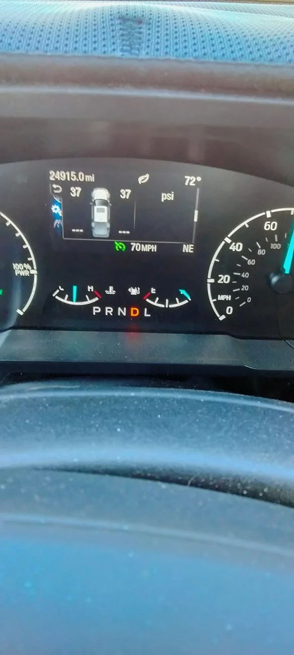

Thank you for posting the picture.
Picture of dashboard
It showed me everything I needed to know.
I'm glad it was only air that was needed. 👍🏻👍🏻

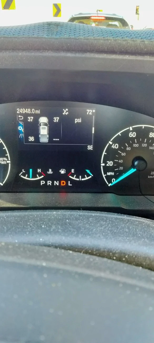

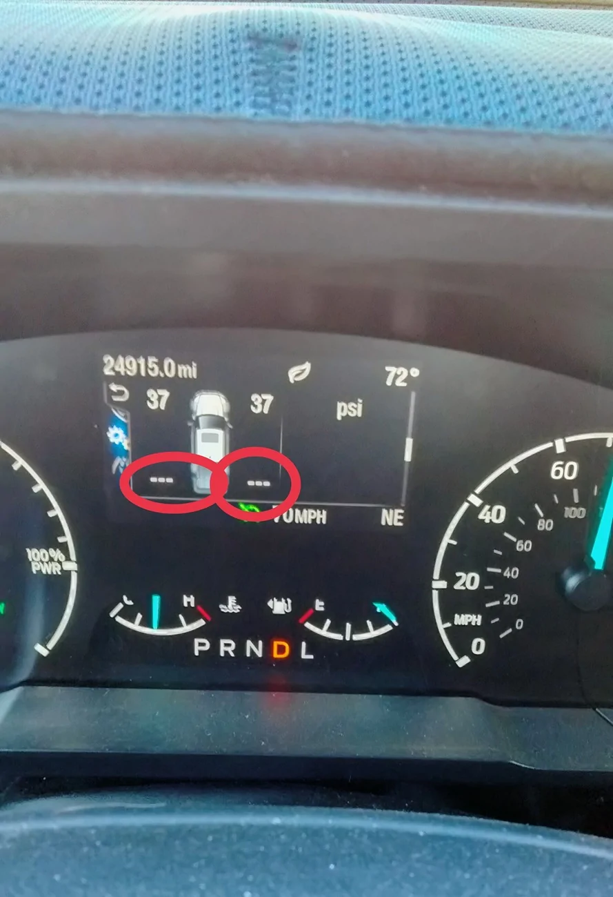

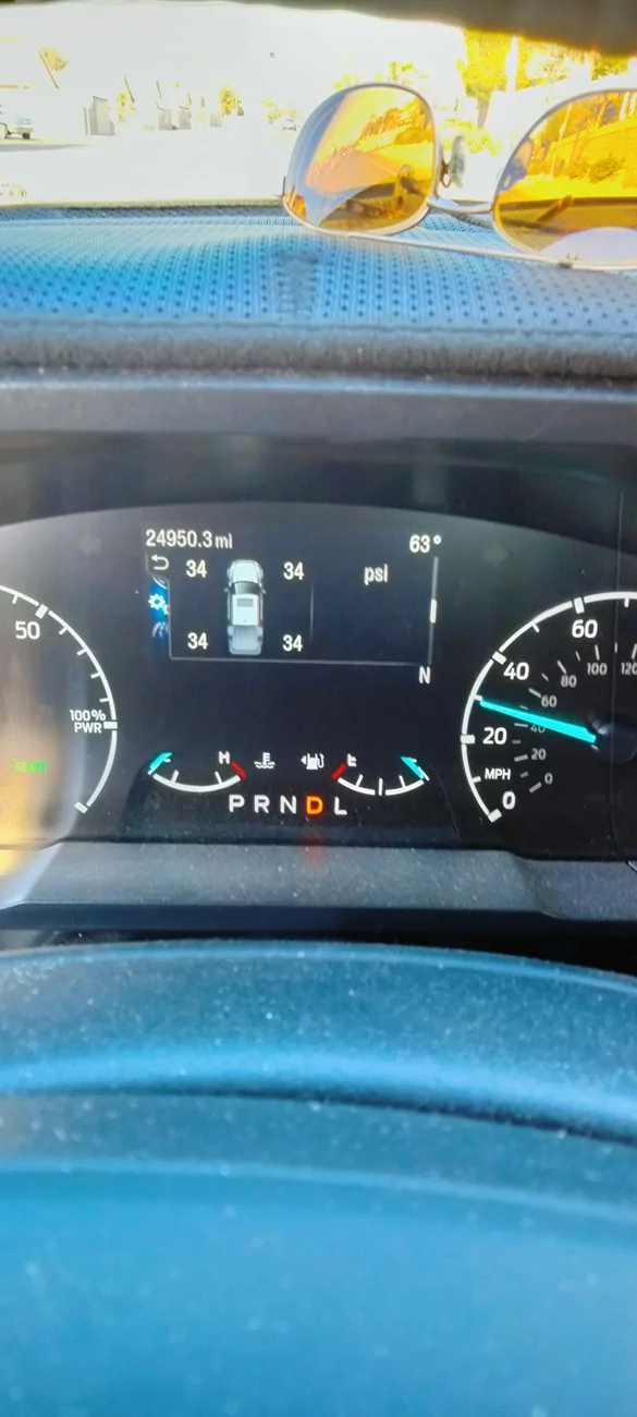

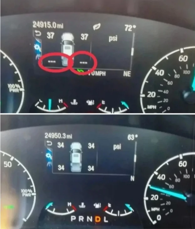

Remember, if you ever get a no-read/ meaning a blank for one of your sensors. See my picture below 👇🏻
It doesn't necessarily mean that the sensor is bad, especially during the first five years.
Most jump to the conclusion the sensor is bad. That's not necessarily correct.
Ford Maverick TPMS problem 20260930_063849
As you can see 35 miles later and the next morning they are back working.🤷‍♂️
