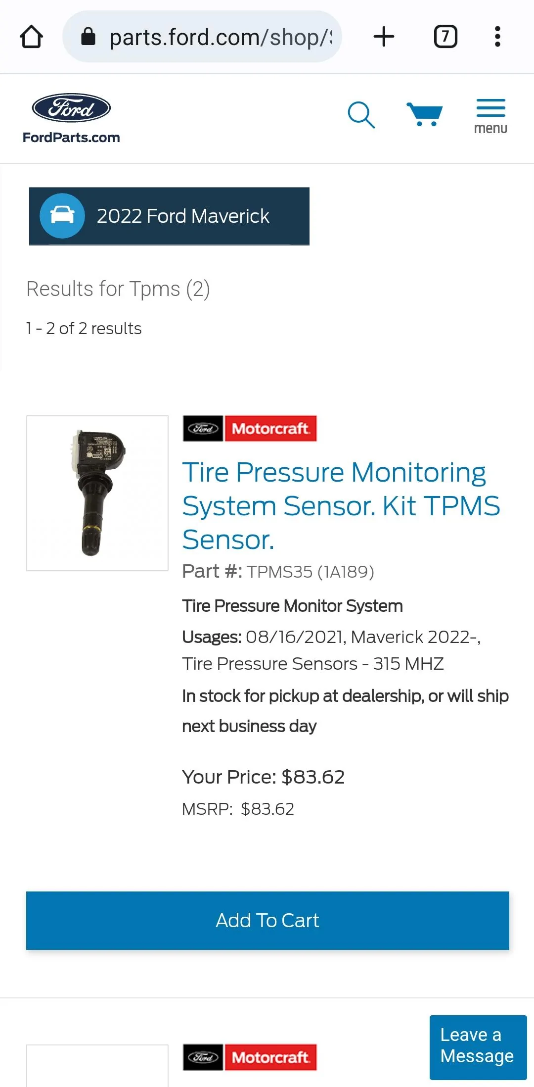

Can confirm 315. Motorcraft OEM parts site will say the same if you search for Maverick TPMS. If you want OEM, you can find them on Amazon if you don't want to deal with a dealership.
Ford Maverick Tpms htz Screenshot_20221013-163710_Chrom

I just called TPMS.com and they said the 315mhz sensors will work. Mine have a ford part# F2GT-1A180-AB. The 433mhz is for monitoring trailers being towed by a ford vehicle.
