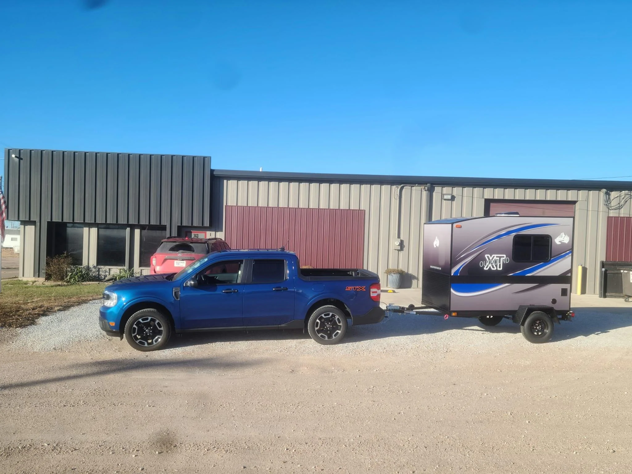

It's probably closer to 8x7 so 56 sq ft but it's not a flat front..

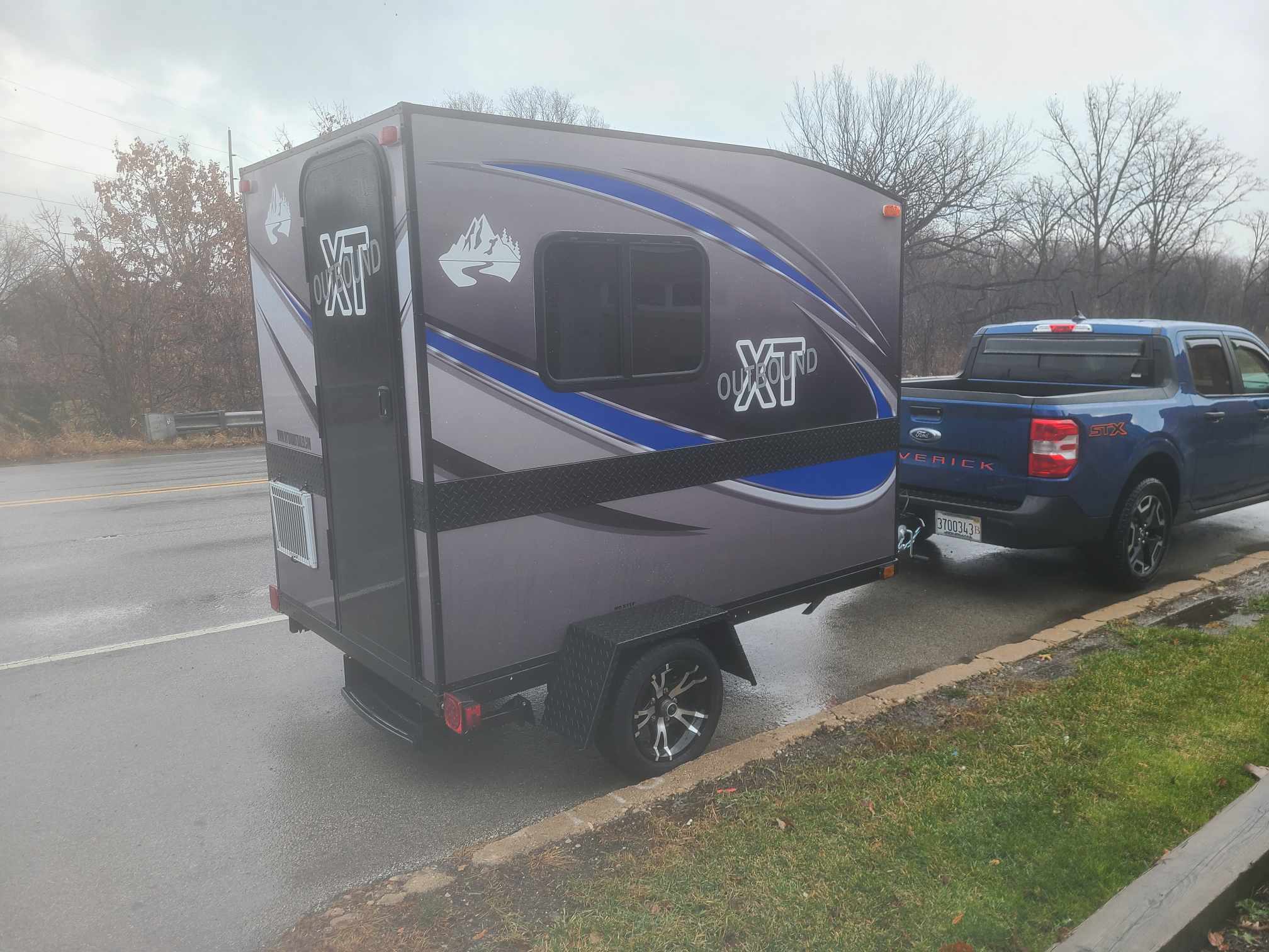

A V nose is calculated the same way. They claim even the V nose has very little change in drag. It's more in our mind. You can help by installing a Higher than cab height topper when towing. My trailer has a frontal area of 5'X5' which is over by 5 sq ft on the hybrid. I have done 2 things to help minimize the effects. I lowered the trailer 6", and bought a flated High top topper to redirect air away from the truck bed.
Camper as purchased:
Ford Maverick Towing 4,000lbs? MavwithOutboundXT
Dropped, but before new drop hitch:
Ford Maverick Towing 4,000lbs? XTdropped
Topper to help direct air around trailer.
Ford Maverick Towing 4,000lbs? Flated
