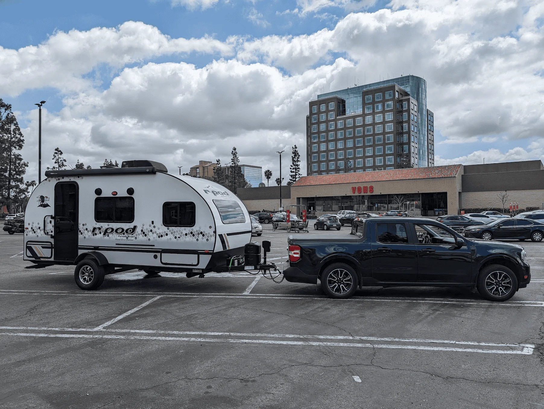

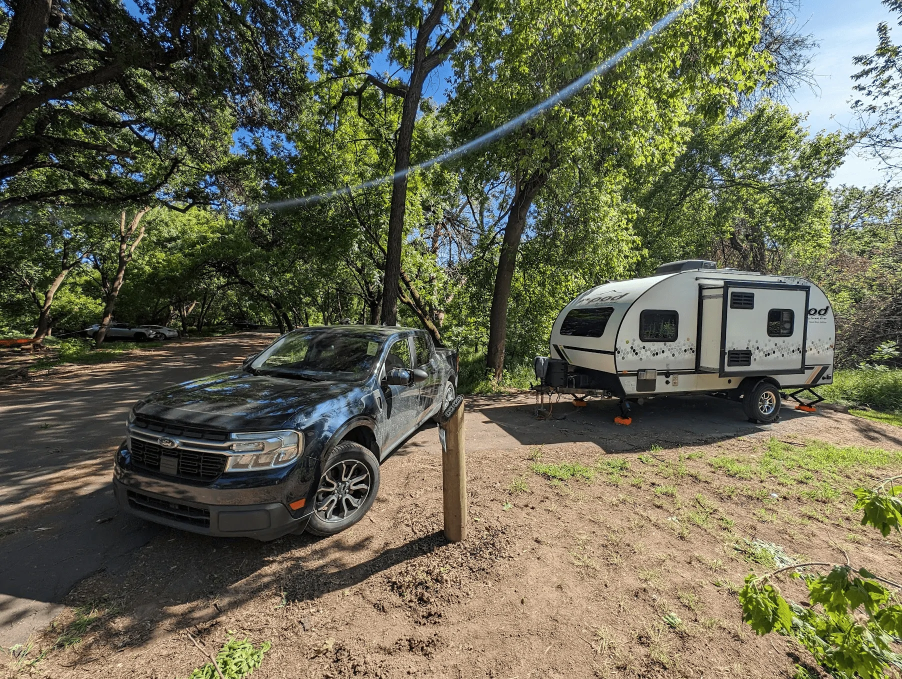

I use my 2021 EB-4k Maverick to tow a 2021 R-pod 180 that's an 18' trailer with a 20' frame (shout out to @McBear who has the same model). It weights ~2,900 dry and is 3,500 - 4,000 with gear & water. I did weigh it on a CAT scale and was ~100 lbs over the GCWR with all the gear/people I had in the truck (more on that below).

1st- Power
The mav tows like a dream! I can't believe how well a 2.0 L can pull this trailer, even up hills. The r-pod design goes a long way limiting drag (it's narrow and has a curved front/back), but the engine seems to have plenty of power to get the job done. You'll definitely want to run it in tow mode, but I have everything I need to merge onto the freeway, pull up steep hills, and even on uneven dirt roads.
I normally get 15 mpg over an entire trip (which is crazy good MPG for towing a trailer), and got 18 going over the grapevine in socal (@40 mph with traffic).
The engine has never changed the temp on the dash (mine is always at 4 bars), but I don't have additional sensors to check the actual temps or in the transmission.
For what it's worth, I also try to keep the truck close to 60 mph

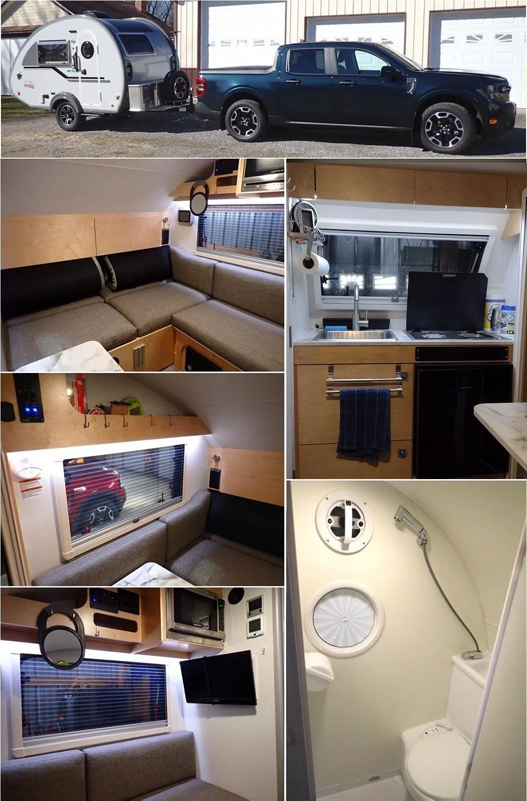

The Mav doesn't have any problem pulling the 320. If you keep at least 10% of the trailer weight on the hitch you shouldn't have any trailer sway from normal highway driving and passing trucks so no sway bar needed. If you're traveling out West with heavy cross winds and you're getting sway, get off the road.
I Keep it at 65 or under and average 18-19 MPG. I get about a mile more per gallon with the canoes on top of the MAV. Must break up some of the air hitting the front of the trailer.
If you do wind up getting the T@B 320S I have several mods I've done to our 2021. Some are listed here:

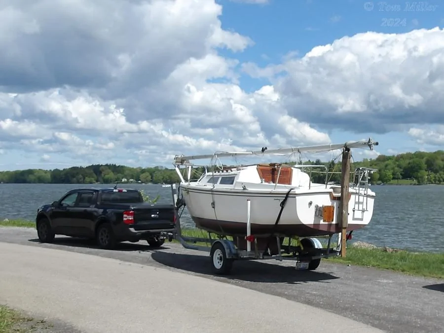

I've towed my Catalina 22 sailboat ~3500 lbs with my 2.0L and 4K package. It includes a beefed up cooling system for engine and tranny. It also has a higher final drive ratio. It towed very nicely but most of my 35 mile drive is pretty flat and 55MPH. Gas mileage? fuggeda boud it.
