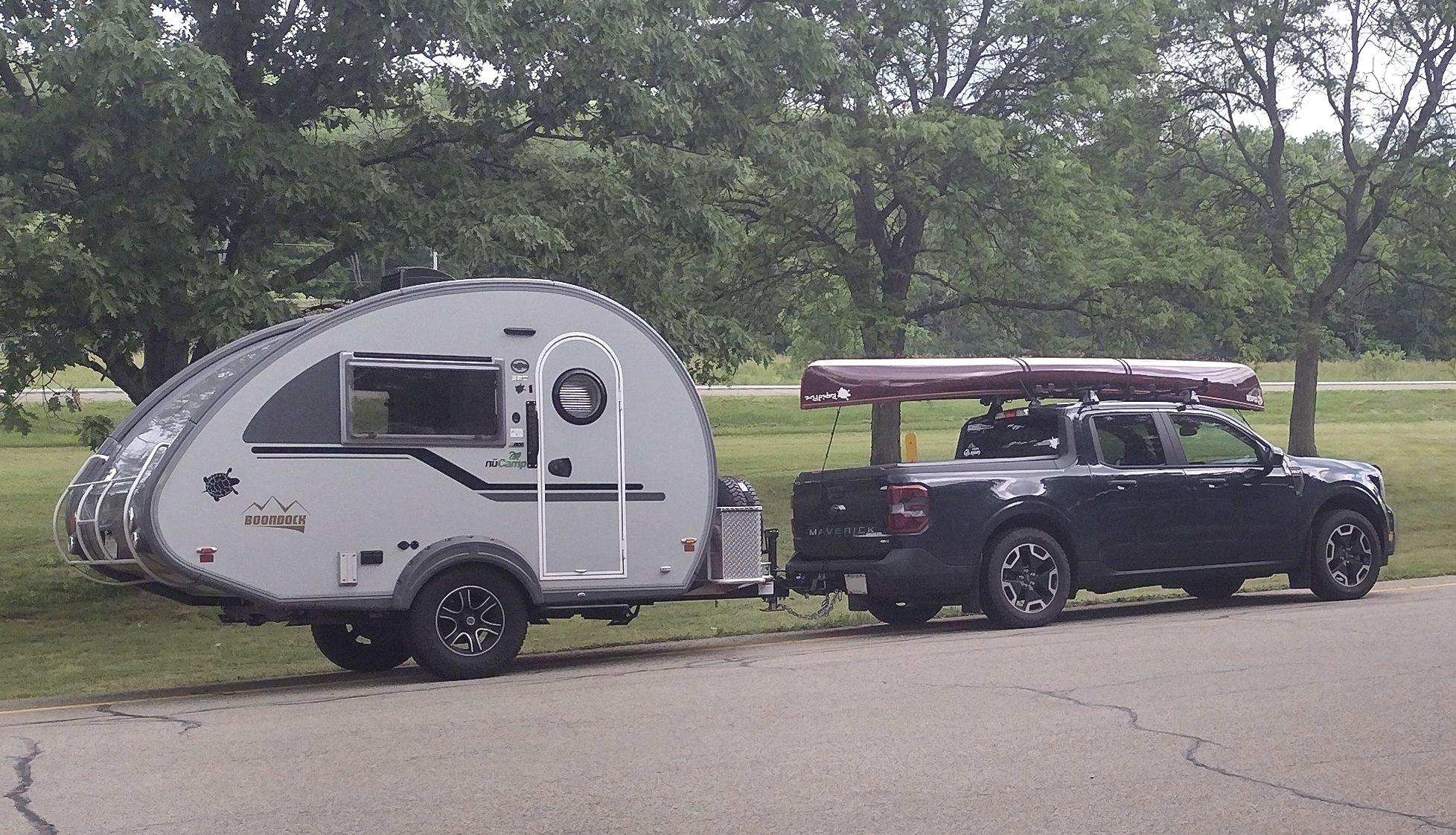

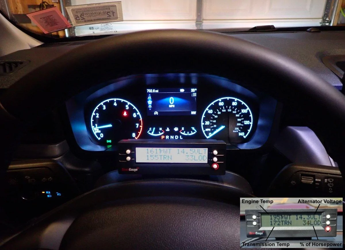

If you're nearing the towing limit, I'd say anything over 3,000 pounds, or you're towing in the mountains, I'd put a Scangauge on it so you can monitor the transmission temp, engine temp and the percent of horsepower you're using.
I tow a 2,500 pound (loaded) camper with the MAV/4K tow package and don't have a problem but if I was towing close to 4,000 pounds in the hills I'd go with something with a higher towing capacity.
Ford Maverick Towing 4,000lbs? Scangauge II notes
Ford Maverick Towing 4,000lbs? Mav boat Tab
ScanGauge or ODBII scanner of some sort is basically a must-have while towing if you ask me. It was the first thing I added to my truck at 1 month of ownership. Then came the 7-pin and brake controller.
With up to 70 values to monitor, I know just what my truck can do. In the mountains. Towing. On a 100 degree day.

I've got a'24 EcoBoost FX4 4K and am contemplating the T@b 320S. I'd be interested in learning more about your experience pulling this rig. It seems like a perfect pairing for the Maverick. I'm appreciative of any information you can share.
