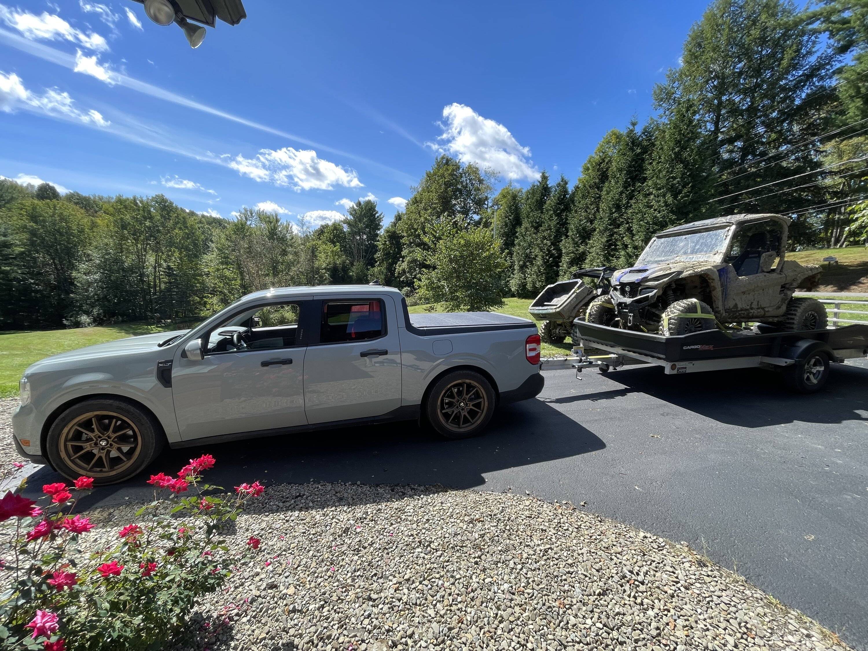

PA law is 3001lbs or tandem axles for brakes. Load CAP on my trailer is 2990lbs, so no brake requirement.
I'm not claiming I shouldn't need trailer brakes, but I used what resources I had with no issues.
