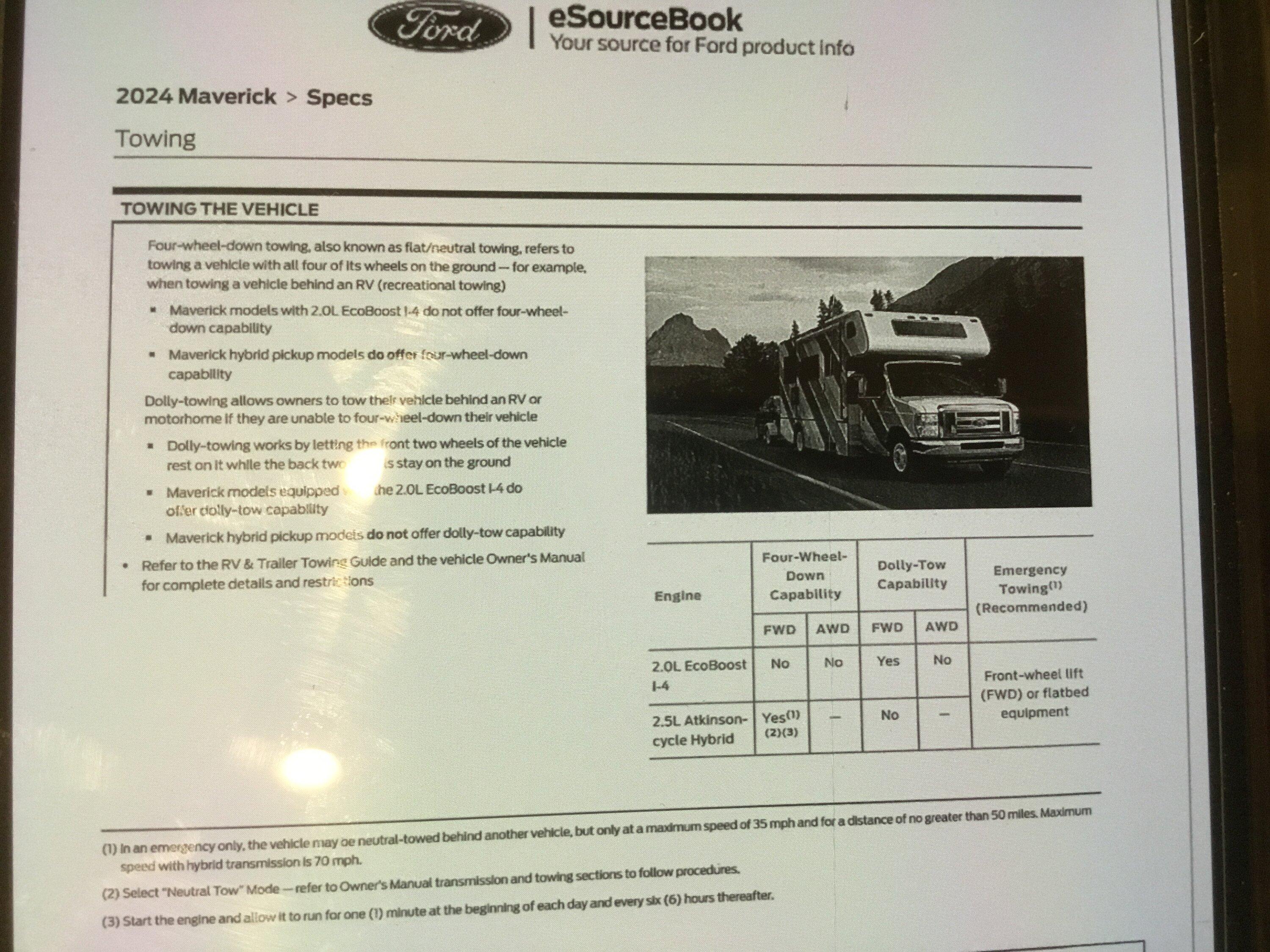

This is what Ford is saying about the 2024 maverick hybrid. any thoughts?

We just returned from our first camping trip with our Hybrid Maverick in tow.
We towed it on our dolly with the truck turned off, e-brake turned off, not in tow mode.
When I got into the truck for the first time, I was greeted with a barrage of error messages. Anything from E-Brake fault over antilock brake fault to pre-collision assist not available. ABS light is on too.
After driving a few yards everything resets and the truck acts normal again.
Anyone here that might have an idea what is going on?
I flat tow my 2023 hybrid with NO issues. Just put in Neutral tow. Gone on 3 trips with traveling over 700 mile. I use Blue Ox equipment and swapped out lower valance FX4 bumper.
When we got the Maverick, there was no tow kit available yet. We transferred to 4 down in September of 2022. Roadmaster to be precise. It worked well for many miles. Well, until a dealership in Reno crashed the truck. We now tow a 2023 Ford Ranger. That thing got us into places, the Maverick would have never gone. Gas mileage sucks though.

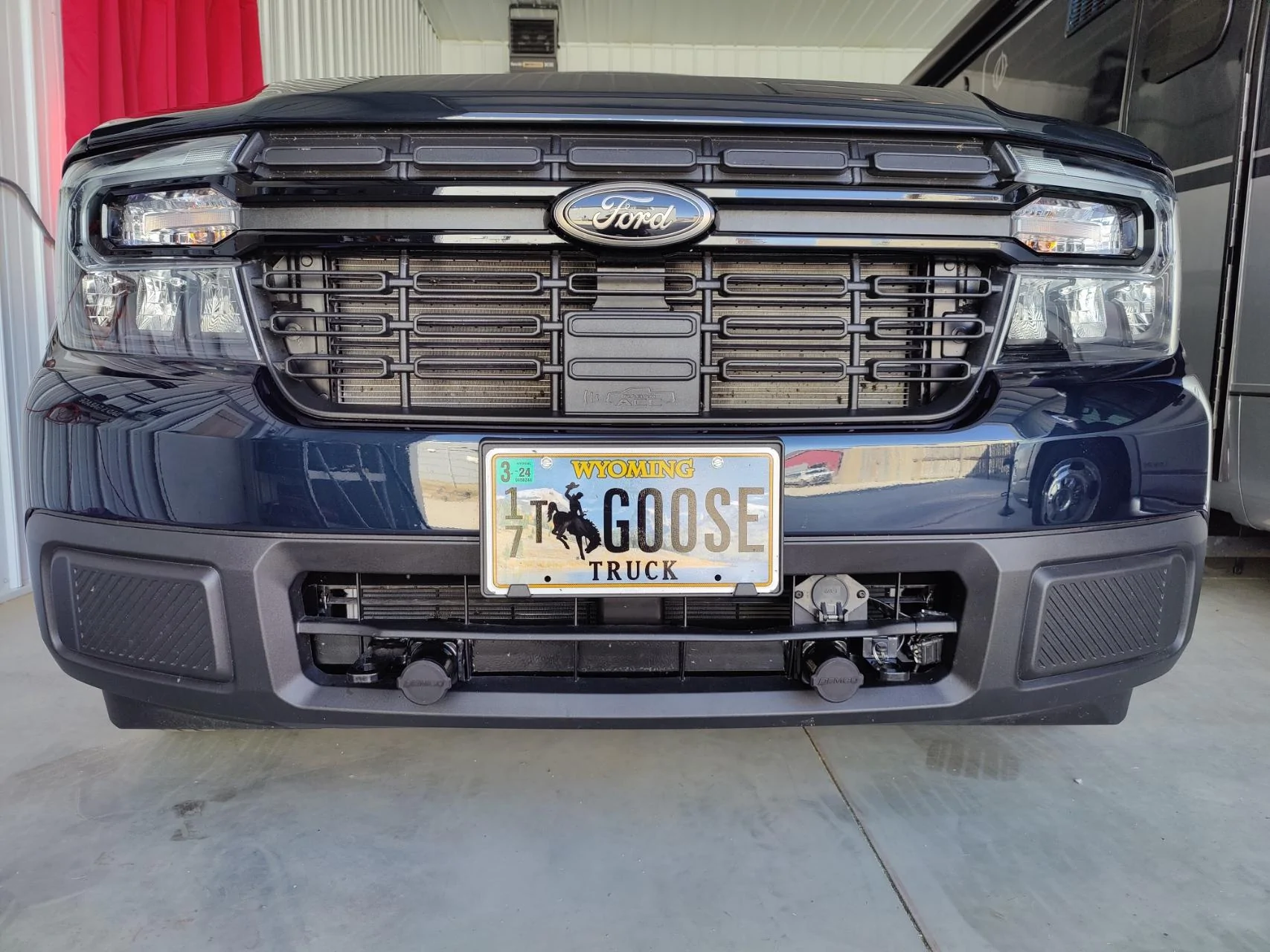

I took my 2023 Maverick on 2622 miles of towing behind my motorhome a few weeks ago, after installing the Demco Baseplate. ZERO issues. No fascia issues (Blue Ox) and no destroyed lower active shutter system (Roadmaster).
I like what Demco did. That wasn't available to us in 2022.
Ford cancelled my 2022 VIN...and I ended up with a 2023 with NAV, the ability to add BAP and could wait for Demco to get it done. I did have to set up my C-Max for towing due to the delays (It's for sale now!)

I had a real struggle initially with the Demco plate. They said it was hard for them to get a test vehicle...and then they were so late to the game, they sort of rushed it after one install. The first baseplate they sent me was 3/4" too wide, and had small holes that would not allow for Ford's manufacturing variances. Demco sent me a second baseplate with my specifications and it was perfect. They also enlarged the holes (I think from about 5/16 to about 7/16) and I had no issues with it. It was easier than my C-Max, that's for sure, and I didn't need a prybar and all my strength like on my 2005 MDX. The S-10 install was like bolting on 2 trailer hitches and was super simple., like the Ranger (I set up a 1997 and later a 2001 Ranger).
