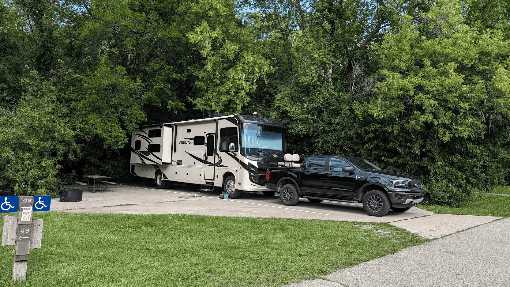

I'm also hoping for a flat-towable hybrid AWD Maverick. The Rangers are heavier than my little Transit 350-HD wants to tow (it likes a 4,000 lb limit). But until then, the trusty 2015 Wrangler gets winter driving duty here.
Our Ranger is exactly 5000 lb with the Golf Cart on it. Just within the limits of our RV.
The LTV (Transit 350-HD) has a GVWR of 11,000 lbs and a GCVWR of 15,000 lbs.
I have borrowed from the coach to tow a 4200 lb vehicle (the hitch is a Ford 7500 lb hitch), but that drops the LTV's capacity that 200 extra down to 1552 lbs. With the 3750 lb or thereabouts of the Maverick, I get my entire 1752 of carrying capacity.
I have to ask you, how did you get the golf cart on the Maverick? I bet it is a little more difficult with the Ranger, because of the bed height.
LOL, that is the part that I get attention with every time I load or unload. Obviously some long ramps. But the trick is the remote control for the golf cart. It's a Cricket Miniature Golf Cart. You can get that thing with a remote control option. Well spent money. I push a button and that thing drives itself up the ramp. The ranger is higher, but so far that has not been an issue.
