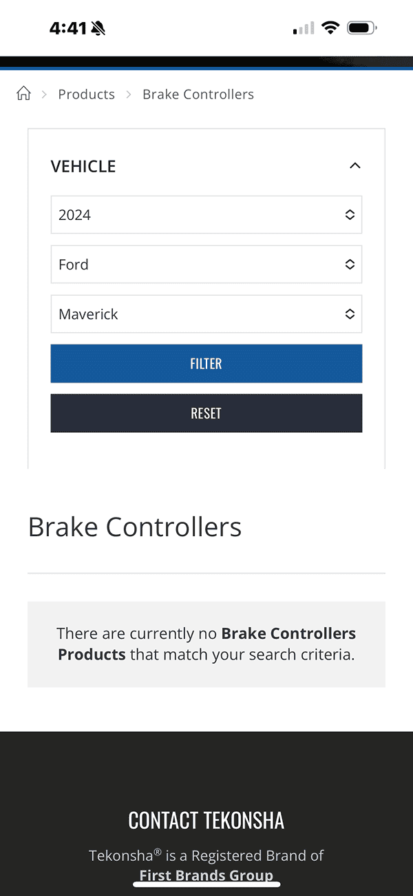

You are wrong. Tekonsha, Reese and Curt all have top rated controllers that their sites say are not compatible with the Hybrid Maverick. UHaul who installed my 7 pin would not install any wired brake controller on my Maverick. Its how I found out about the Curt Bluetooth controller.

We have a 2023 Hybrid Highlander too and Toyota parts doesn't even sell a brake controller for it and will not install one. Its not about wiring. Yes, you can wire any brake controller up, that doesn’t mean it will work the way it is supposed to. Regenerative breaking means you will not be using the breaks as much to slow your vehicle down.. unfortunately the trailer doesn’t have regenerative breaking. Its not just the brake light wiring that operates the controller. There is a reason Reese and Tekonsha sites say no model found for a 2024 Ford Maverick Hybrid. I’m sure Reese, Tekonsha and Curt would love to sell their wired products to Mavericks owners. They aren’t stupid.
Go to their sites and check for compatibility. The fact that UHaul refused to install a Tekonsha P3, which they sell and had in stock, on my Maverick because Tekonsha said it wasn’t compatible was more than enough reason to get a Curt Bluetooth which I ordered from Amazon after the Curt site said it was compatible.
These brake controllers are not all that complicated and use two main inputs to engage the electric trailer brake output : 1) the brake light trigger switch wire and 2) the physical deceleration of the vehicle, as measured by a sensor inside the brake controller unit. Then there are some sensitivity settings and gain settings to play with to make it work to the driver's liking.
The brake controller truly doesn't care whether there is regenerative braking or whether physical brakes are used. It will work equally well on an ICE drive line, with either automatic or manual transmission, or a hybrid, or a BEV.
When the brake light comes on, the unit activates, and the measured deceleration, together with the chosen gain settings will determine the electric trailer brake output.
That's it. There's not that much to it really.
That Curt Bluetooth unit you are using works basically the same, it just doesn't have a wired manual control (uses your phone), and it grabs the power from the constant +12V pin you have in the 7-pin trailer connector, and the brake light trigger wire is in that connector too of course. It is actually quite a convenient solution if you don't mind using your phone for yet another thing.
Either way: the fact that someone doesn't want to install a conventional hardwired brake controller on your Hybrid doesn't mean that it won't work correctly. In regard to Hybrids there's still a lot of misinformation out there. I think we can all agree on that.
I can tell you it works absolutely fine on both our Maverick Hybrid and Highlander Hybrid.
