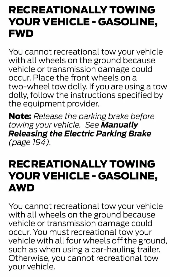

We just returned from our first camping trip with our Hybrid Maverick in tow.
We towed it on our dolly with the truck turned off, e-brake turned off, not in tow mode.
When I got into the truck for the first time, I was greeted with a barrage of error messages. Anything from E-Brake fault over antilock brake fault to pre-collision assist not available. ABS light is on too.
After driving a few yards everything resets and the truck acts normal again.
Anyone here that might have an idea what is going on?
Front wheels on dolly. Earlier thread goes over the screens you are seeing. Screens apparently are related to anti theft tilt sensor detection. Some probably related to not being in tow mode. Computer appears to not be programmed for Dolly tow.
