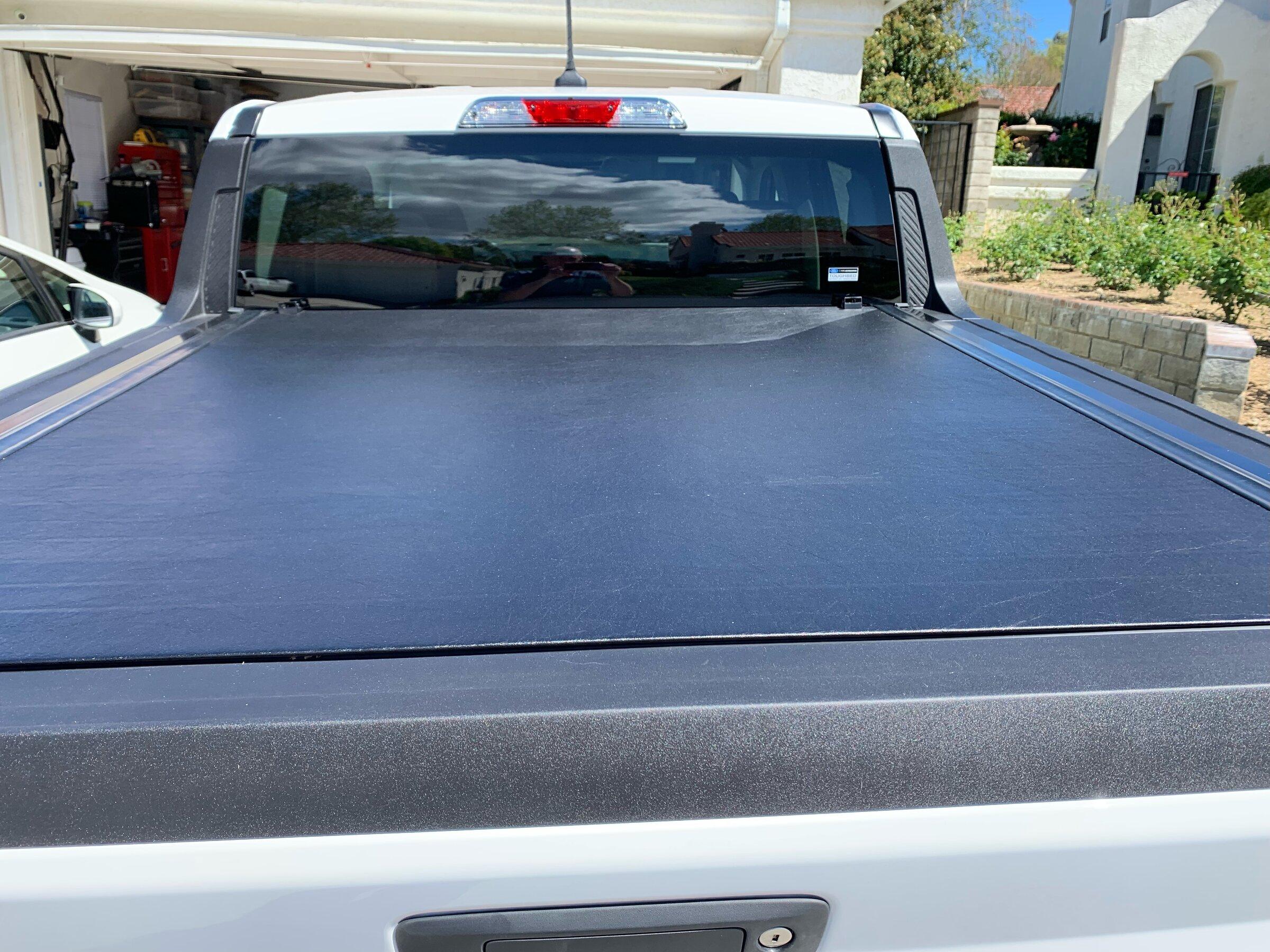

The factory tonneau is the same as the BAK X4S, so you might want to check the fitment of the rear of the cover and the tailgate. It is possible to "set" the tonneau cover too far forward and there's a sizeable gap between the rear of the tonneau cover and the tailgate. A simple fix could be just to adjust the position of the tonneau cover towards the rear of the vehicle a few millimeters. Check this video from RealTruck on tips on how to better weatherproof the rollup cover.
Thanks I will check this out and see if I can improve it. Although for as much as I paid for this cover I honestly shouldn't have to spend any time or money on it.

so i watched a video on these covers and chances are ford followed the directions in installing, in the directions it says to install the cover so that it comes close to the back window but in the video the guy said you should actually move it back a half inch or so until it seals properly on the bed because its a little too short for the bed, after he did that he had minimal water and you can very easily do it yourself. probably will take less than 20 mins

Shortly after I bought my Maverick I was at a local truck accessory dealer and asked him for his opinion on the cover I bought as part of my truck. I was having the same leaking issue.
He took a look and said it just needed to be adjusted. If you look at the mounting points for the cover closest to the cab, you'll see there are slots to be able to adjust the cover forward and back. My assumption is the installer at the factory (or the dealer) didn't want to hear complaints about the tailgate being tough to close because of the tight fit to the cover, so they install them a hair forward at the expense of a leak at the tailgate.
Give it a shot- it doesn't take long and may help.
As a side note, I also inquired about replacement weather stripping for the top of the cover, where it meets the side rails (I think mine was cut too short on the rear and there's too much overhang on the front. I was told it's not available from the manufacturer, so that's a bummer.
Yes. I thought of that. And I also thought the installer didn’t want to hear complaints of it being too tight. 👍
