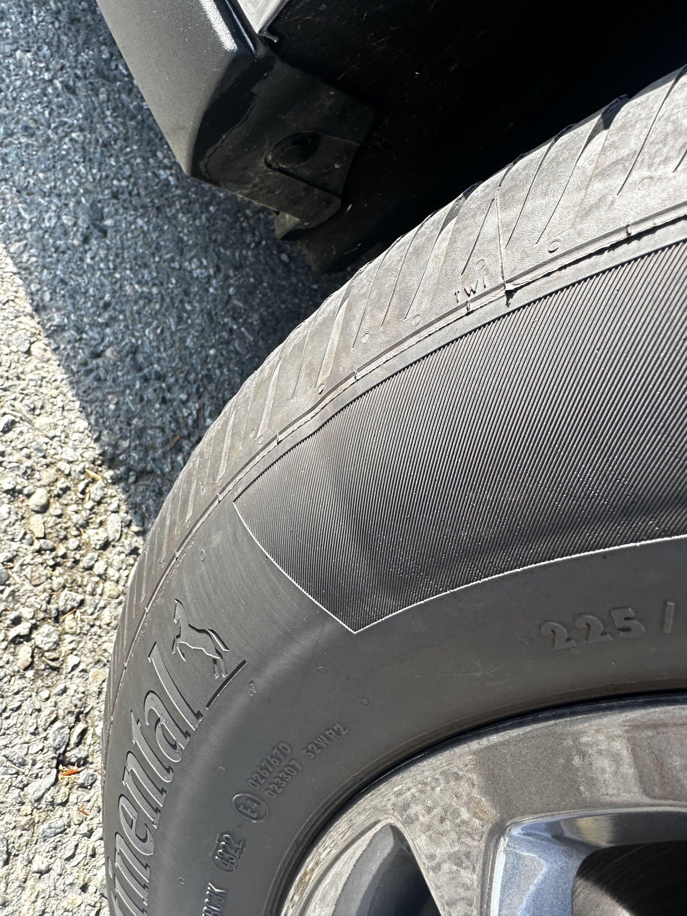

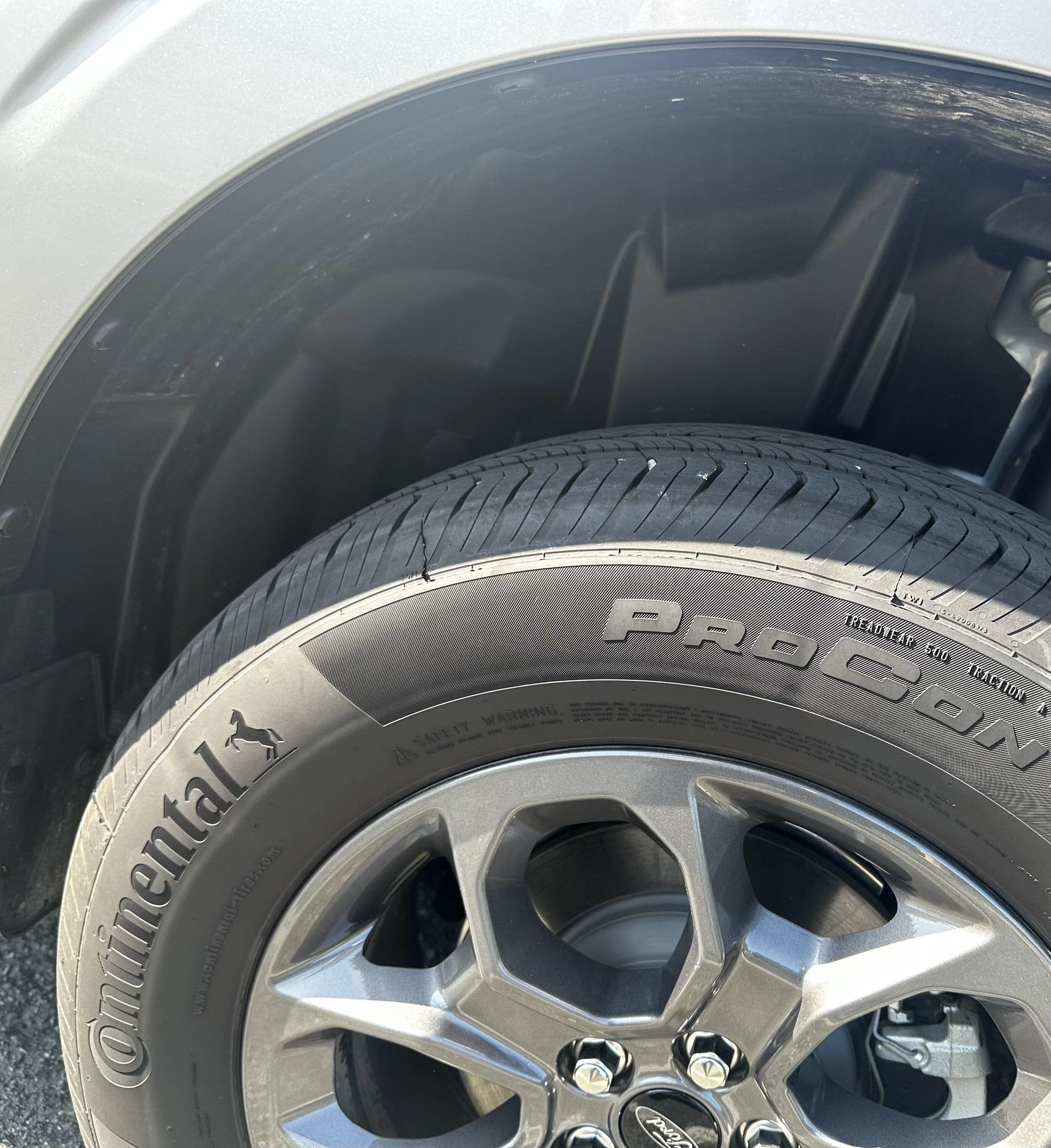

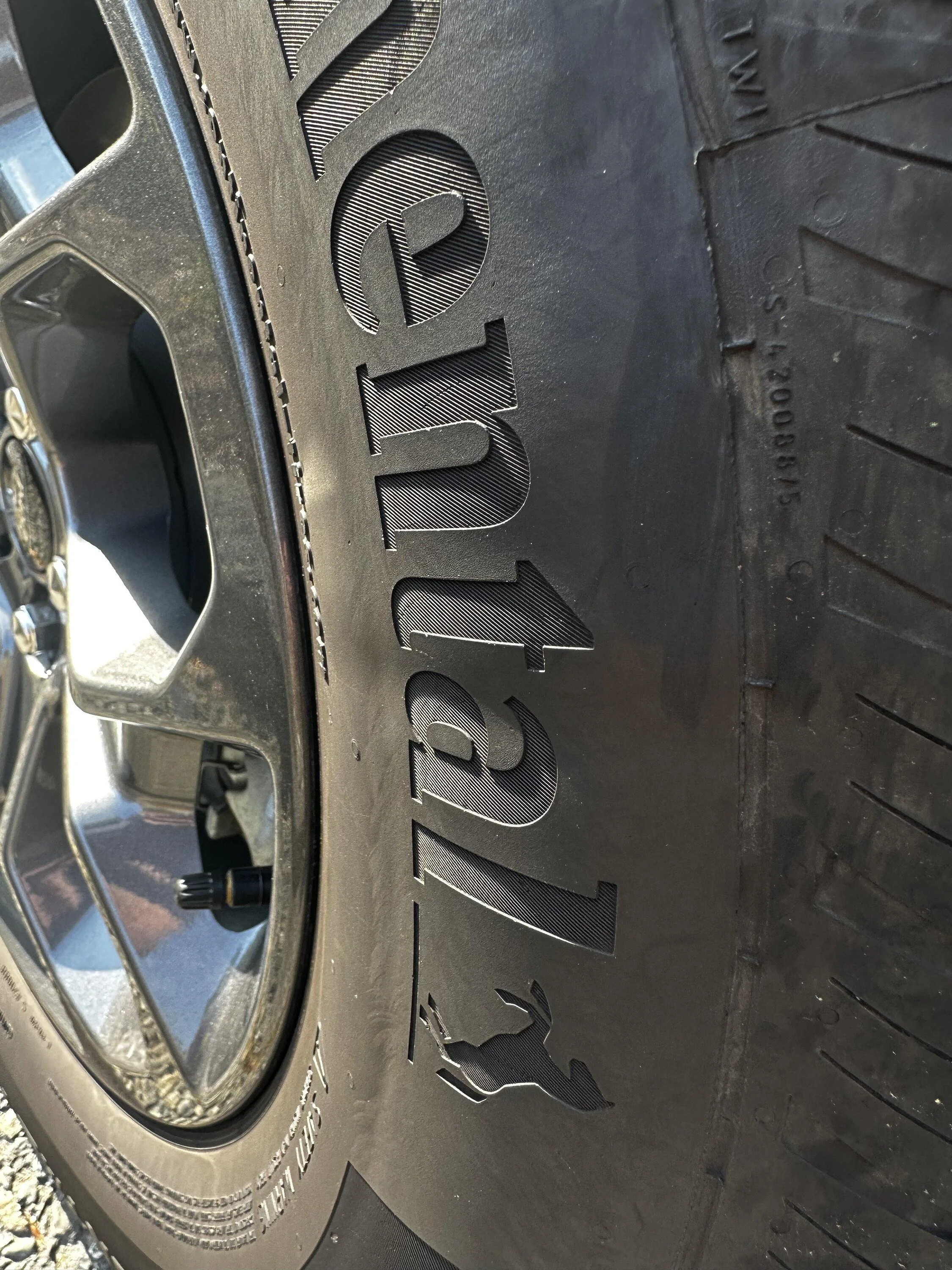

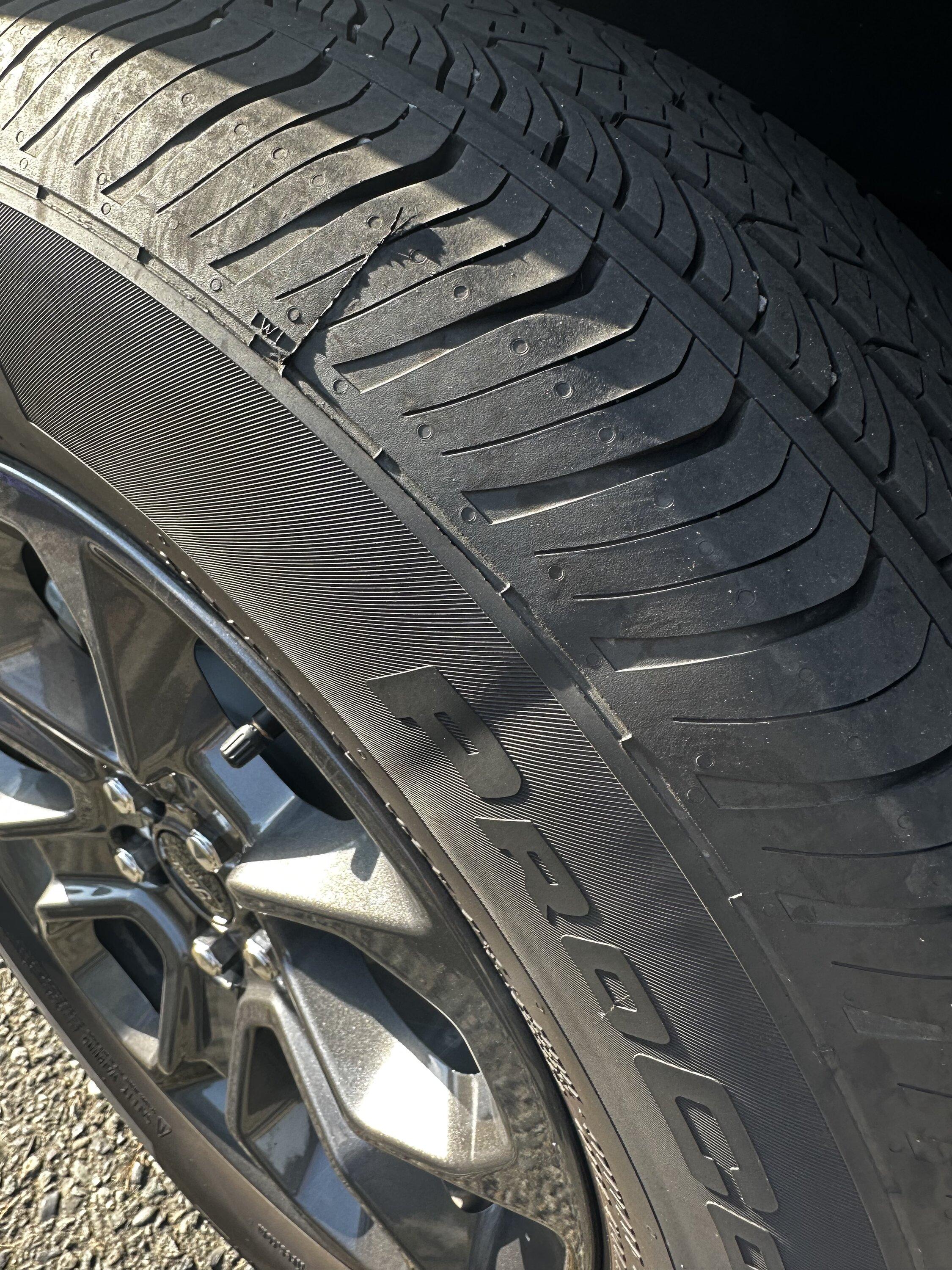

I stopped by my local Ford Dealer. I noticed some significant warping on all four tires. The manager alleged, that due my driving it was my fault.
the evidence is sustained from the manager interpretation of the cause. There were no calibrated tools or measurements taken. Just some photos with an iPhone. It’s been three business days, and no response yet.
anyone else seen this before?
I'm a former tire engineer. As stated in other posts, you have nothing to be concerned about. The area you refer to as warped in your pictures is actually where there is an overlap
I am a former tire engineer. The condition is actually where the radial ply overlaps. Contrary to what appears as a defect, is actually the strongest portion of the sidewall. Your dealer needs to educate themselves about tires. Shocked that they blamed you. SMH.

Sorry I'm late to the conversation. I know your question has been answered, but radial indentations are prevalent in the vast majority of radial tires. Some are just more noticeable than others. Completely normal condition. That being said, if the indentation is severe, it can be adjusted by the manufacturer on a prorated basis, but not many folks are gonna go through that hassle.
Sorry, I have to disagree. I worked in a tire plant too, in QC. Assuming that these indentations are not due to broken tread plies, it is where the tire was mis-built to incorrectly overlap the plies, that means that while yes, they are technically stronger in this small area, but they also run hotter and cause the tread in that part of the tire to squirm when it shouldn't, leading to premature failure. If you designed or built tires like that, I'm glad I do not use them.

@T-Dog is correct. Tires are built up in layers on a cylindrical form. The indentation is caused by a too heavy splice of the carcass layer, thus it is stronger, and on inflation is more constrained. There should be no more than one sidewall indentation (at the same place on both sides) per carcass ply.
However, IT IS a cosmetic defect, and at this degree should be sold as a blem. The tolerance for the amount of deflection before being blemed or scrapped varies among manufacturers. You can go thru a parking lot and get an idea of which brands have better manufacturing control.
You should go to the tire dealer for this kind of problem, use the car dealer as a last resort ( they barely know anything about cars, and almost nothing about tires).
