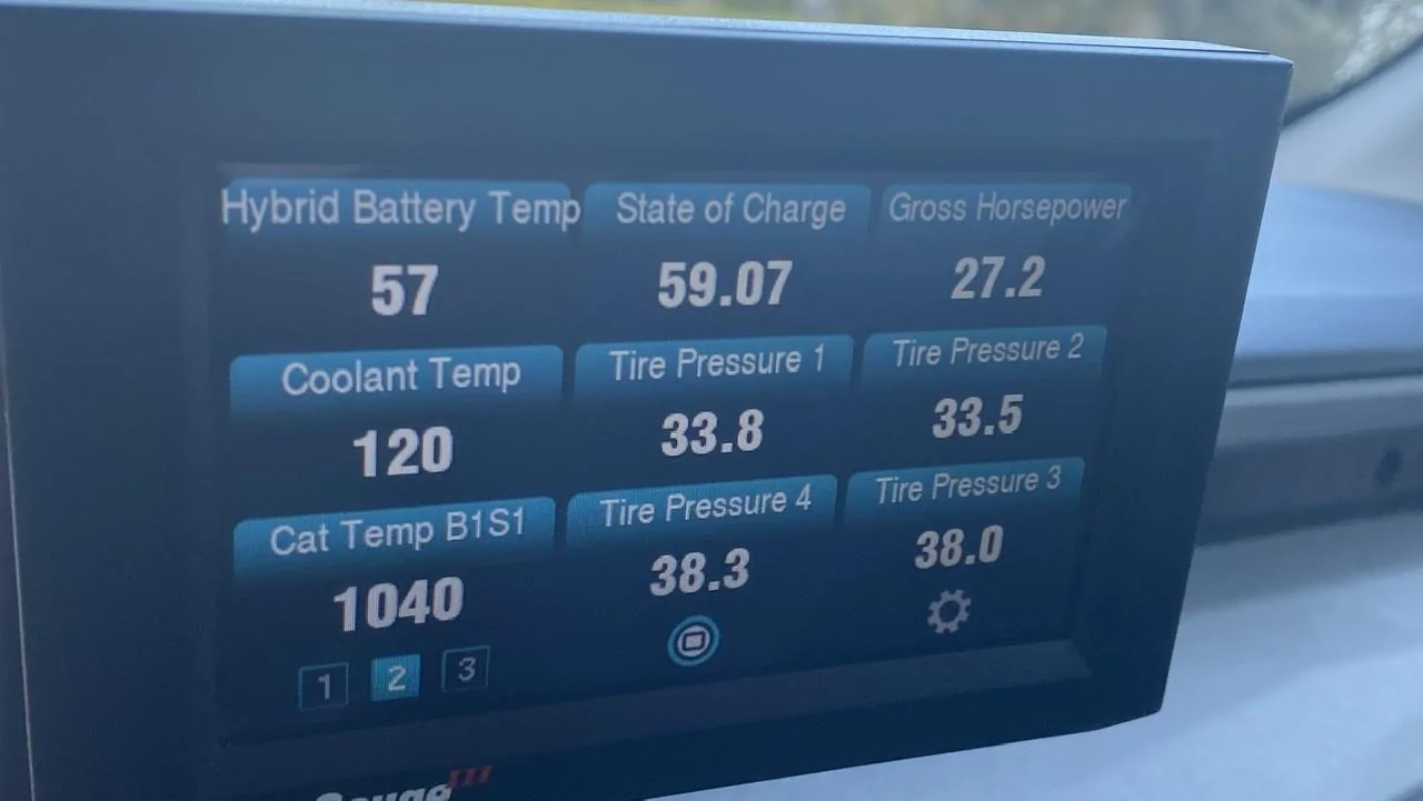

The mature adults may find this interesting. Even the XLT and I predict XL can have real-time TPMS Pressure sensor readouts with after market OBDII readers. So Ford just "chose" not to give it to you because you didn't pay for Lariat. (There's a lot of things like
this.)
Tire 1 is LF
Tire 2 is RF
Tire 3 is RR
Tire 4 is LR
I have them at 35 psi fronts, 40 psi rears because A) I carry loads of 500 lbs and B) I have FWD and so all motive power is from the front. C) I want a tad better MPG
Pressures set at 55°F which is a good average temperature for San Francisco Bay Area. This was an exceptionally cold morning. Some of you can figure out the ambient based just off the info I've given. 😁
They will be back to "baseline" shortly after the photo was taken as things warm up quickly around here.
Ford Maverick Tire Pressure is suppose to be... F3EE1917-ED11-44E6-A37B-E1689E36AB95
Of worthy note: the manual(s) say "Do not use TPMS for inflating tires. The sensors may take up to 20 minutes to update." They usually update quickly for me, but that's the precautionary statement in the manual. And even an update once per minute is obviously too slow. They are "realtime" but not exactly "live"...
