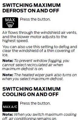

Ford Maverick Theory on heater and mpg Screenshot 2025-02-14 144104
SWITCHING MAXIMUM
DEFROST ON AND OFF
Press the button.
Air flows through the windshield air vents,
and the blower motor adjusts to the
highest speed.
You can also use this setting to defog and
clear the windshield of a thin covering of
ice.
Note: To prevent window fogging, you
cannot select recirculated air when
maximum defrost is on.
Note: The heated wiper park also turns on
when you select maximum defrost.
Ford Maverick Theory on heater and mpg Screenshot 2025-02-14 142802
There is a difference between "defrost" and "defog". You do not "defrost" the outside of the glass with cold air. You must use hot air which is simply a matter of changing the "flow" of the air.
