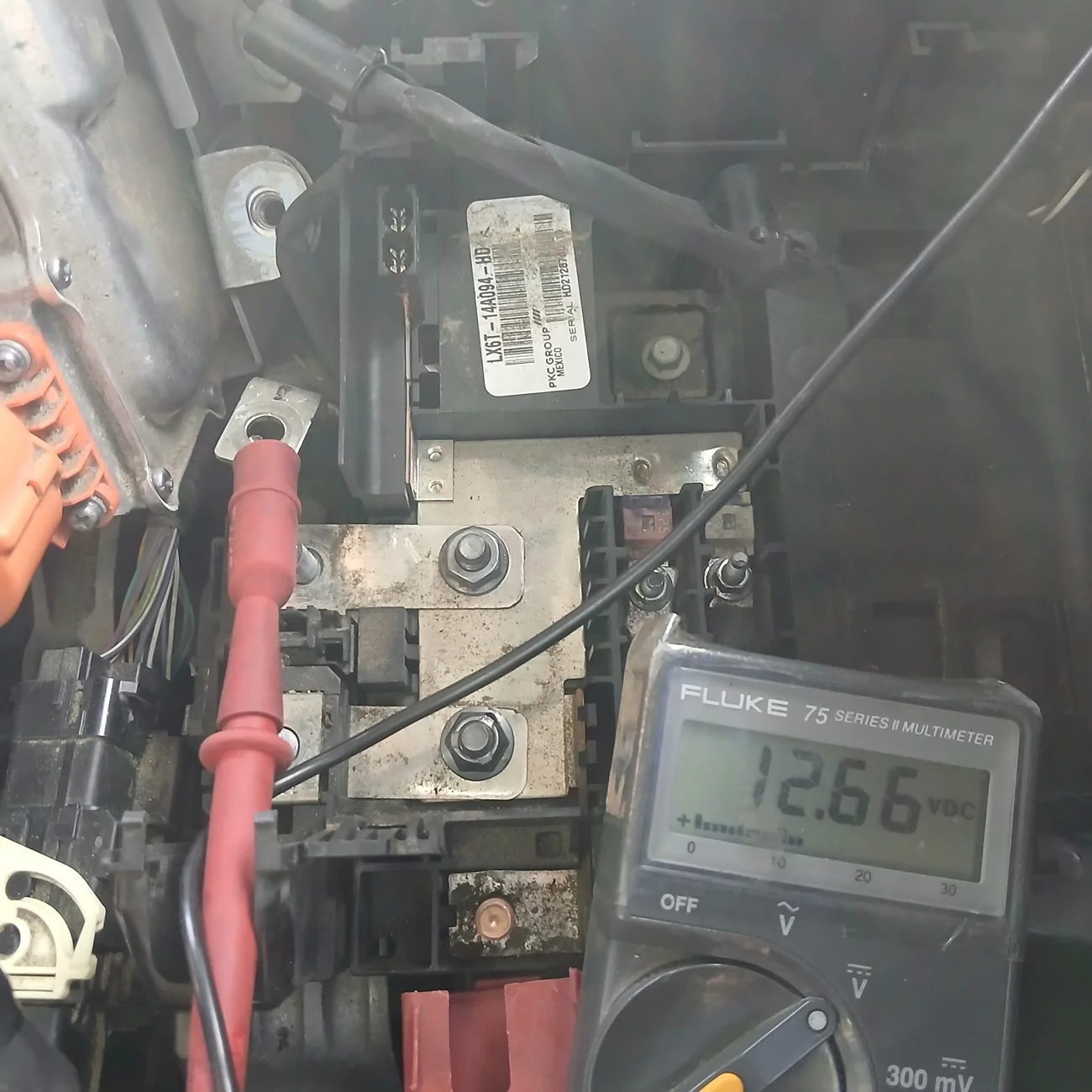

SA said they removed my battery from the Mav when they tested it.
When I was troubleshooting it, I was getting battery voltage under the hood with the cable not connected to the BJB bus bar, or even when the cable is connected but the two big connectors to the BJB box are unplugged. Voltage drops to 3.X V as soon as either one of the big connectors is plugged in to the BJB box

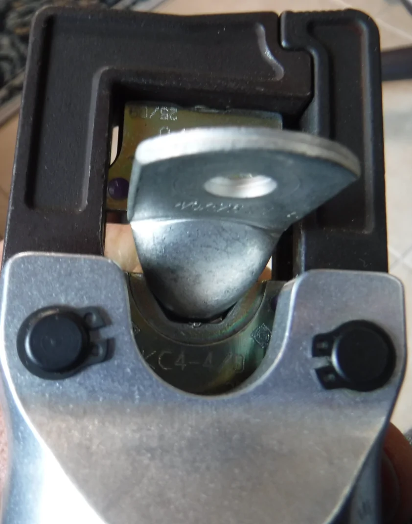

Ran across tin plated aluminum compression lugs at Home Depot while looking at what Panduit, Burndy, Ilsco have.
Noalox compound is recommended on aluminum to aluminum connections, crimps.
Some AL lugs come with it preinstalled.
Aluminum 1-Hole Straight Short Barrel Compression Lug for #2/0 Stranded Wire, Olive
Aluminum 1-Hole Straight Short Barrel Compression Lug for 4/0 Stranded Wire in White
I've no experience crimping aluminum lugs, only copper:
Ford Maverick The Dreaded Dead Hybrid 1756677866140-d
