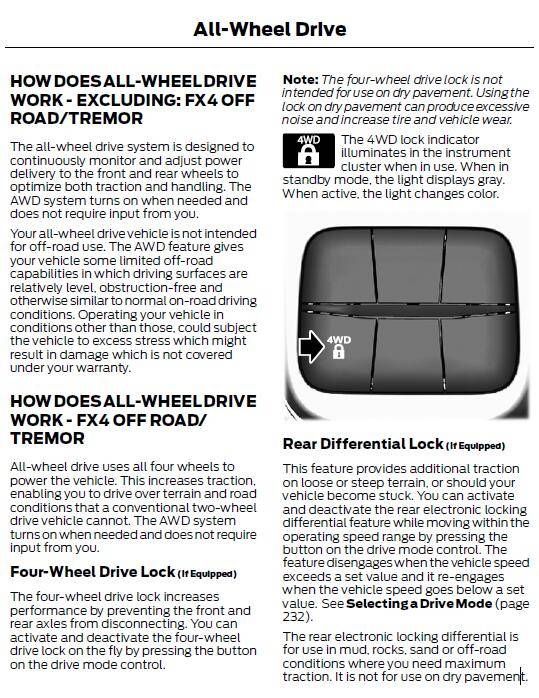

I think it's likely the Maverick system is tuned differently. The hybrid is going to have some prioritization for fuel economy, and the system is going to take into account the fact that it's a truck and needs to send traction to the rear during weight transfer. I think "off road" performance was a distant third. That's not to say I'm happy about the result, as I think Ford can do better.
does the Lariat have a 4WD-Lock mode?
I believe only the Tremor has that and I'm certain it's because it has a liquid cooled PTU. (pics of it over here)
but I do recall reading (or seeing a video) at Lobo launch that it has a liquid cooled PTU also.
interestingly, I decided to peruse the 2025 owner's manual and saw this.

So FX4/Tremor get a lock feature. How nice for them. I guess I get why, it's an "off road" feature.
The rear differential lock part has me curious though...so there's a button to essentially lock the rear wheels together and close the diff, at least electronically?
that's also a lobo/tremor thing. they have a completely different RDU which was derived from the Focus RS. it is pretty crazy how it works, it's actually locked by default and it uses clutches to allow wheelspeed differences. I believe it has cooling fins and some Focus RS owners who drove on road courses reported issues overheating. but since it's locked by default, it actually would make sense that it would work great offroad. it needs to allow slip when turning, in fact it does this dynamically to assist in turning, but otherwise being locked is a great thing.
here's a video from 2017 about the Focus RS unit.

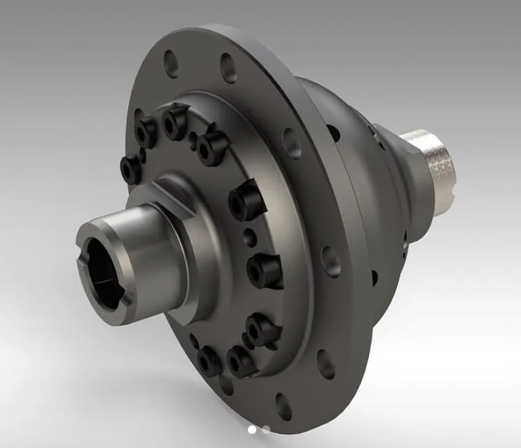

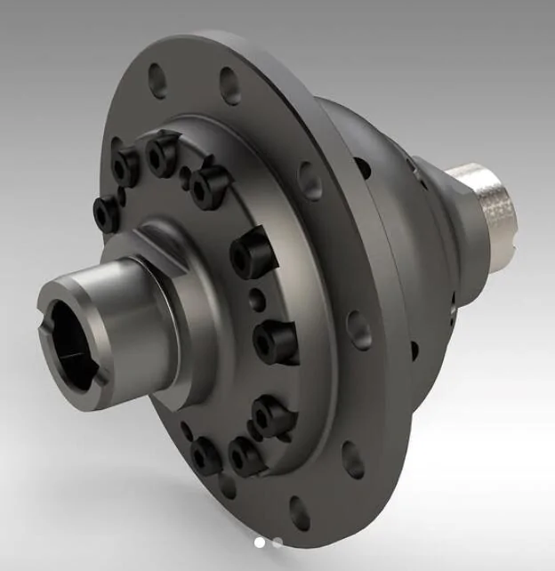

Quaife
https://www.quaife.co.uk/
Ford Maverick TFL Slip Test on 2025 Maverick Hybrid AWD 1736529704474-jg
Focus RS
- 3 sets of tyres "used up" ... all track, rain to Thunderhill & Button Willow HEAT ... never any RDU issues (change the damn trans, PDU, RDU oil, dudes) ... . W/Quaife ... front torque steer virtually eliminated. Cannot drive to "full potential" on public roads. Electronically limited to 150 mph. Hairpin traction ... torque vectoring ... beyond belief. Kiddies, wear diapers.
AWD ... must work for
THINK ... slippery (hard) surface ... slope, off-camber. NOT rocks and NO "trail" ... .
and TOW
at least 4,000 pounds (i.e., the payload).
Right now, only the Ridgeline ... does that ... albeit at a higher price.
- Ecoboost AWD ... $1,x00 optional Quaife (goes in front) ... gets off the "rollers"
- Hybrid AWD ... can a Quaife be added to the eCVT output diff section ??
- $1,x00 option.
Yet, software tuning, using brake-bias torque vectoring ... on both front and rear axles ... as appears Subaru does ... via a "drive mode" ... Slippery/Snow.

The 2L ecoboots and trans ... are from the Focus ST and RS (PTU), so yes, a Quaife is available.
AS an OEM ... very "inexpensive" to add ... if even as an optional cost option.
A front LSD ... on the TFL "roller slip test" would make all the difference in the world.
Ford Maverick TFL Slip Test on 2025 Maverick Hybrid AWD 1736530330038-3h
Will "someone" at FORD ... realize this ... and offer this as a 2026 option ?
- too late to add for 2025 Job3 .... if already designed and verified.
Just think ... if added for 2026 ... as an option ... all the "dudes" (almost always dudes, yeah?) will dump their 22-25 Mavericks and BUY the 2026. More profits, and free-up Mavericks for those "who only buy used" ... which makes the merry-go-round of the automotive industry work.
AWD, 4k towing, hybrid. NO getting "stuck" on pavement.
