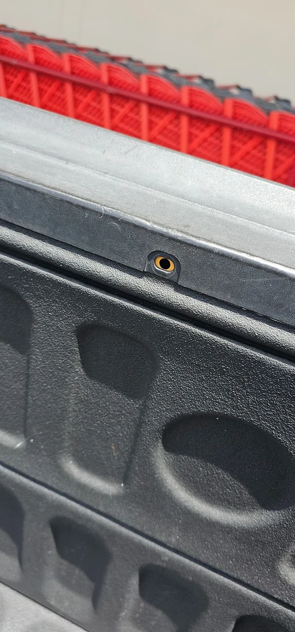

Ford Maverick Tailgate trim plastic rivets PXL_20260401_221403904
+1 for the rivets recommended by @jfgesquire. Perfect fit and they look like parts Ford should have used in the first place. If I wasn't so lazy I'd just replace them all before they fail, but by the way the OEM parts look that won't be too long! Here is the broken part I found in my driveway
