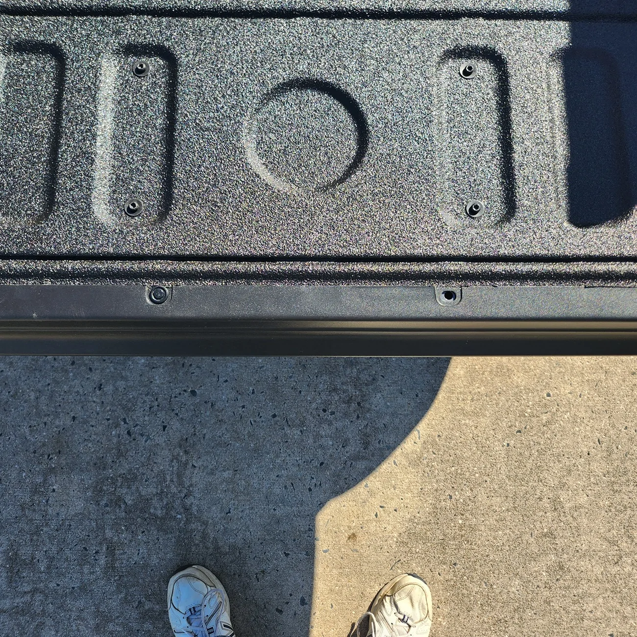

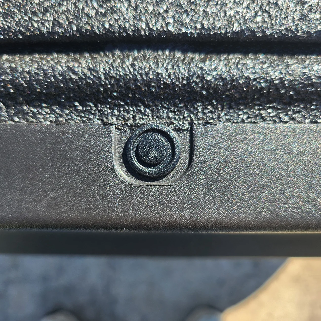

I'm looking for these rivets. I talked to ford parts and was advised that the part is back ordered so far out that there wasn't even a potential delivery date this first pic includes the plastic rivet and the second is just for perspective or fitment

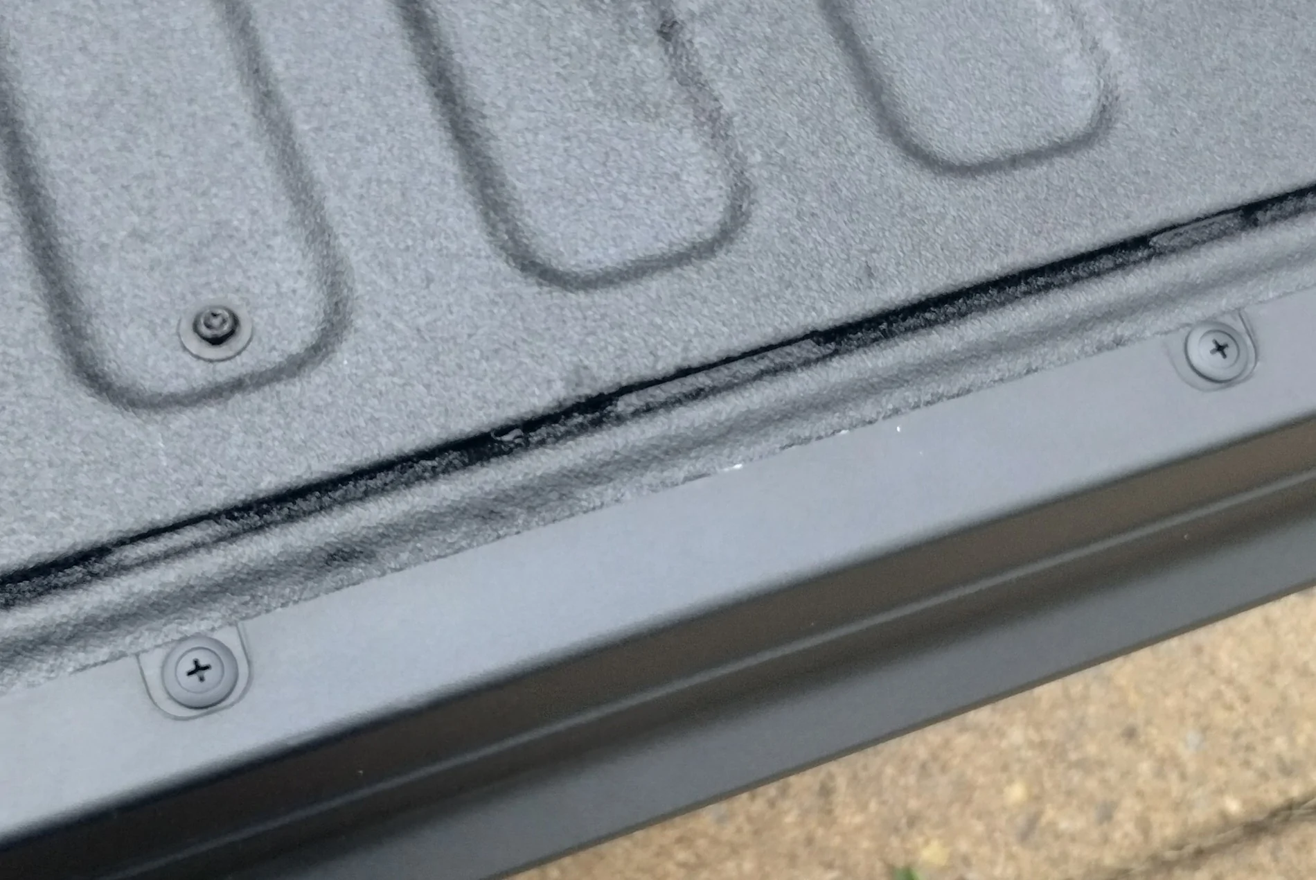

I had the same issue. I just replaced all of them for a uniform look. This is my July 8, 2025 post from a Maverick Facebook group:
"Last week I asked about OEM replacements for the push type plastic rivets for the tailgate top trim. I got what I thought were some pretty snarky comments. Putting mismatched parts that don't fit may be ok for some of you but not for me.
Besides, getting an assorted box of push type rivets as some suggested would have likely been a waste of money. The OEM rivets are for a 7mm hole with a head diameter of no more than 15mm. Most assorted packs don't have that size.
The OEM rivets are a single use rivet and once pushed in the only way to get them out is to break them.
I found these 15mm/7mm push type rivets with the Phillips-looking head on Amazon and they do a great, OEM looking, job.
https://a.co/d/cQP9HCm "

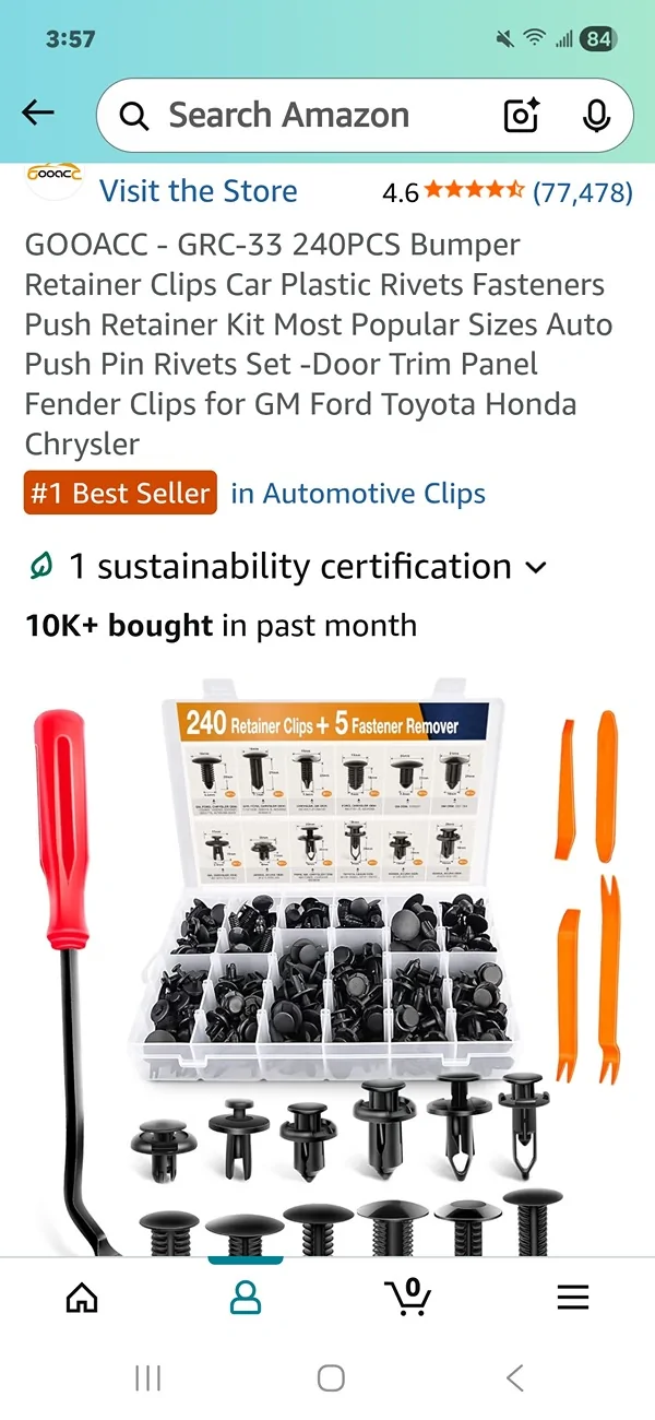

A bag of "generic"

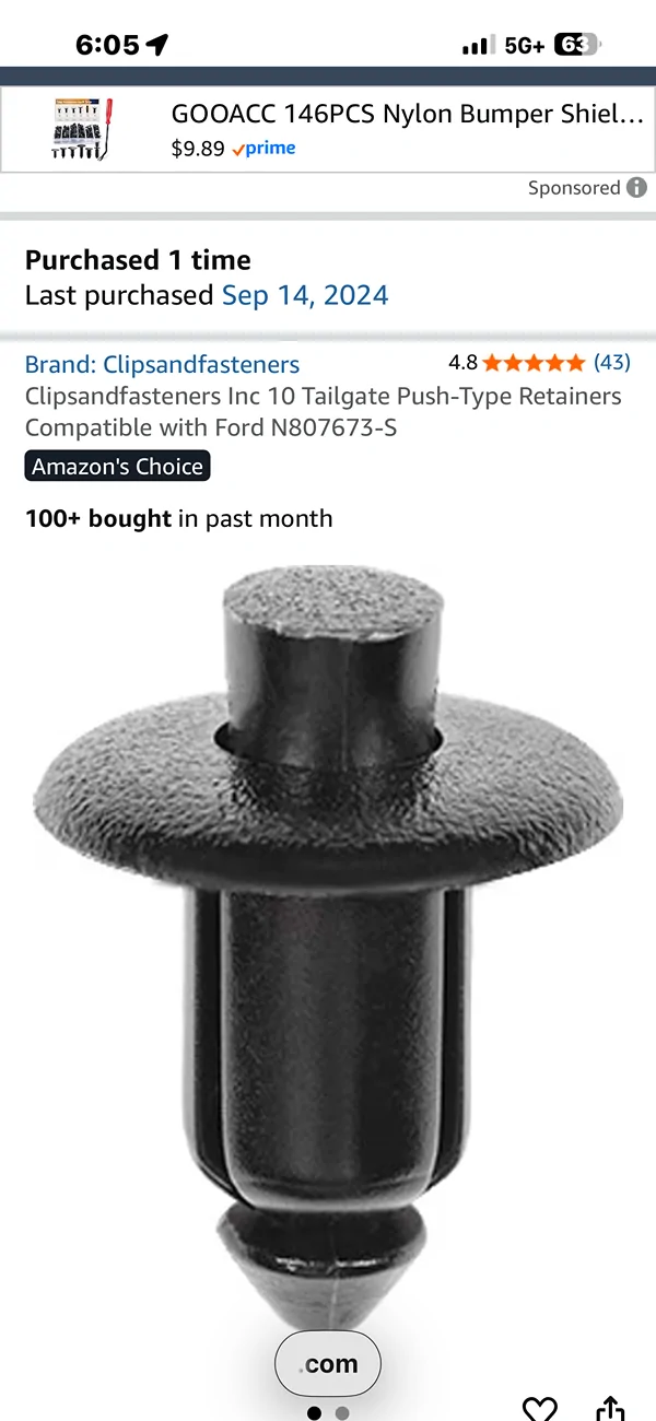

Here is the matching rivets
https://a.co/d/bhIjIke
Whenever I looked at the rivet sizes in the assorted pack none of them were the right diameters.

Those are not assorted sizes. That is the rivet you need. There are 10 of these in a bog. I had to replace one as I broke it. They are reusable. Just push the pin and it will pop down and it comes right out. Once out, push the pin back out and re insert into hole and push pin flush
