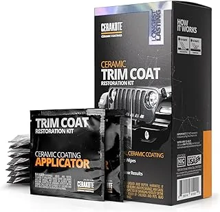

Armor All doesn't last long but better than nothing. If you don't mind spraying and wiping down all the black plastic with it after every couple washes it's fine. Yes, those are the wipes I used. You have to clean it with strong detergent first and make sure it's completely dry. Then it takes a while to get it on nice and even everywhere but once done you can forget about it for at least 2 years afterward. FWIW - one guy on the Promaster van forum said his still looked 'almost' new after 5 years.

I washed all the plastic down with Dawn dish soap, super rinsed, then let it dry fully. Afterward the Cerakote application went very well.

That doesn’t sound too bad, these plastic surfaces aren’t too vast. I might be doing this in the near future, thanks for breaking down the application process!

So I finally managed to get my Mabett mud flaps on, they're really nice, however before I managed to do that I got the plastic trim behind my wheels stained from road debris, thanks to Pen-Dot having to resurface roads/place grave during the busiest times of the year... Anyway, I cleaned the area with a shammy cloth, soap and water, it removed most of the stains but I can still see some of it on the plastic. I was wondering if anyone has a technique or product that can deal with this to save me a trip to a detailer? See photo below, thanks.
Cerakote Black Trim Restorer.
