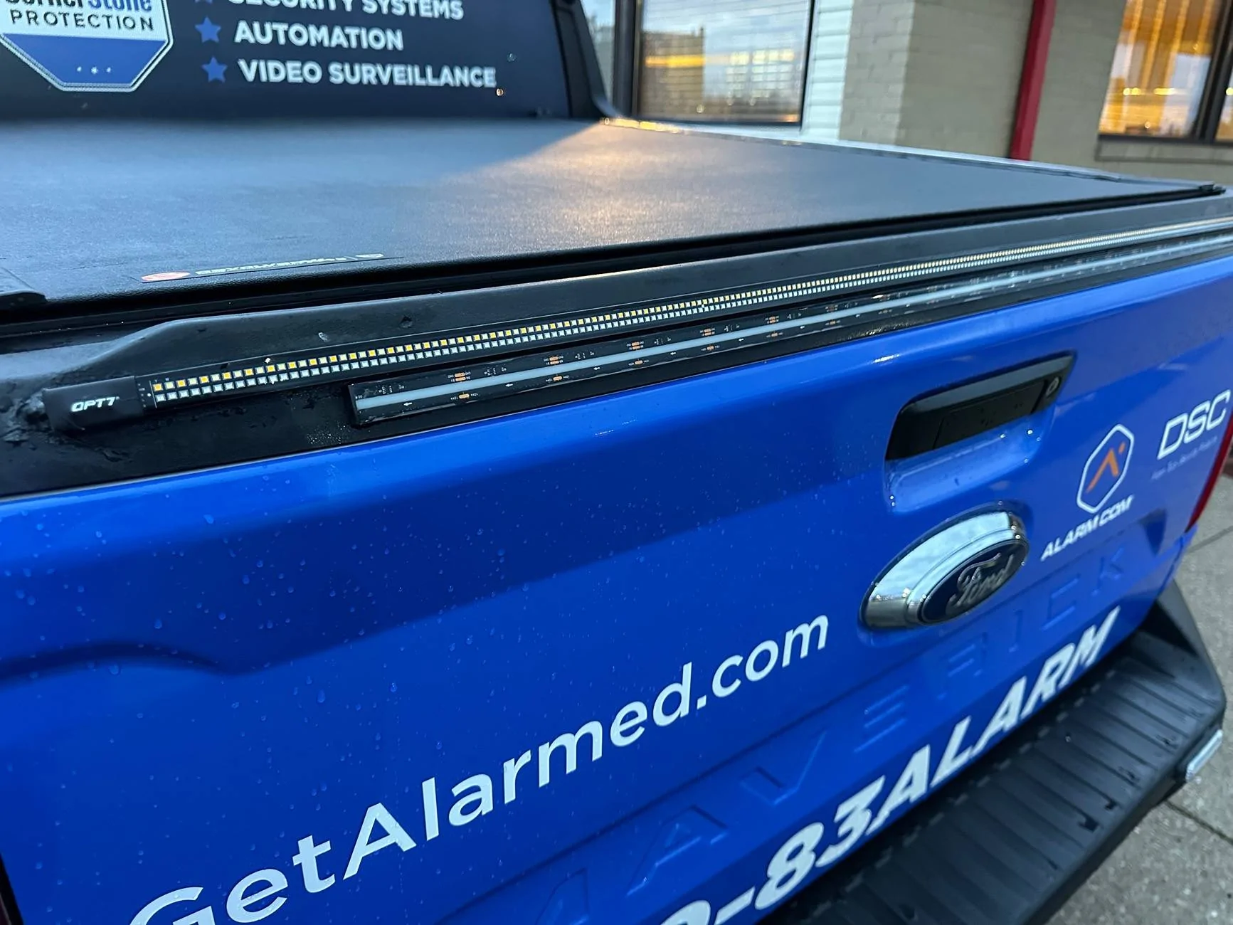

I went with the OPT-7 dual row . It does the animation on start up. Did wire it direct to the tail lights. It is sealed in epoxy and aluminum Chanel which can be bent as seen in my truck. The bottom LED that is chasing is a different bar. The OPT-7 is on top
I like it definitely fits your business for sure thanks for sharing - everything I’ve research has me sold on the OPT-7

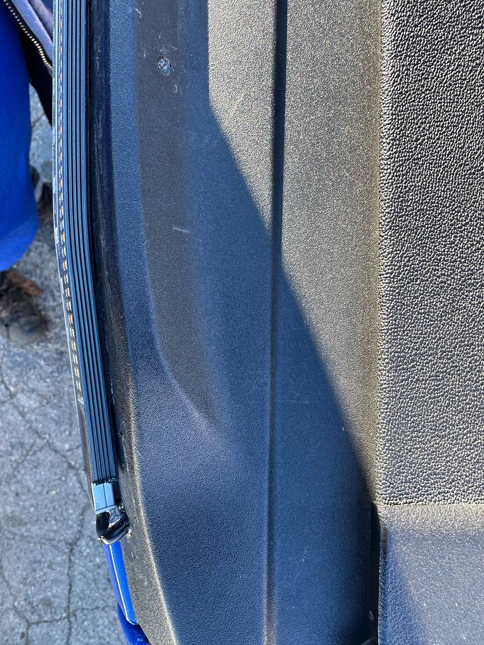

Anything from OPT-7 that’s labeled PARALUX means it’s 2 pieces , just fyi. This one is not
https://a.co/d/2PpfGJY
I bent it to fit the curve on the top of the tailgate

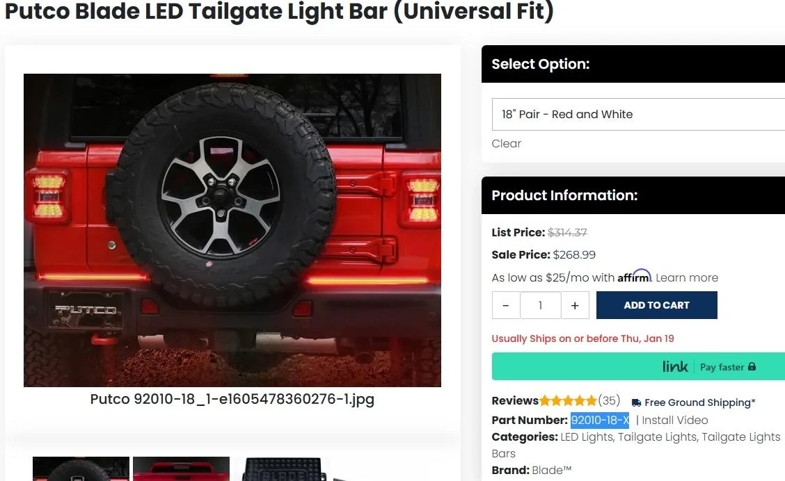

Quick update with one part number correction:
The installation of the tailgate light bar and Curt T-harness is scheduled for Monday morning at the shop I used to own. There will be pictures taken.
The first step will be to install the T-connector and leave the 4-pin loose so we can effectively bench test the light bar before doing any further installation work. If it tests successfully, we'll finish the installation and hardwire the harness and light bar together, eliminating the 4-pin connectors to protect against corrosion.
The correct part number for the Putco Red Blade split bar is 9201018-04.
I just called Putco and they confirmed that they DO NOT OFFER a LED lightbar package which will work on a 2024 Ford Maverick XLT Lariat with Blind Spot Detection!
If I remember correctly, 2024 is basically the same as 2022-23, with 2025 being the refresh. So, regardless of what Putco said, there are a bunch of folks here doing exactly what Putco said they can't do.
I suspect a miscommunication in some form or fashion. Putco may not have a plug & play package, but many of us used the Curt taillight T-harness to get to the same place.
So PUTCO may not have a "lightbar package", but they definitely have a lightbar that works on the Maverick Lariat ( Putco 19+ Ram1500 & Jeep W 18" X2(Pair) Led,92009-18 ) when paired with the Curt Manufacturing 56477 adapter cable. See my entire post with pictures.
Putco 18" X2(Pair) Led,92009-18/Curt Manufacturing 56477 Taillight Installation | MaverickTruckClub - 2022+ Ford Maverick Pickup Forum, News, Owners, Discussions
Unfortunately, too many people won't invest the $65 in the Curt solution, to make their $20 light bar work,,,,,
